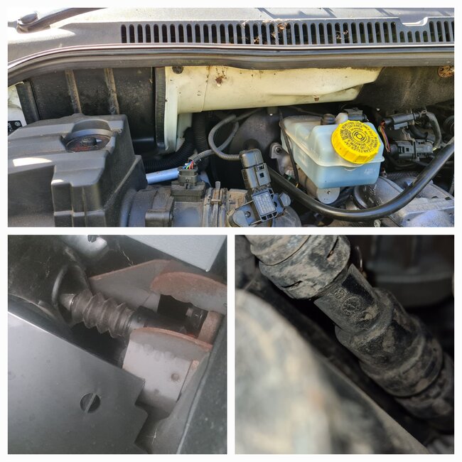

The attached image shows the reservoir, master cylinder (at the top of the clutch pedal) and the slave cylinder (from below).

As my colleague wrote I would advise to inspect the clutch slave cylinder.
This is the only part which could cause fluid leak at the bell housing.
As it is external this part is easily replaced.
To check brake fluid level please see image below

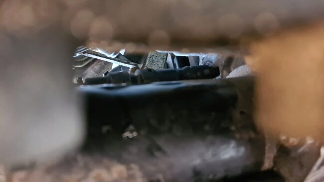

Slave Cylinder - How It Attaches to Bellhousing.
I removed a big air pipe so I could better see the starter motor and slave cylinder. I could see no obvious signs of leaks externally. I could not see any bolts attaching it to the bellhousing, so I'm not sure how it should be removed to check the inside. I did give it a bit of a wiggle and there seems a couple of mm of play in it.
How should I remove the slave cylinder, if there are no bolts attaching it to the bellhousing?

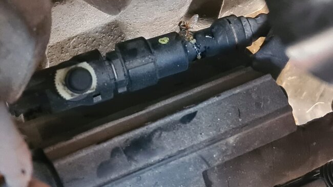

MRPAULHARRIS
  • 17 POSTS
Slave Cylinder - Condition Further Up The Pipe.
It appears to have a bee on it, and a couple of clips and a bleed valve. No obvious leaks.

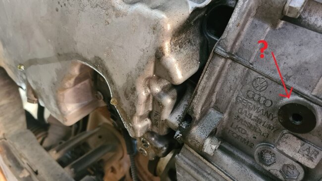

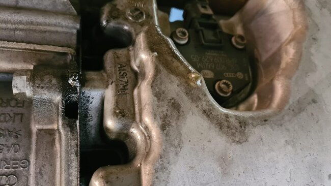

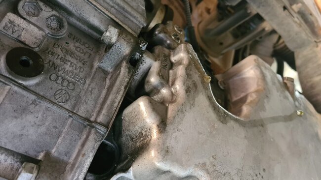

Leaks Under The Clutch - Still Leaking Two Weeks After Clutch Failure
There appears to be a bolt missing, with some wetness around it (first image, left hand side). What would normally bolt into there?
There is what looks to be brake fluid coloured droplets still leaking 2 weeks after clutch pedal was found flat on the floor.
Do these images / video give any hint as to where the leak is coming from?

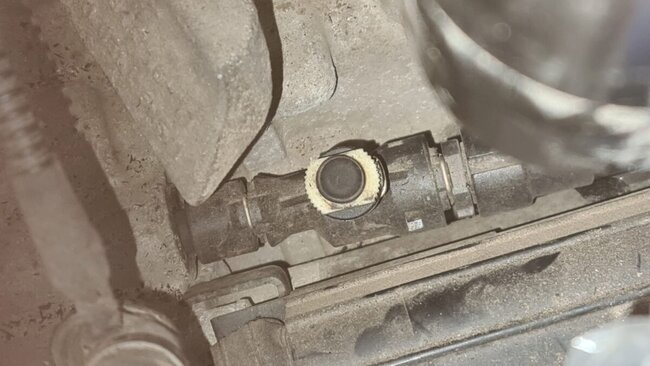

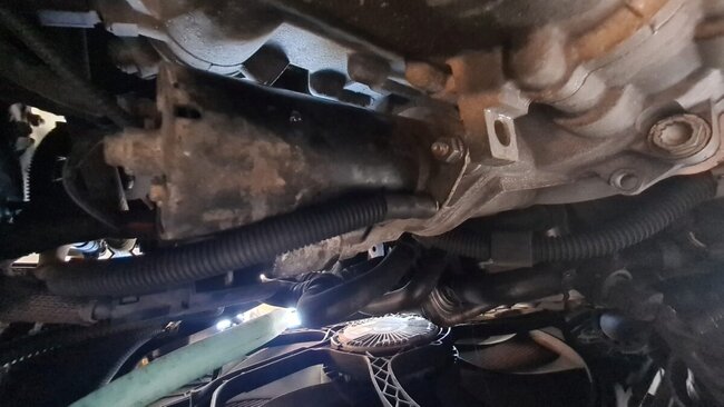

Starter Motor and Slave Cylinder From Below The Vehicle
Here is the starter motor from below. I can see 1 bolt, and also two electrical connections. Can it be removed entirely from below, or do I need to access a bolt from above?
The second picture shows the slave cylinder from underneath the van, just next to the starter motor.

Something doesn't look correct. That looks like one of the later units with the integral slave cylinder inside the housing. This is the original engine, correct? Looking at the images you can see it's leaking at the seam between the engine and transmission so it's likely inside the bellhousing. Which country was this one built for, that might make a difference.
May 14, 2023 at 2:36 PM
MRPAULHARRIS
  • 17 POSTS
It is built for Australia. The engine is CFCA 132kw. This is the original engine that came with the van. Do the images imply there is a failure at the seam? Or is it just that the slave cylinder is leaking, and because it is inside the bellhousing that is causing fluid to appear at the bottom of the engine / transmission?

Empty hole is used for other vehicles. Okay, found the clutch assembly for yours, it's an
integral unit, used in the mid-year update to the T5, they used it on some builds from 2010 with one transmission and it went into them all mid 2012, yours must be a mid to late 2012 build. That would also explain the fitting on the bellhousing as it's a pass through line. If it failed it isn't going to be a simple repair as I wrote above, the integral units have to be removed with the transmission removed from the engine, if you are doing that you may as well do a full clutch service on it as it will have to be split. To inspect it you can remove the starter and use an inspection camera to see inside to find the leak, but that is a typical failure mode of the integral units.

It turns out that my slave cylinder (which is an internal concentric slave cylinder) has failed. Its seals have broken and that resulted in brake fluid emptying out into the transmission.
