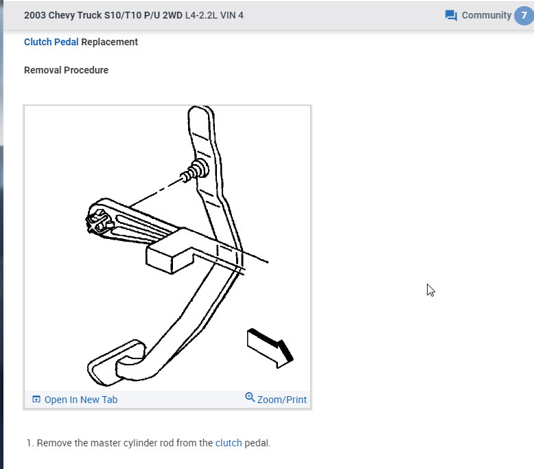

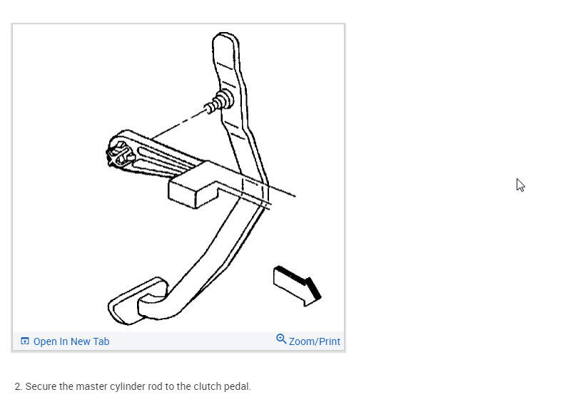

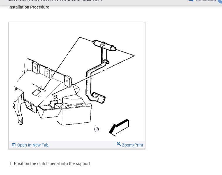

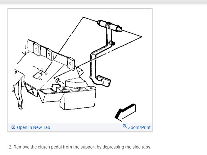

How to remove the clutch pedal?
Saturday, February 1st, 2020 AT 6:25 AM
MECHANIC
18,907 POSTS
I attached the process for removing and installing the pedal. Check out the diagrams (Below). Please let us know what you find. Let me know if you need more info. Thanks.
