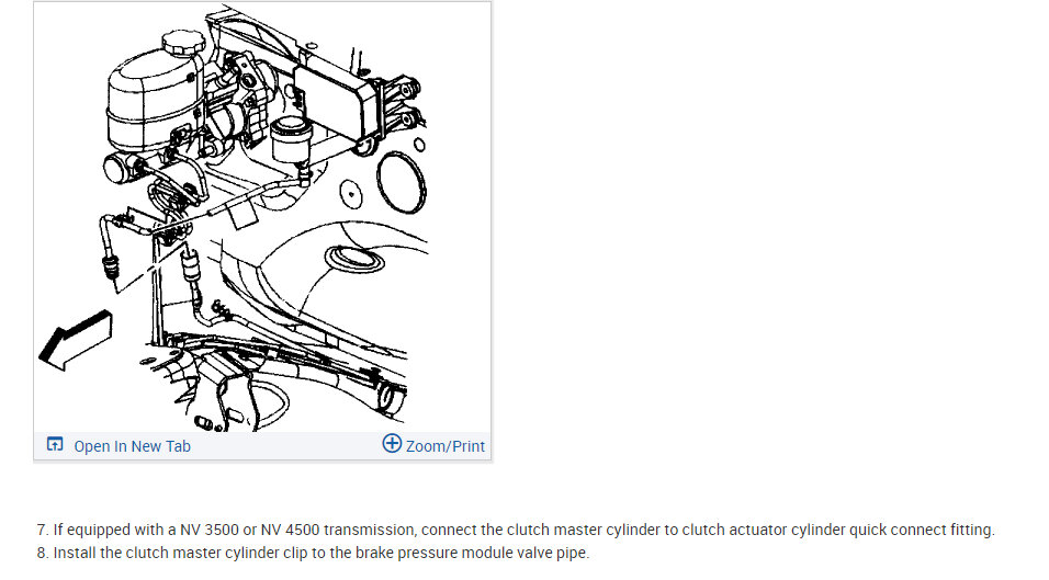

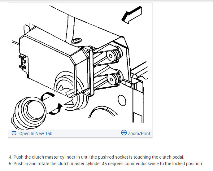

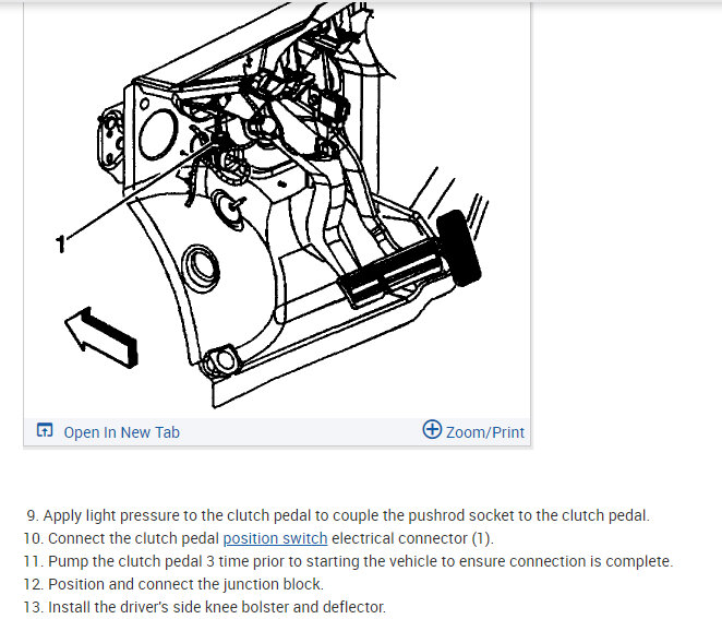

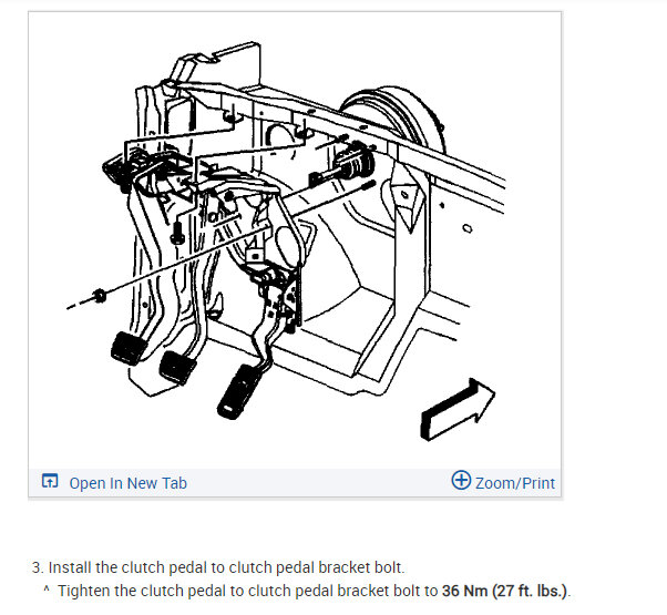

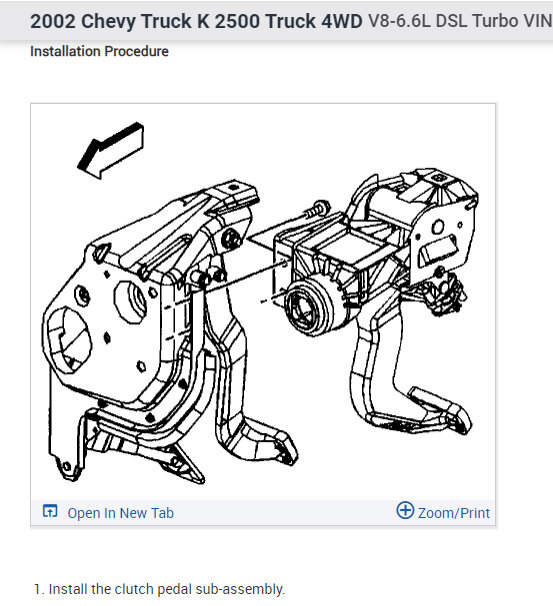

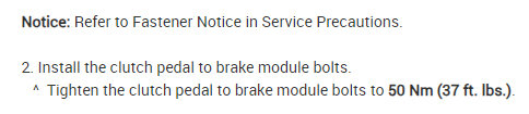

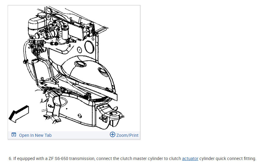

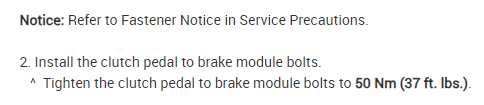

I replaced the clutch pedal bracket and now I'm trying to put the clutch pedal back in place. Is there an easy way to do this? I'm having trouble getting the pedal to go up into bracket.
Dec 27, 2023 at 11:29 AM
  • 110,240 POSTS
Not being there makes that a difficult question to answer. So, I attached the installation directions below for you. Take a look through them and let me know if anything helps. Also, two different manual transmissions were used which changed the installation process.
