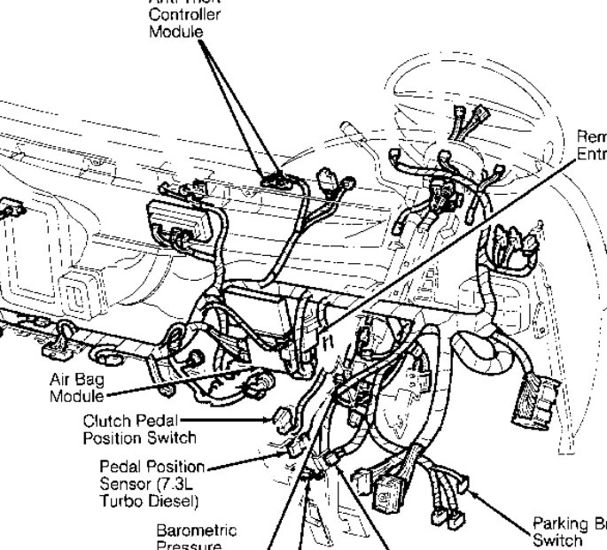

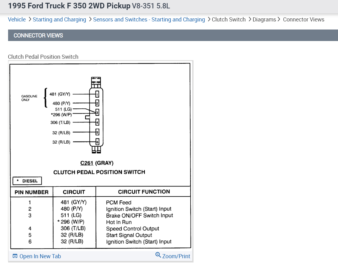

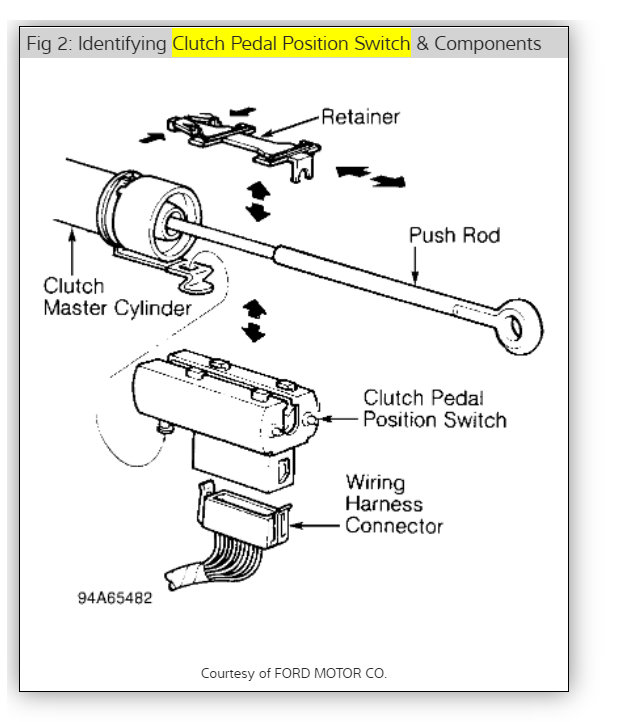

When I start the truck, I have to push the clutch pedal to the floor and push it hard after it hits the floor to start it, was running no issues.
May 2, 2022 at 4:44 AM
  • 55,691 POSTS
This happens when the clutch switch goes out or needs adjustment. The clutch switch is located under the dash on the driver's side. here are instructions for the replacement and wiring connector diagrams so you can see how the system works. Check out the diagrams (below). Please let us know what you find. We are interested to see what it is.
