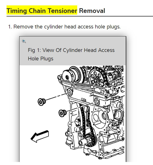

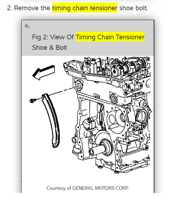

Fan still runs and truck doesn't overheat. But noise is more frequent and getting louder.Clutch or water pump?
Jul 13, 2019 at 6:04 AM
SCGRANTURISMO
  • 4,897 POSTS

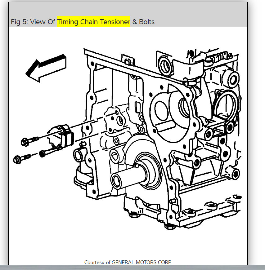

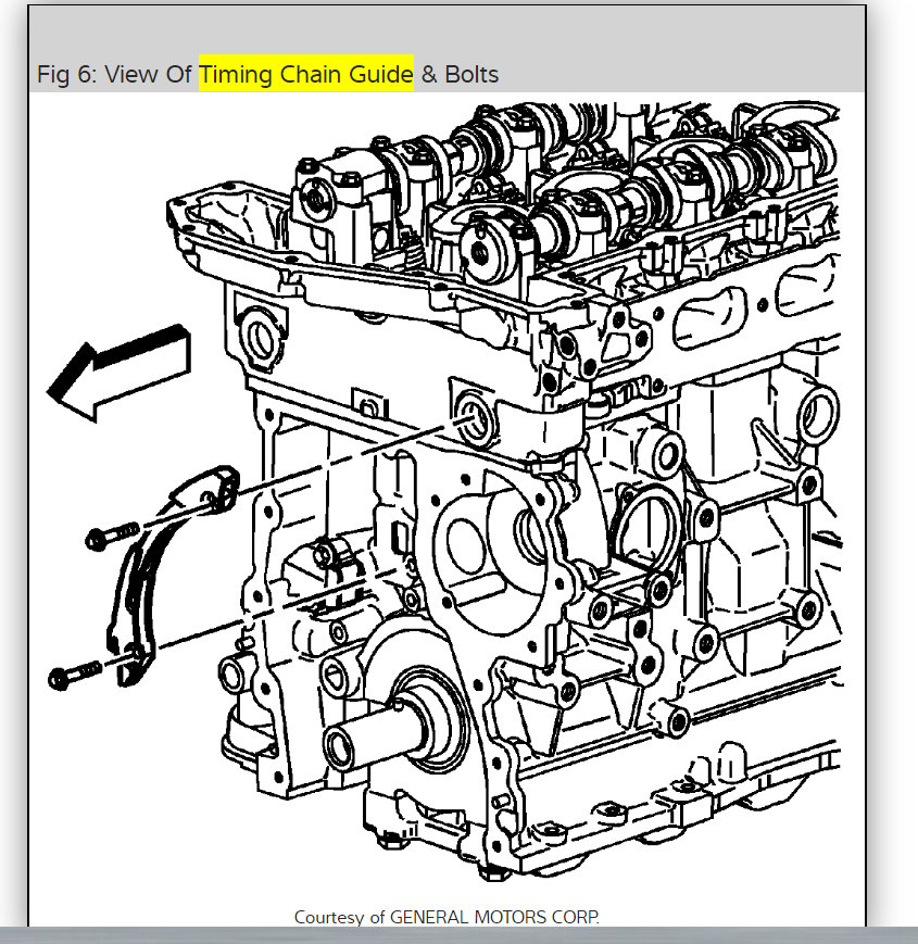

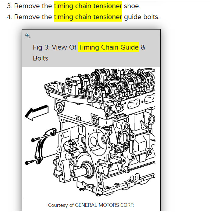

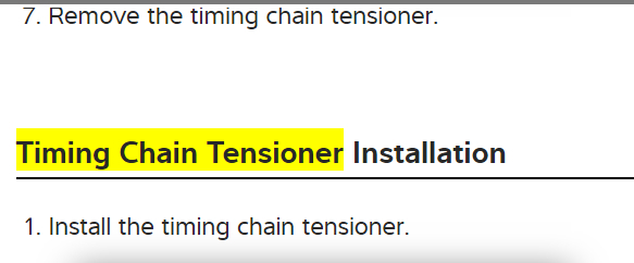

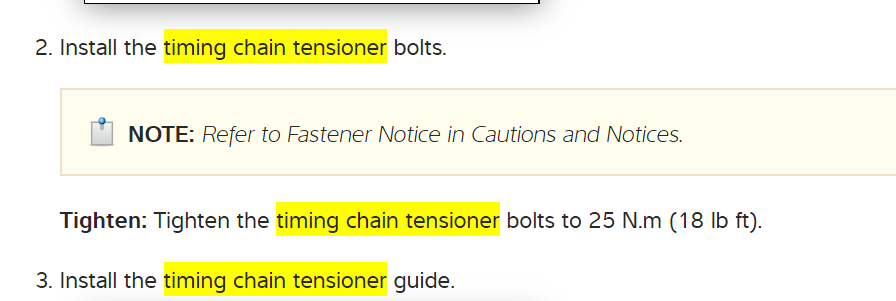

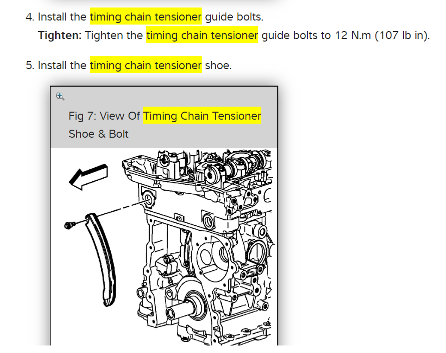

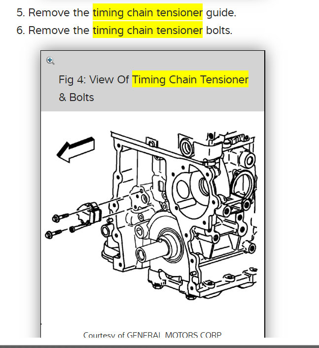

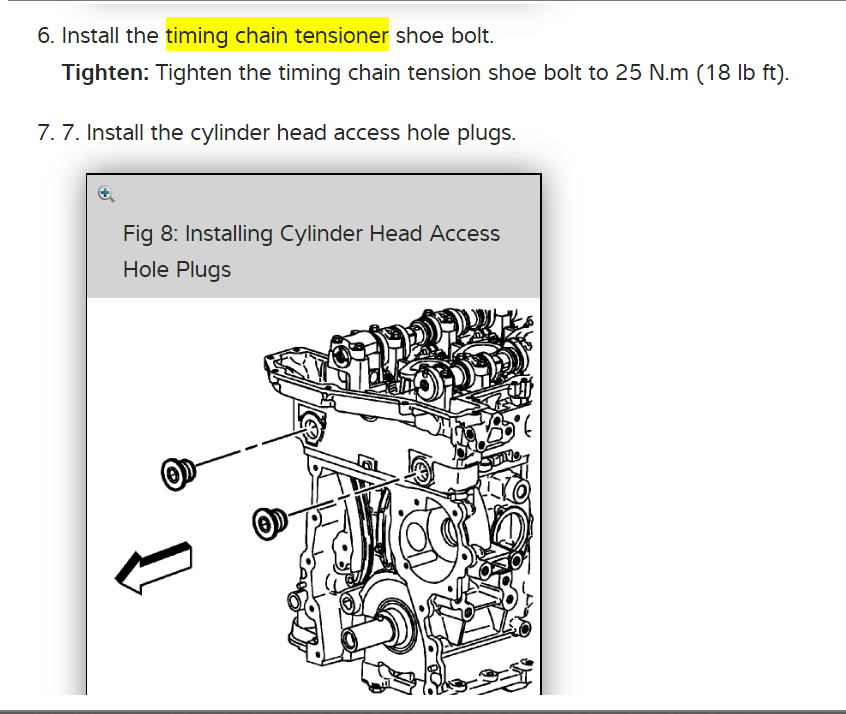

This could be a problem with your timing chain or the timing chain tensioners. In the diagrams down below i have included a guide on how to check and remove and install the timing chain tensioners. Please go through this guide and get back to us with what you are able to find out.
