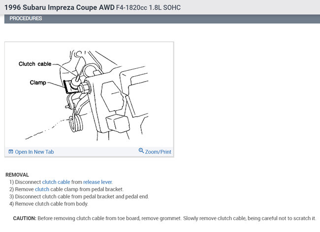

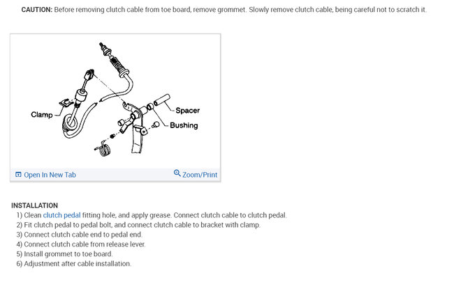

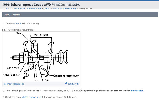

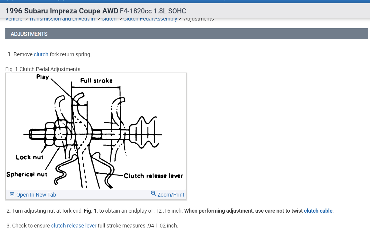

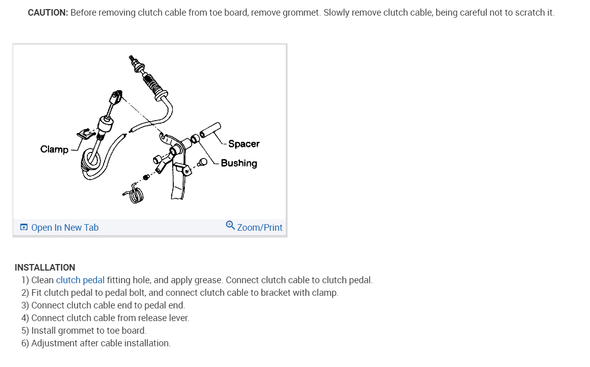

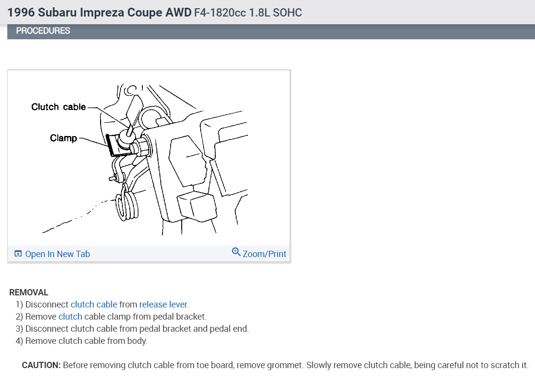

Every few days I had to adjust the clutch cable because it wasn't fully engaging. Adjusting it would fix the issue, and then the nut would back off or the cable was stretching, and it wouldn't work again. I replaced the cable and now, after adjusting many times, it won't engage properly. I replaced the clutch in 2018 so I don't think that's the issue. When I tighten it all the way in it is very hard to press and doesn't engage fully, and when it's less tightened, I have the same issue, but the pedal feels different. The only thing of note about the clutch cable change is that I wasn't able to get the grommet to seat fully into the firewall.

Is there free pedal at the top of the pedal travel? Can you shoot me a short video of the problem so I can see what's going on? You can upload it in your response. Here are the instructions on how to replace and adjust it in case we miss something. The only other thing I can think of is the clutch throw out bearing or clutch disc has come apart. Here is a video that can help as well, please check out the images below for more information.
https://youtu.be/EpBMj5ZY_bo
and
https://www.2carpros.com/articles/clutch-doesnt-work-sometimes-or-not-at-all
Check out the images (below). Let us know what happens and please upload pictures or videos of the problem.
