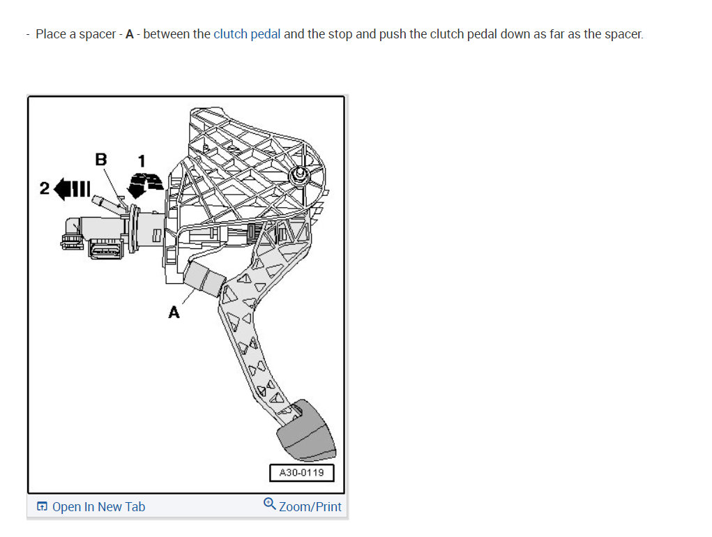

Hi, can you please tell me the procedure to remove the clutch master cylinder? Looks harder than i thought. I have done on other cars before. Some guidance is needed here.
Jun 20, 2021 at 9:42 AM
Good morning,

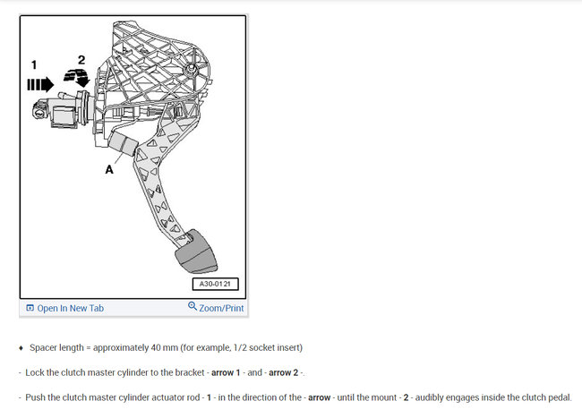

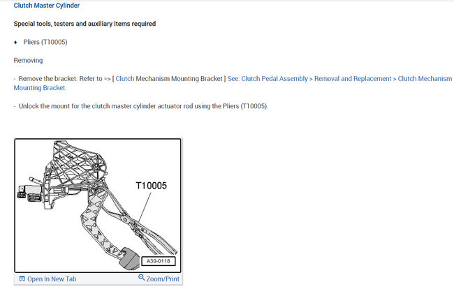

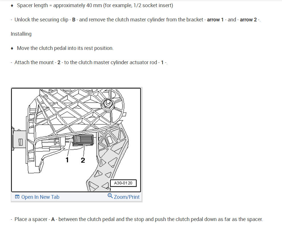

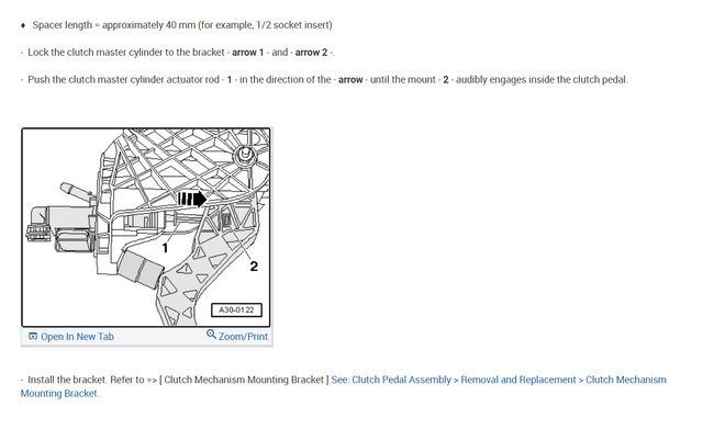

The hardest part of this job is to release the rod from the clutch pedal. Once that is done, you need to use a spacer to keep the pedal from reconnecting with the rod during the removal.
I attached the procedure for you to view.
