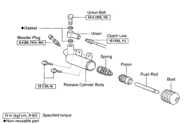

Many times I get stuck in gear, pretty much always have to pump the clutch pedal a couple of times and then it goes back to working normal for a little bit. What else might that be other than the clutch master cylinder. The clutch was just replaced and both slave cylinders were replaced before the clutch. The problem did start before I had the clutch replaced. Have not noticed any leaks, but have not looked closely yet. Clutch fluid was low last time I checked it and did fill it back up. Just want to know if anything else would cause it to get stuck in a gear, usually a low gear, don't believe that has ever happened in third, fourth, or fifth gear. Thanks

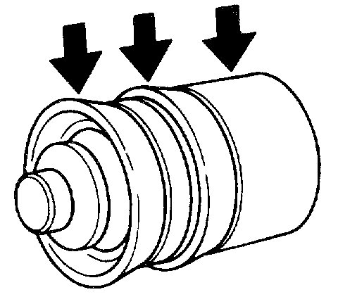

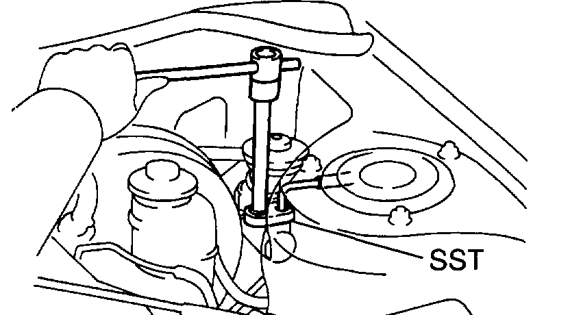

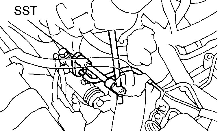

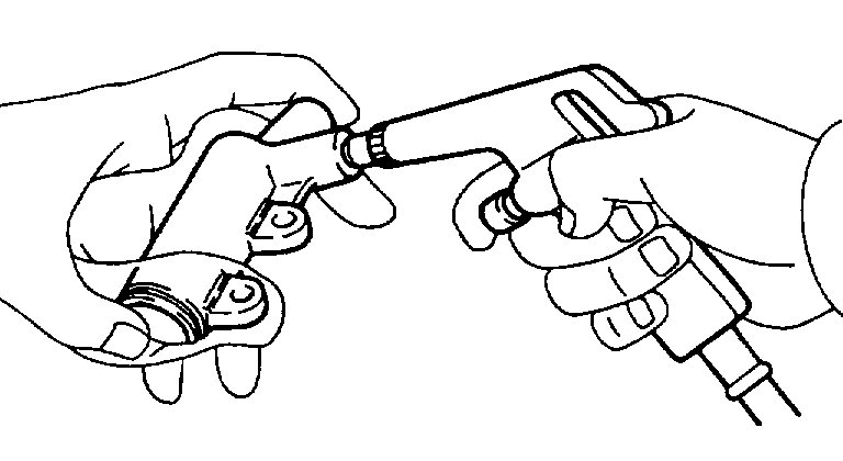

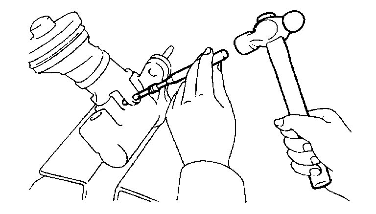

If you determine which one is leaking, here are the directions for replacement. First is the slave cylinder. The attached pics correlate with the directions.
____________________________-
1999 Toyota Corolla CE Sedan L4-1.8L (1ZZ-FE)
Procedures
Vehicle Transmission and Drive-train Clutch Clutch Hydraulic System Clutch Slave Cylinder Service and Repair Procedures
PROCEDURES
pic 1
REMOVAL
pic 2
1. DISCONNECT CLUTCH LINE
a. Using SST, disconnect the clutch line.
SST 09023-00100
b. Use a container to catch the fluid.
2. REMOVE 2 BOLTS AND PULL OUT RELEASE CYLINDER
DISASSEMBLY
1. REMOVE BLEEDER PLUG
2. REMOVE UNION BOLT, 2 GASKETS AND UNION
3. PULL OUT BOOT WITH PUSH ROD

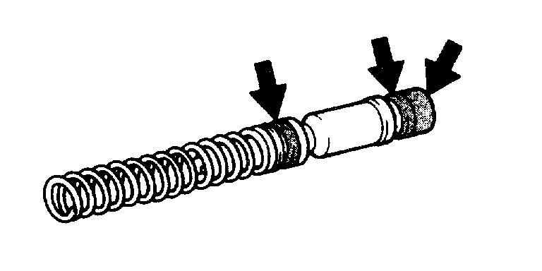

pic 3
4. REMOVE PISTON
Using compressed air, remove the piston and the spring from the cylinder.
REASSEMBLY

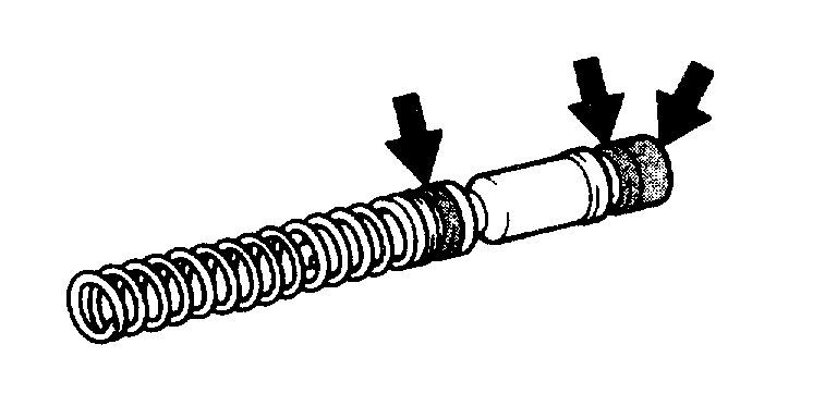

pic 4
1. COAT PISTON WITH LITHIUM SOAP BASE GLYCOL GREASE, AS SHOWN
2. INSTALL PISTON WITH SPRING INTO CYLINDER
3. INSTALL BOOT WITH PUSH ROD TO CYLINDER
4. INSTALL UNION 2 GASKETS AND UNION BOLT
Torque: 24.5 Nm (250 kgf-cm, 18 ft. lbs.)
5. INSTALL BLEEDER PLUG
Torque: 8.4 Nm (85 kgf-cm, 74 inch lbs.)
INSTALLATION
1. INSTALL RELEASE CYLINDER AND 2 BOLTS
Torque: 12 Nm (120 kgf-cm, 9 ft. lbs.)

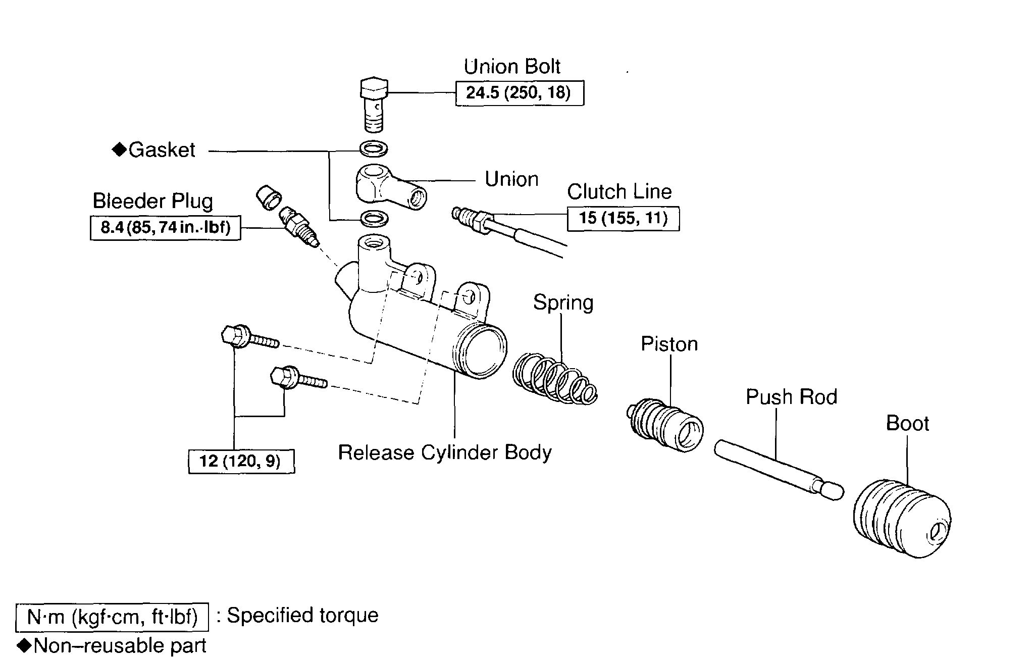

pic 5
2. CONNECT CLUTCH LINE
Using SST, connect the clutch line.
SST 09023-00100
Torque: 15 Nm (155 kgf-cm, 11 ft. lbs.)
3. FILL CLUTCH RESERVOIR WITH BRAKE FLUID AND BLEED CLUTCH SYSTEM
4. CHECK FOR LEAKS
___________________________________

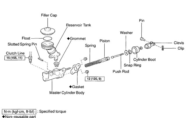

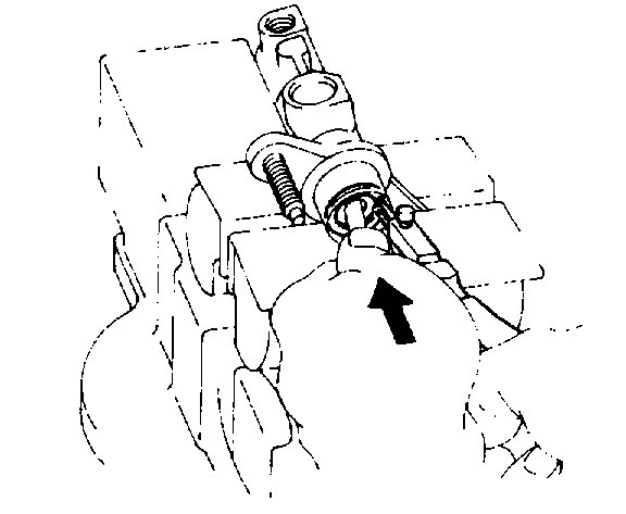

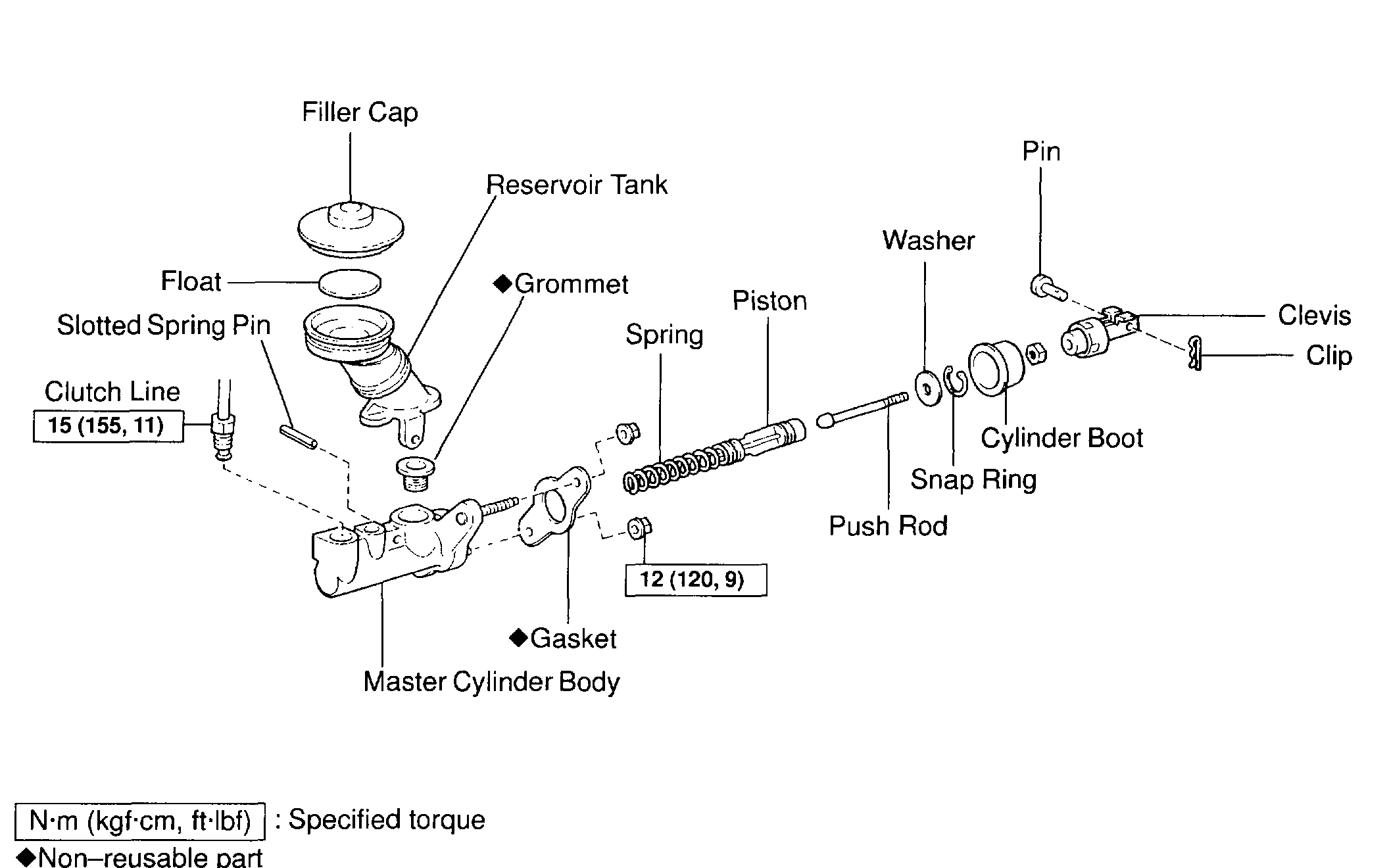

Here are the directions for the clutch master cylinder. When checking for leaks, also check under the dash where the clutch pedal attaches to the push rod.
Procedures
Vehicle Transmission and Drivetrain Clutch Clutch Hydraulic System Clutch Master Cylinder Service and Repair Procedures
PROCEDURES
pic 5
REMOVAL
1. REMOVE BRAKE BOOSTER
2. DRAW OUT FLUID WITH SYRINGE

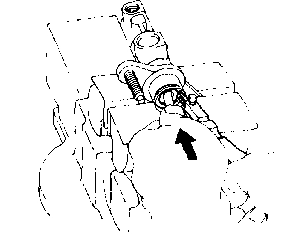

pic 6
3. DISCONNECT CLUTCH LINE
SST 09023-00100
4. REMOVE LOWER FINISH PANEL AND LOWER INSERT
5. REMOVE NO. 2 HEATER TO REGISTER DUCT
6. REMOVE CLIP AND PIN
7. REMOVE 2 MOUNTING NUTS AND PULL OUT MASTER CYLINDER
8. REMOVE GASKET FROM MASTER CYLINDER
DISASSEMBLY
1. REMOVE CLEVIS AND BOOT
a. Loosen the lock nut to remove the clevis and remove the lock nut.
b. Remove the boot.
pic 7
2. REMOVE RESERVOIR TANK
a. Using a pin punch and hammer, drive out the slotted spring pin.
b. Remove the reservoir tank and grommet.
pic 8
3. REMOVE PUSH ROD
a. While pushing the push rod, using snap ring pliers remove the snap ring.
b. Remove the push rod and washer.
4. REMOVE PISTON
REASSEMBLY
pic 9
1. COAT PARTS WITH LITHIUM SOAP BASE GLYCOL GREASE, AS SHOWN
2. INSERT PISTON INTO CYLINDER
pic 10
3. INSTALL PUSH ROD ASSEMBLY WITH NEW GASKET AND NEW WASHER
a. Install the washer to the push rod
b. Push the push rod to the piston, using snap ring pliers, install the snap ring.
c. Install the boot.
4. INSTALL RESERVOIR TANK
a. Install the reservoir tank and a new grommet.
b. Using a pin punch and hammer, drive in the slotted spring pin.
INSTALLATION
1. INSTALL NEW GASKET TO MASTER CYLINDER
2. INSTALL MASTER CYLINDER AND 2 MOUNTING NUTS
3. INSTALL PIN AND CLIP
4. INSTALL NO. 2 NEATER TO REGISTER DUCT
5. INSTALL LOWER INSERT AND LOWER FINISH PANEL
pic 11
6. CONNECT CLUTCH LINE
SST 09023-00100
7. FILL CLUTCH RESERVOIR WITH BRAKE FLUID AND BLEED CLUTCH SYSTEM
8. INSTALL BRAKE BOOSTER
9. ADJUST CLUTCH PEDAL. Refer to Clutch Pedal Assembly; Service and Repair.
10. CHECK FOR LEAKS

Okay, just to clarify, the slave cylinders were replaced first, then it did pretty good for a good while, not long after that I thought the clutch was starting to slip, but it kept doing well enough for a good while, then it started getting stuck in gear too. I then thought I should just go ahead and get the clutch replaced so I would stop stressing about it. the master cylinder was never replaced. It does sound like you believe it is possible for the master cylinder to not leak and still cause me to get stuck in gear, so I will now attempt to do the master cylinder, bleed the system again, and hope that is the end of this issue. Thanks again!
Apr 25, 2020 at 12:14 PM
  • 110,244 POSTS
That is correct. There is a plunger in the master cylinder that when worn, can allow fluid to bypass. Let me know if that takes care of the problem.
Apr 25, 2020 at 4:18 PM
DARG49
  • 44 POSTS
Yep, it was the clutch master cylinder. I replaced it this evening and I think it is all back to normal, or at least I sure hope so. Thanks for all your help!
