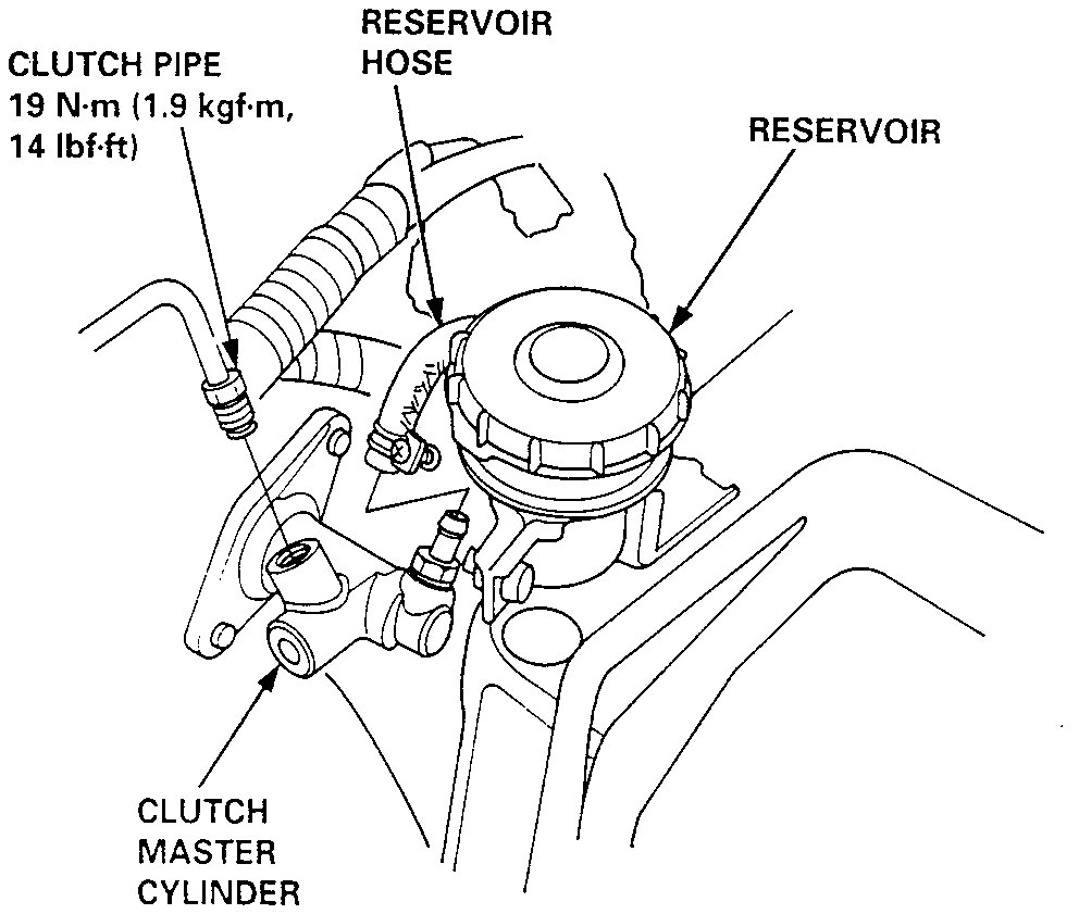

My clutch line is leaking somewhere and I can't seem to find out where it's coming from. Already bought new master and slave so just wondering if you guys know of any websites or anything that would show a detailed clutch fluid line diagram that I could check out please?

There are only two to consider, the rubber hose between the master cylinder and the reservoir and then a steel line that runs between the clutch master cylinder and the slave on the transmission.
I attached a picture of the master cylinder and rubber reservoir hose. The steel line you should be able to follow.

Let me know if this helps or if you have other questions. Also, let me know where approximately it is leaking from.

That's not it. It's the hose near the clutch damper.
