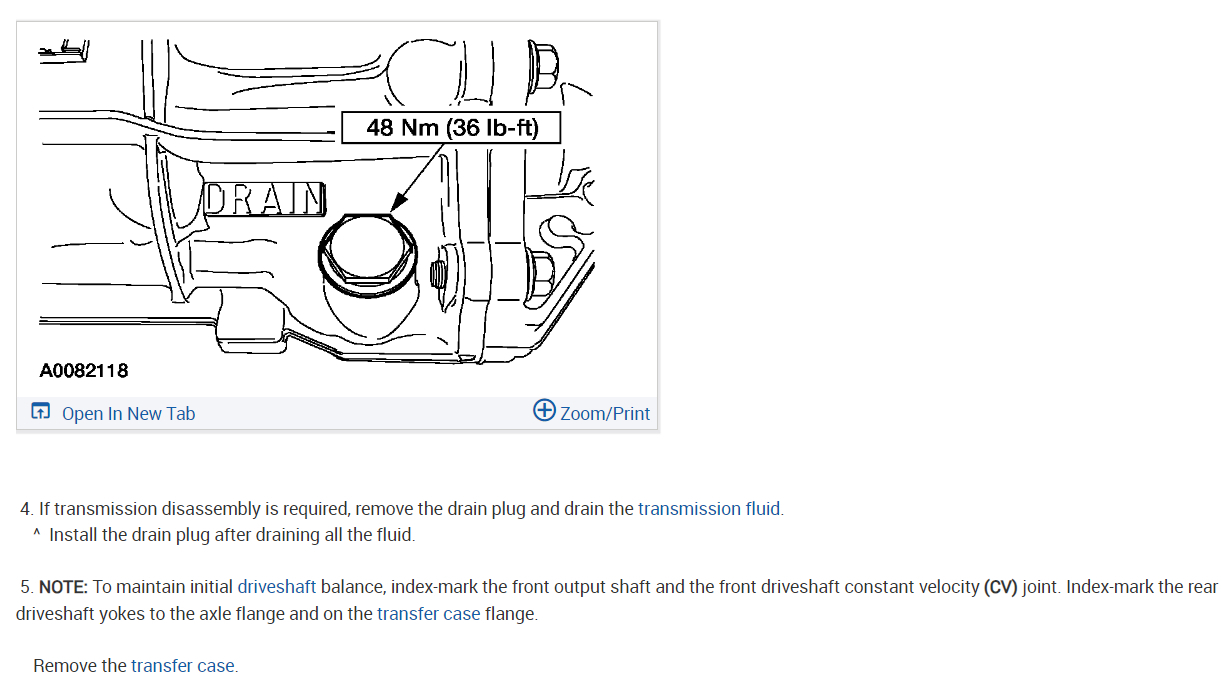

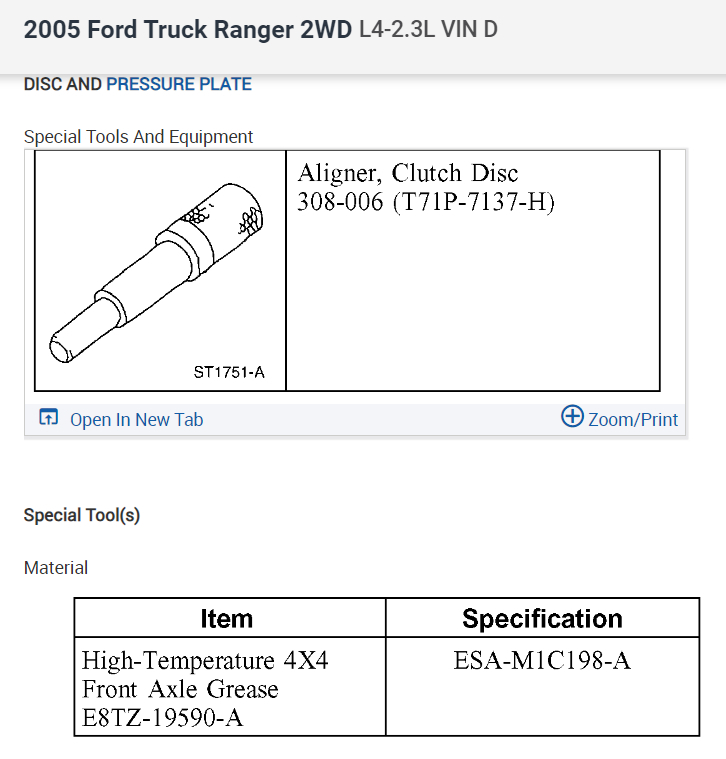

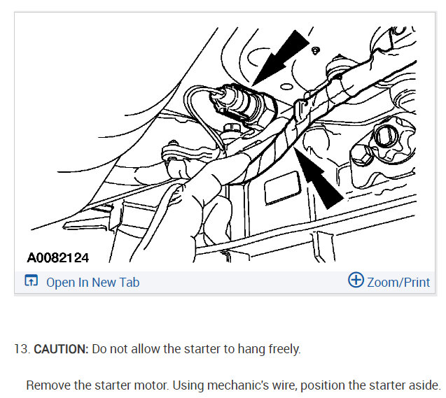

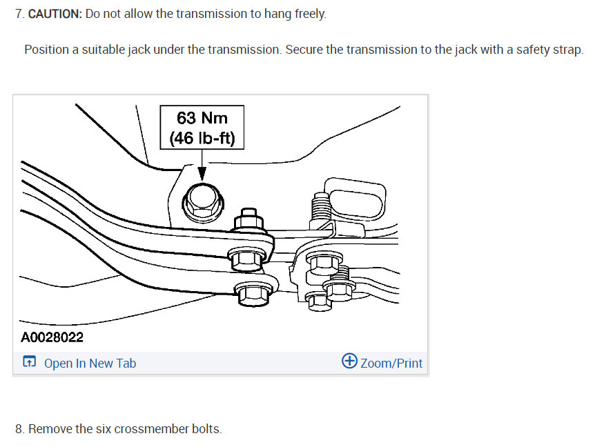

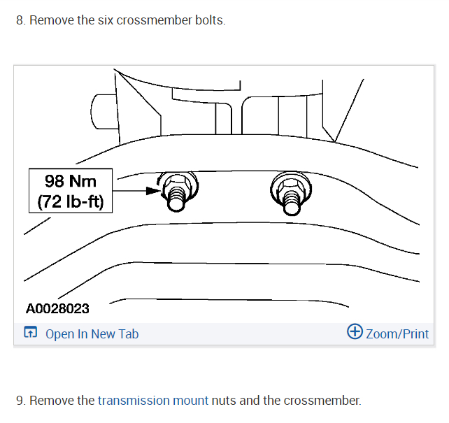

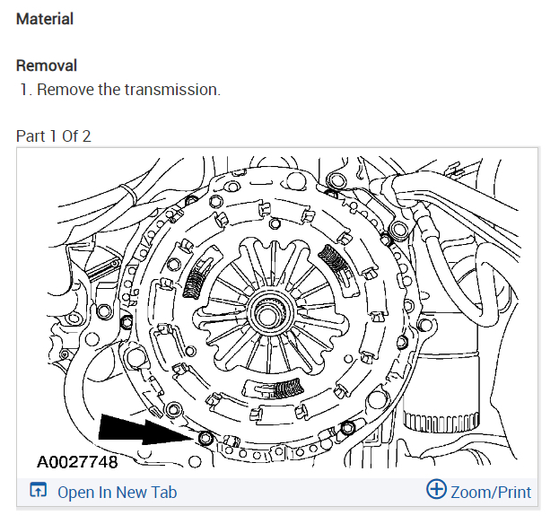

Instructions and torques specs needed for replacing the clutch?
2005 FORD RANGER
136,000 MILES • 2.3L • 4 CYL • 2WD • MANUAL
SMALLFRY1989

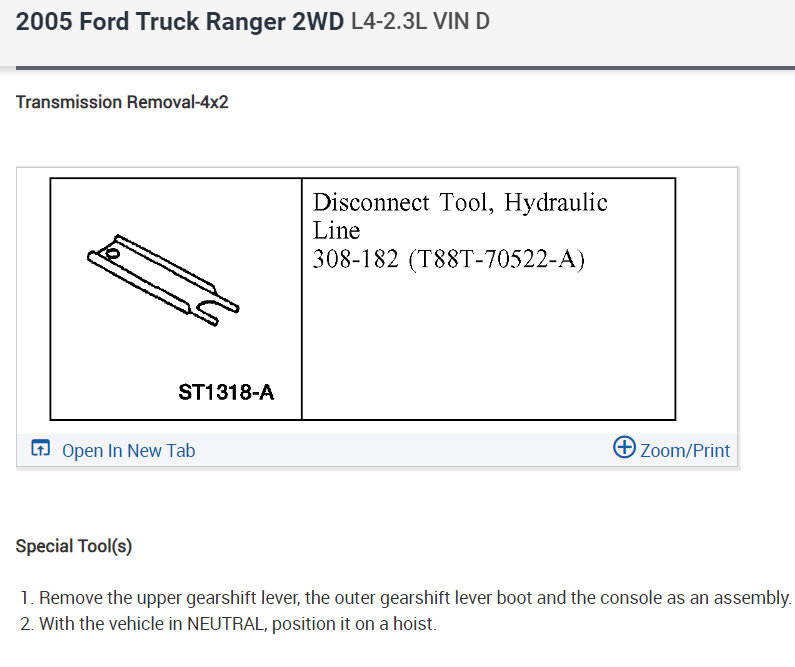

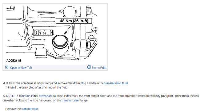

Hello, i want to do a clutch job on my truck listed above. I would like some guides on how to do it and some torque specs if possible but not a big deal. thank you very much! Kirk
Mar 12, 2024 at 4:38 PM
  • 55,433 POSTS

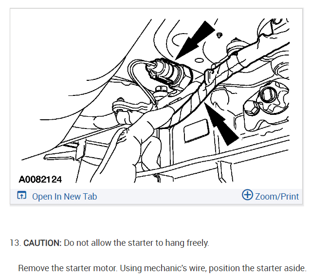

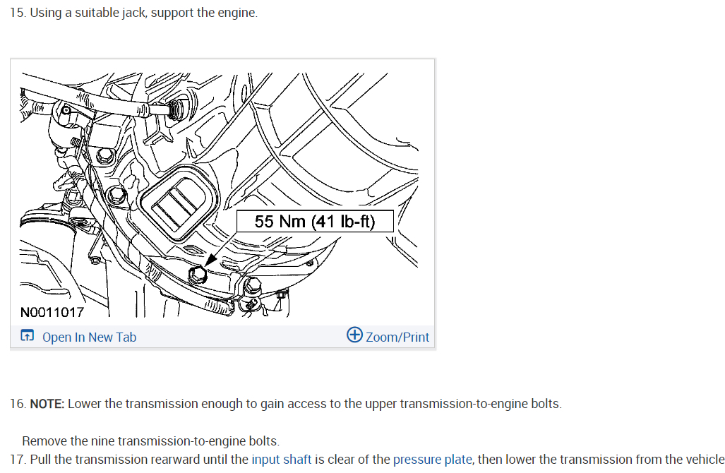

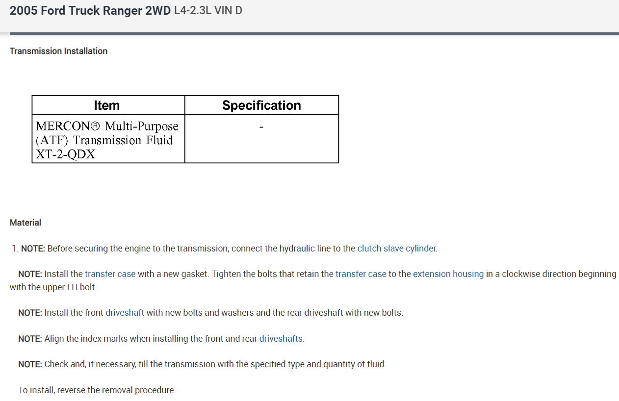

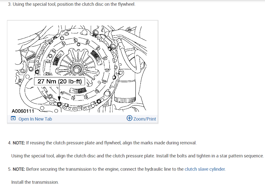

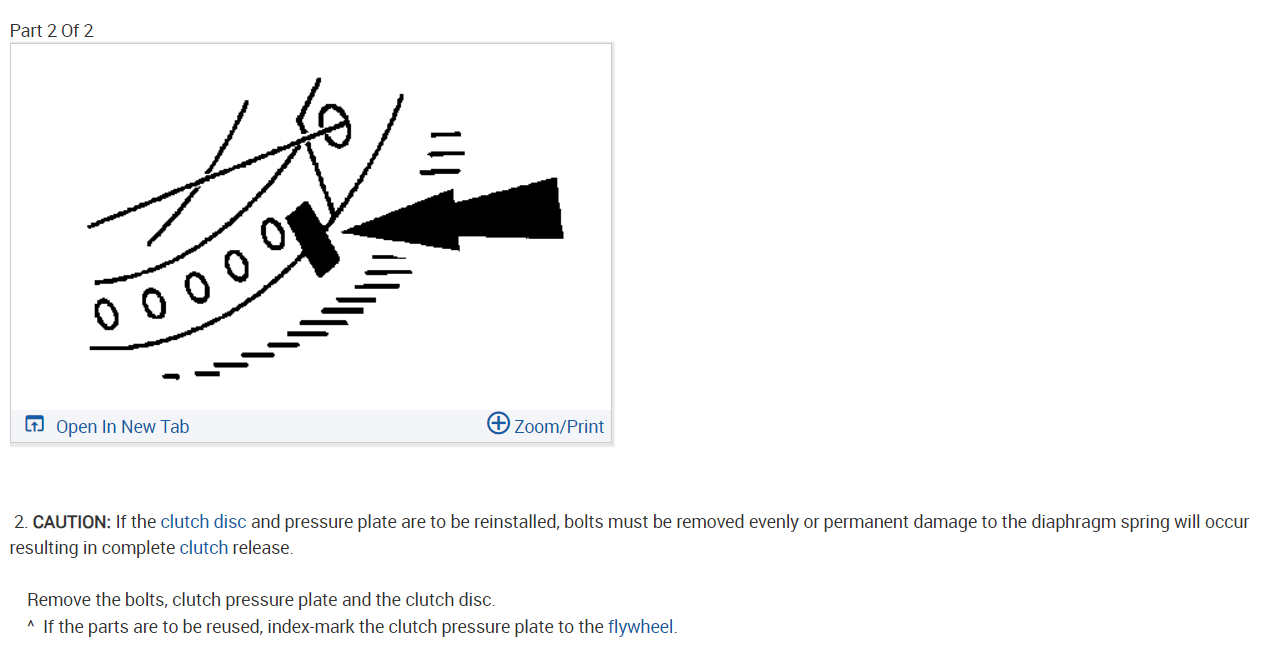

Hello Kirk,

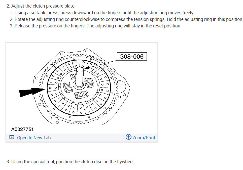

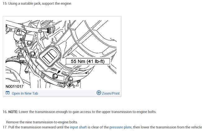

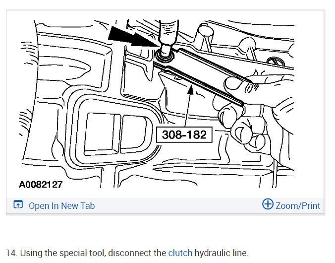

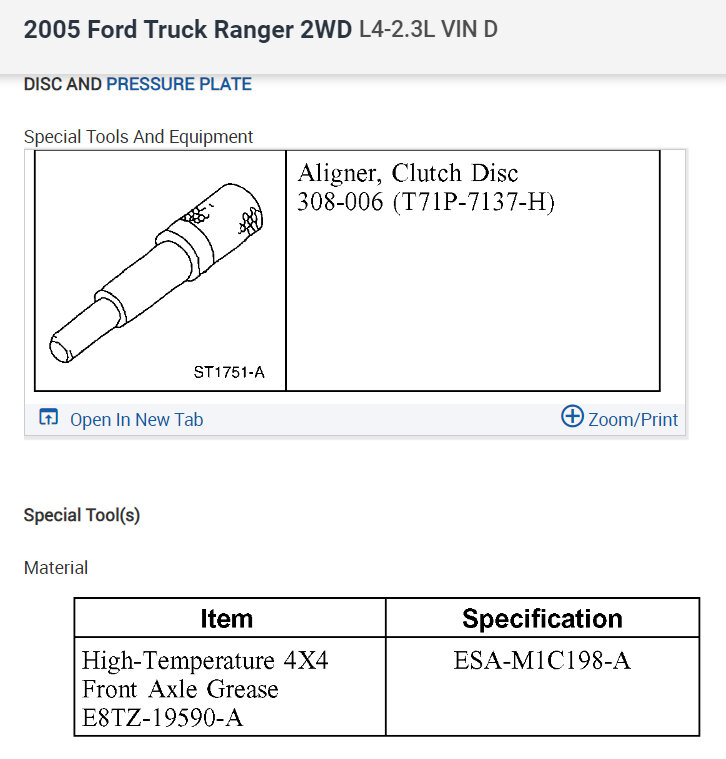

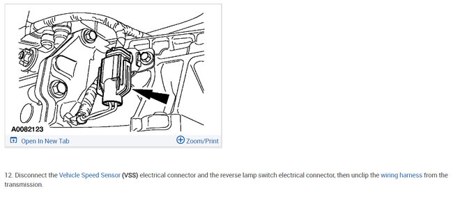

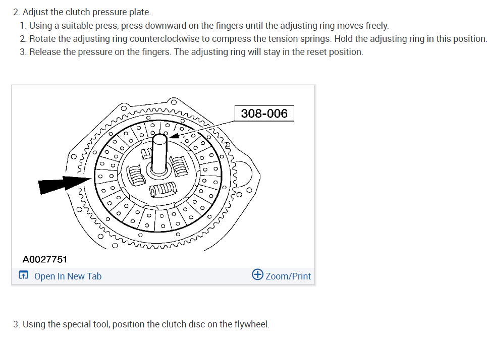

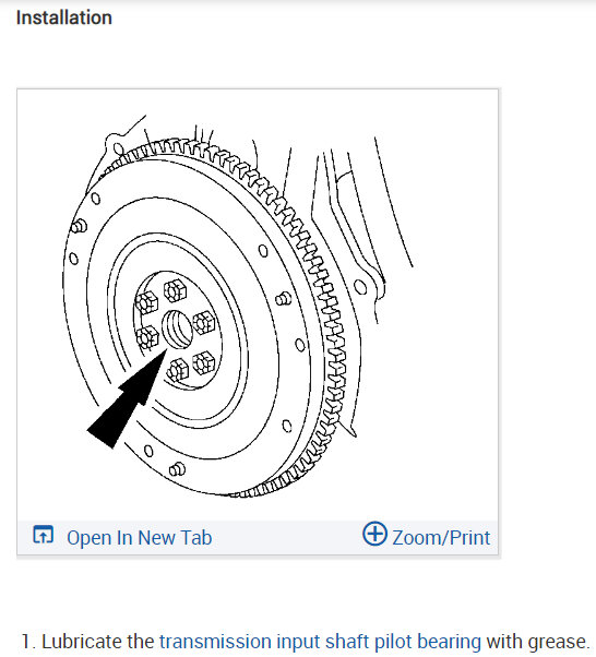

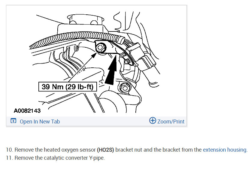

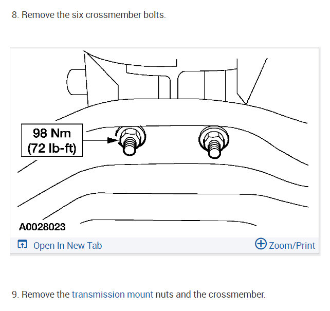

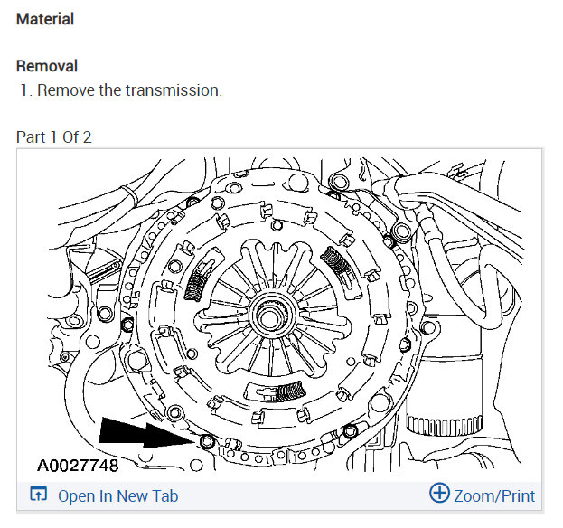

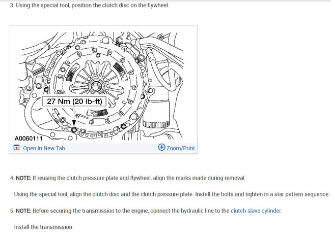

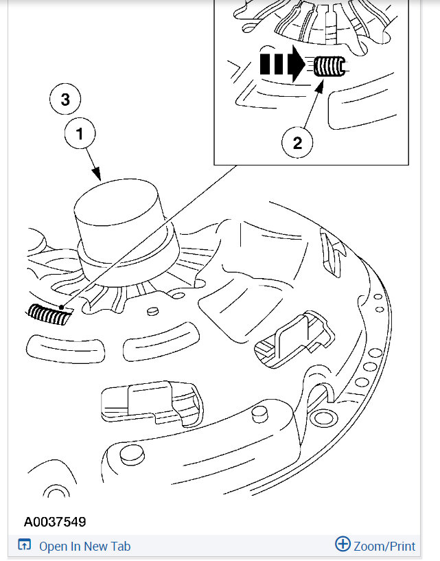

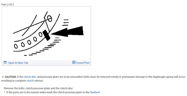

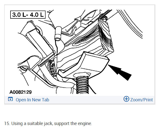

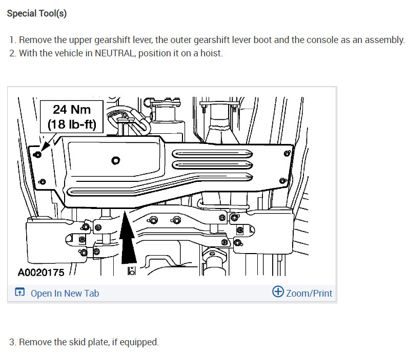

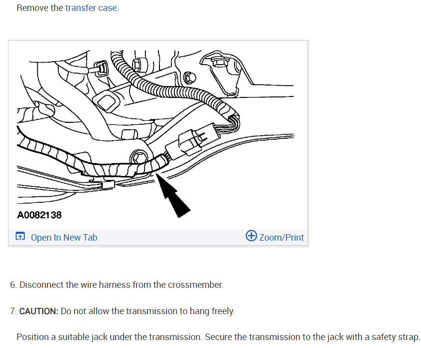

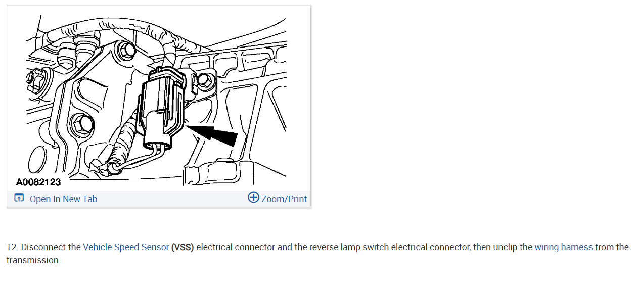

Yep, we can help walk you through it, just take your time and if you need to take a break. Here is a guide that will help walk you through the job with a video below that shows the job being done on a similar vehicle (the job is the same). Also, I have included the instructions and torque specs in the images below as well.
https://www.2carpros.com/articles/how-to-replace-a-clutch
and
https://youtu.be/JpzefqEeVGE?si=MJXkuB8mn-S4Vdl6
Here are the instructions in the images below for you. Check out the images (below). Please upload pictures or videos in your response to the problem so we can see what's going on.
