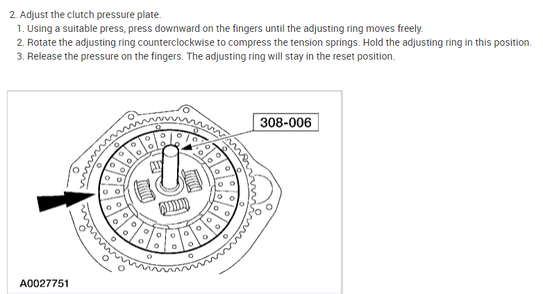

in cool and or damp weather, the clutch makes a squeaking noise when i let the clutch pedal out(engage clutch) seems to go away when weather warms up. Dealer says it is the nature of the beast and that it is a spring noise...does not sound like a spring noise. More like a clutch slipping noise. The clutch behaves perfectly normal otherwise. I want to replace the clutch.

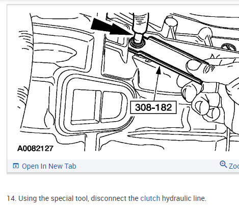

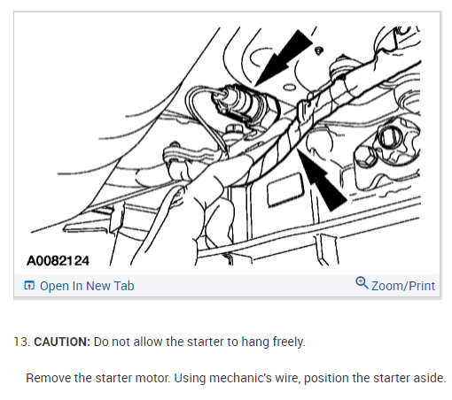

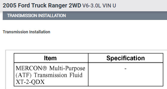

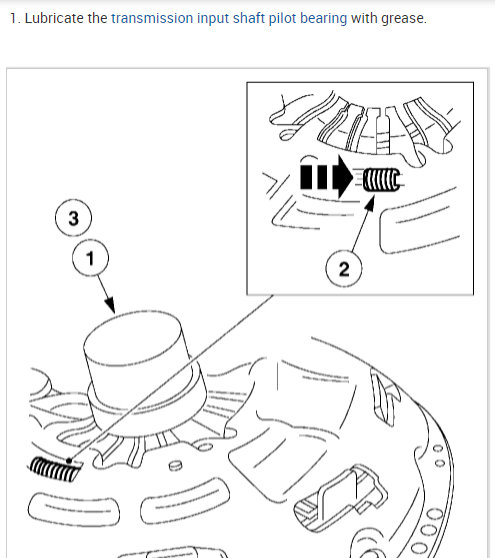

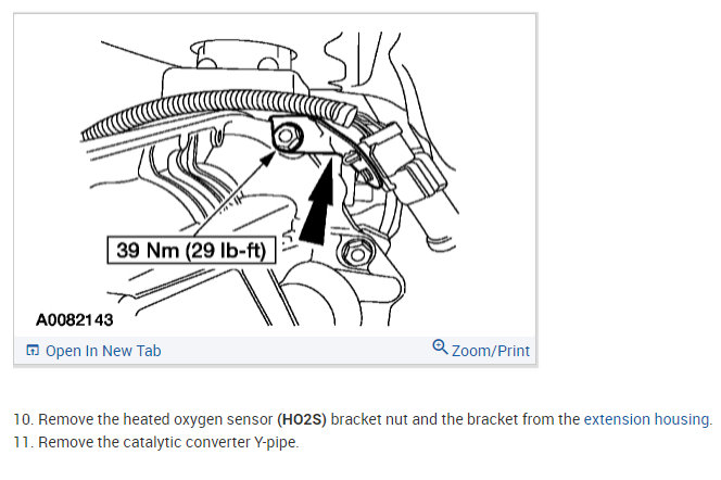

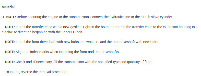

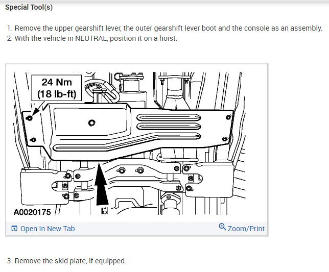

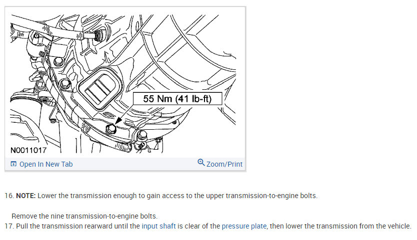

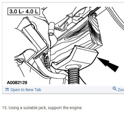

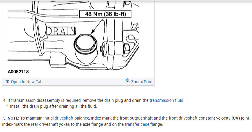

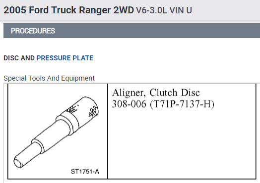

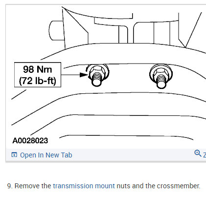

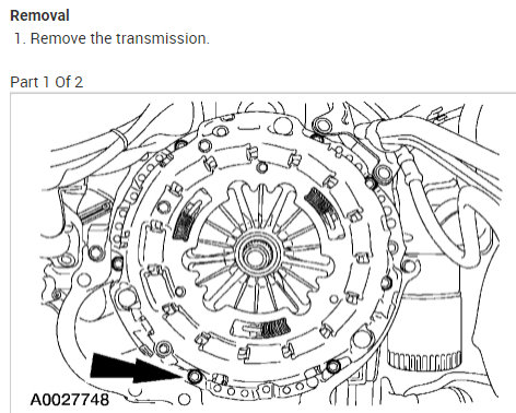

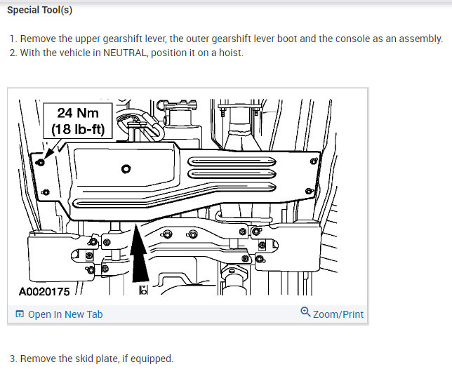

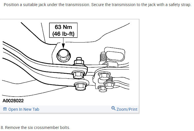

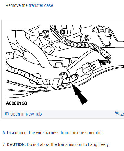

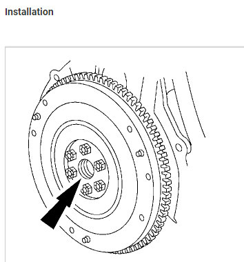

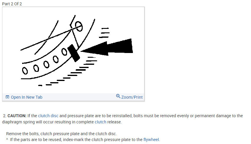

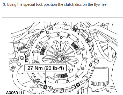

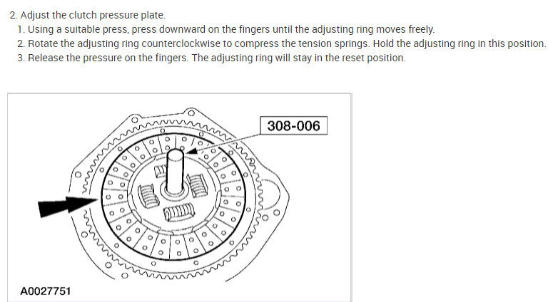

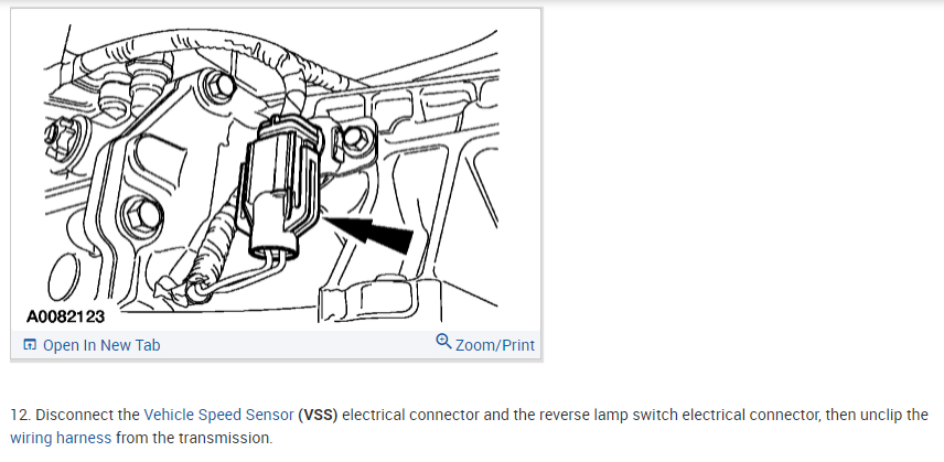

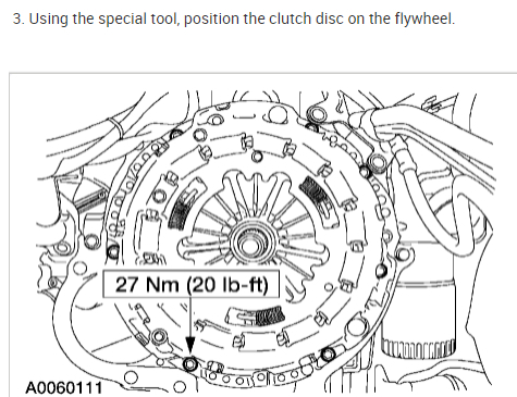

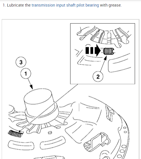

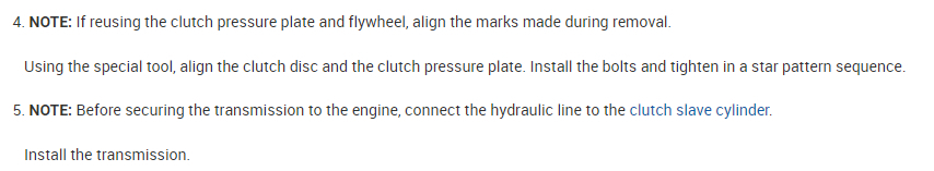

Here is the information you requested on clutch replacement. You will need to remove the transmission to gain access to the clutch assembly. Here is a tutorial for you showing how to remove a transmission:
https://www.2carpros.com/articles/transmission-replacement-removal-manual
I've attached picture steps below on how to remove and replace both the clutch assembly and transmission on your truck. Hope this helps and thanks for using 2CarPros.
