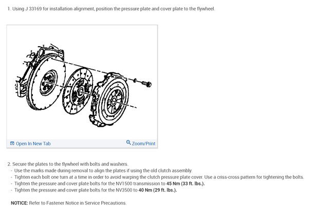

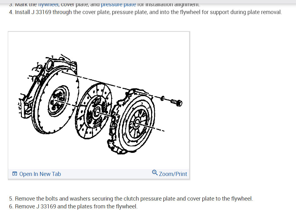

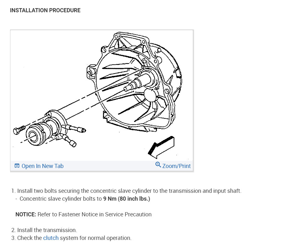

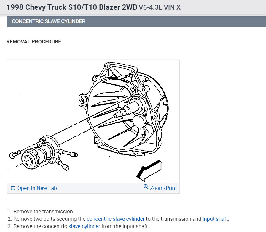

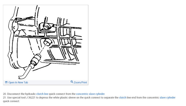

I contacted you once before but lost my phone so couldn't get back to you, so let me start from the beginning. I was having trouble starting the truck and then shifting gears. We bypassed the safety switch and bled the master cylinder really good. I had no issues for two days, then I was coming to a stop and couldn't push clutch pedal down at all. Got the truck off the road replaced the master cylinder with a new one and bled the system again, tried to start truck and nothing no power to anything couldn't even jump start it. Towed the truck home, charged the battery overnight still nothing so we changed the battery but still had to jump start it. Now with the truck running, I can't get it to go into any gear at all turn truck off, no problems going into gears but will only start in neutral and I can't shift it. I don't know what to do, please help!
Jan 11, 2023 at 8:04 AM
  • 55,658 POSTS

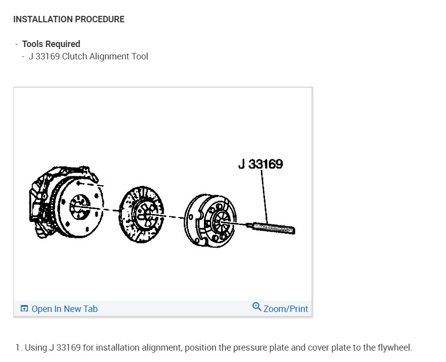

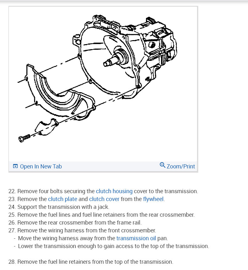

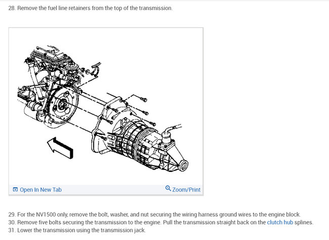

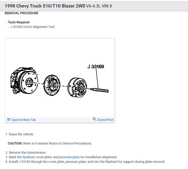

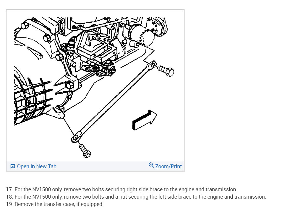

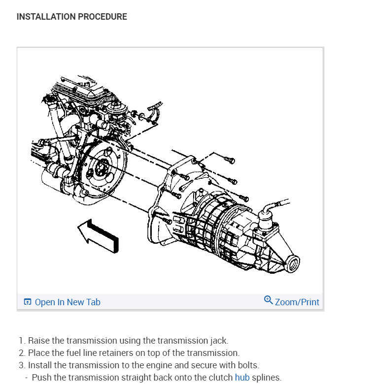

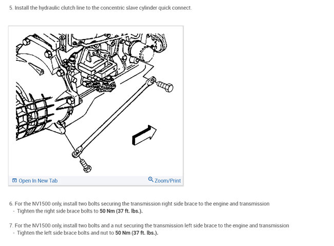

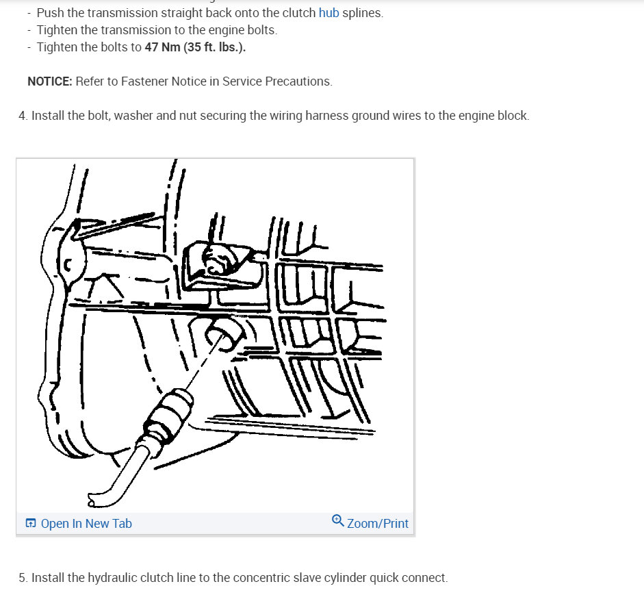

It sounds like the slave cylinder has locked up and is why you cannot push the clutch pedal down. You will need to remove the transmission to replace it. Here is a guide to help as well with instructions in the images below to help you with the repair. This guide may help as well:
https://www.2carpros.com/articles/clutch-doesnt-work-sometimes-or-not-at-all
You could have a clutch pressure plate and disc failing as well. Check out the images (below). Please let us know what happens.
Jan 12, 2023 at 2:08 AM

Ken L, okay, we replaced the slave cylinder, the disc, and clutch plate put everything back together refilled the fluids and bled system and it still won't go into gear while motor is running. now what do I do? help please!
Feb 19, 2023 at 4:01 AM
  • 55,658 POSTS
Do you have a good clutch pedal? Also, the clutch disc only goes in one way.
