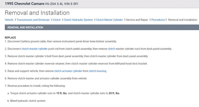

For some reason when I try to put my car in gear and turn on the engine the car starts to move. Could it be something stuck? because my clutch doesn't seem to want to engage. I thought I bled and replaced the slave cylinder still with no results. Can't get what am I doing wrong?

It does sound like it is not fully disengaging. If you replaced the slave and bled the system, the next thing is the clutch master cylinder.
Check to make sure there are no leaks at the master cylinder and the slave. If there are none and the fluid is full, suspect the master cylinder is bad.

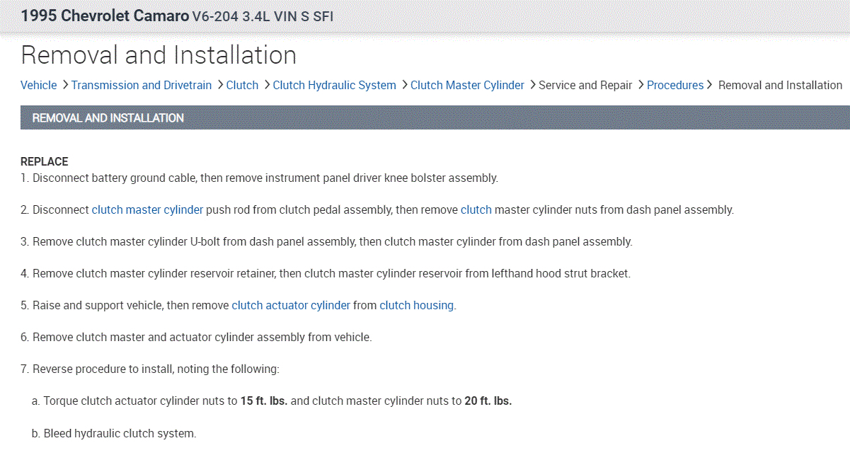

I attached the directions below for removal and replacement. Let me know if this helps.
Take care and let me know if you have questions.
See pic below.
