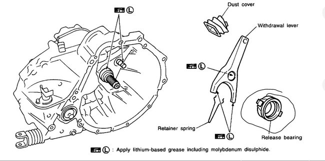

When applying my clutch you would hear a squealing noise when released noise would fade. to me clutch feels fine and I'm able to move the shifter. After I got car home I tried starting it next day it started up the squealing started stopped as I released clutch. Gave it gas car shut off and start no crank. please help

This sounds like the throw-out bearing has failed. It starts with noise until it completely locks up.
https://www.2carpros.com/articles/how-to-replace-a-clutch
It may be the issue for the no start as well.
