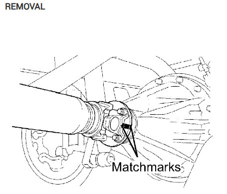

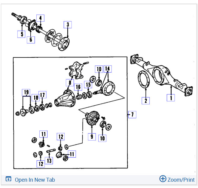

This is the clue:" Noise starts in gear and stops when clutch pushed in." If you upload a short video of the noise I can tell for sure, but it sounds like the rear gear set is bad. I would remove the drive shaft and turn the pinion gear by hand to see if you hear the noise to help confirm the issue. Here is a view of what's inside the rear diff. You might want to check the fluid but being that it is making noise it is too late. Please upload pictures or videos in your response.

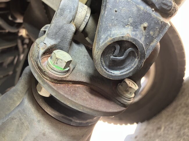

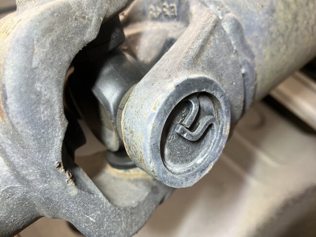

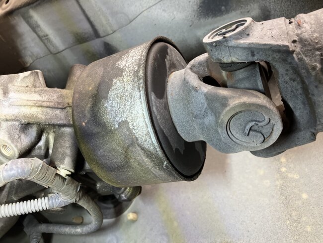

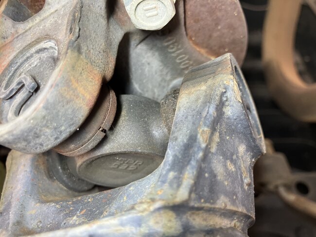

The rust dust is there as you suggested I can wipe it off with a finger. None really present on the middle and front u-joints. I would expect the recommendation is to replace all 3 and inspect the front seal as well since you’re removing the driveshaft. Here are some pictures.
Jul 8, 2025 at 6:44 AM
  • 55,770 POSTS
Thanks for the images, a Seized U joint will make this noise, I would remove the shaft and check the movement of the joints. They should be 100% smooth with not hard spots. Please let me know, thanks for the images :)
