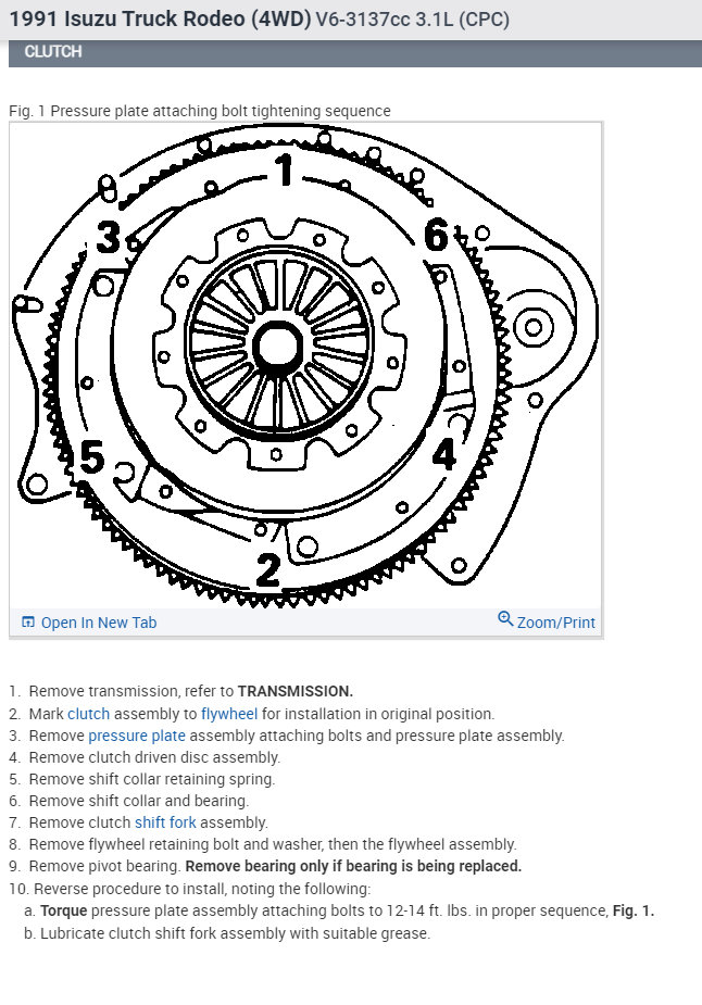

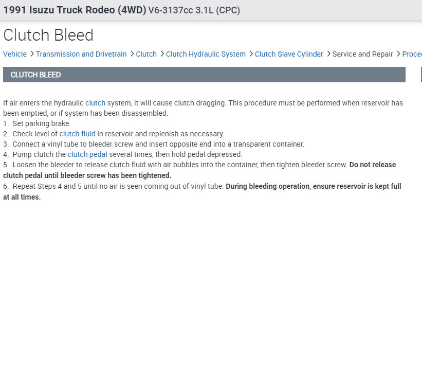

This can be due to a faulty clutch master cylinder. Could also be due to air in the clutch system, also due to being low on fluid. And of course, the clutch could be just worn to a point that it is no longer engaging.
First make sure that the fluid level is correct.
I have attached the bleeding procedure below.
