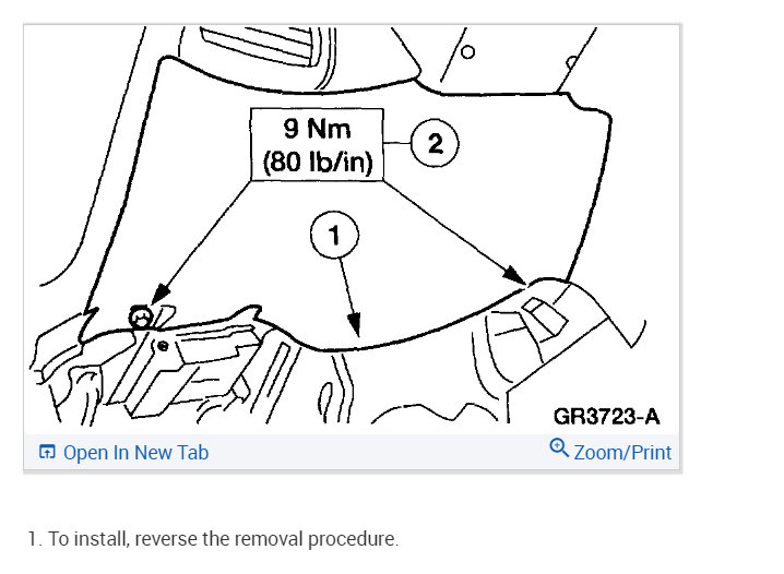

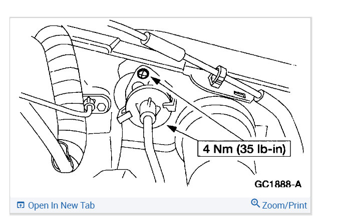

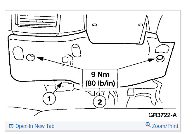

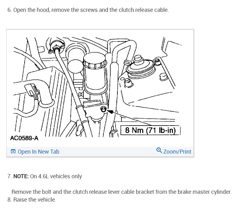

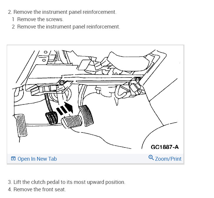

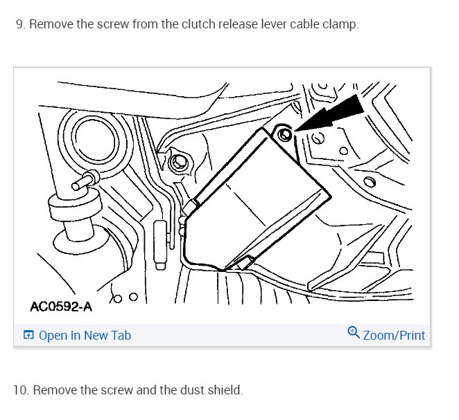

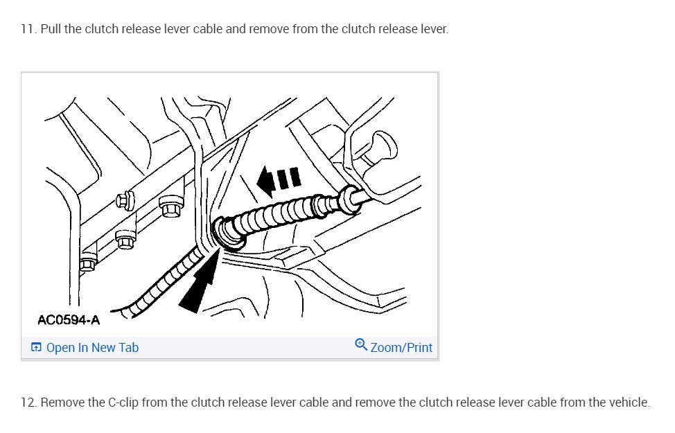

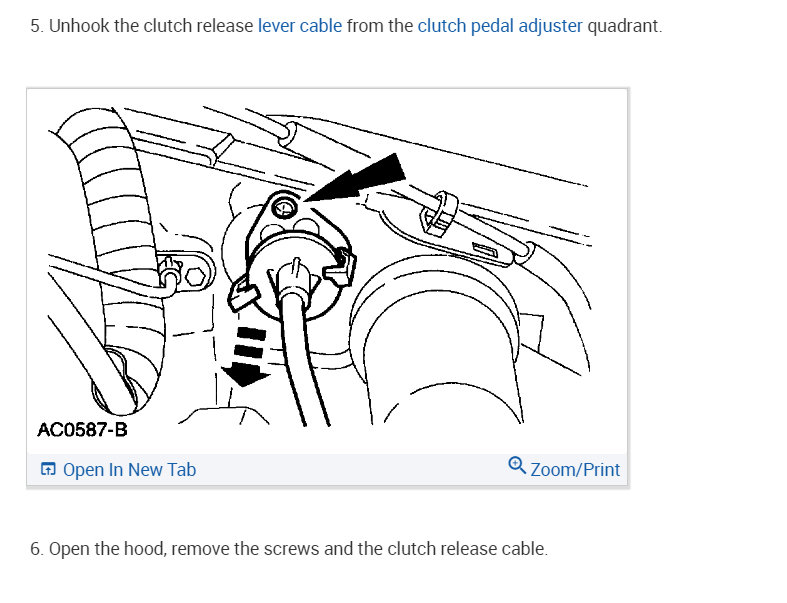

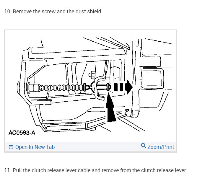

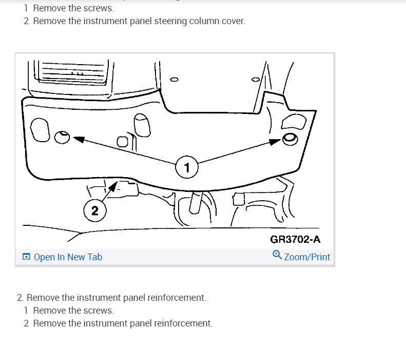

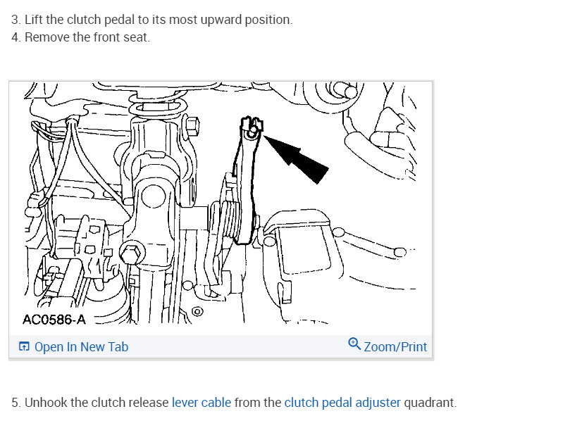

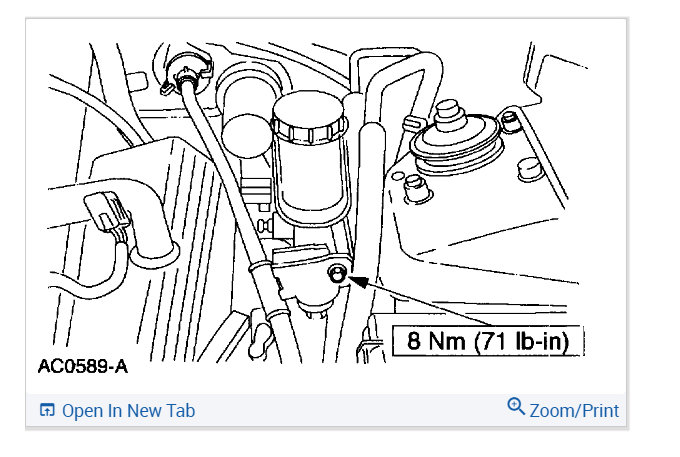

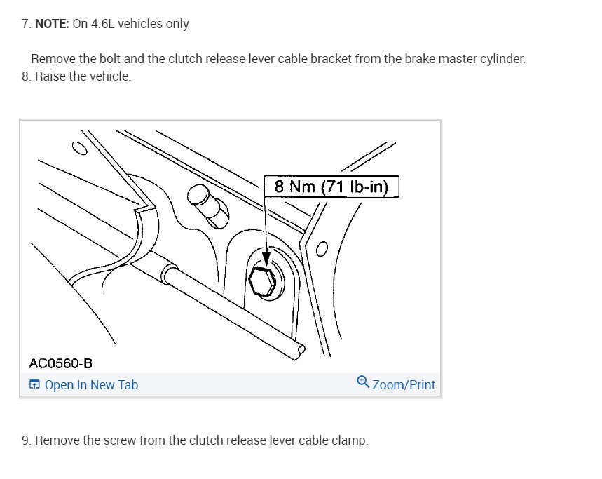

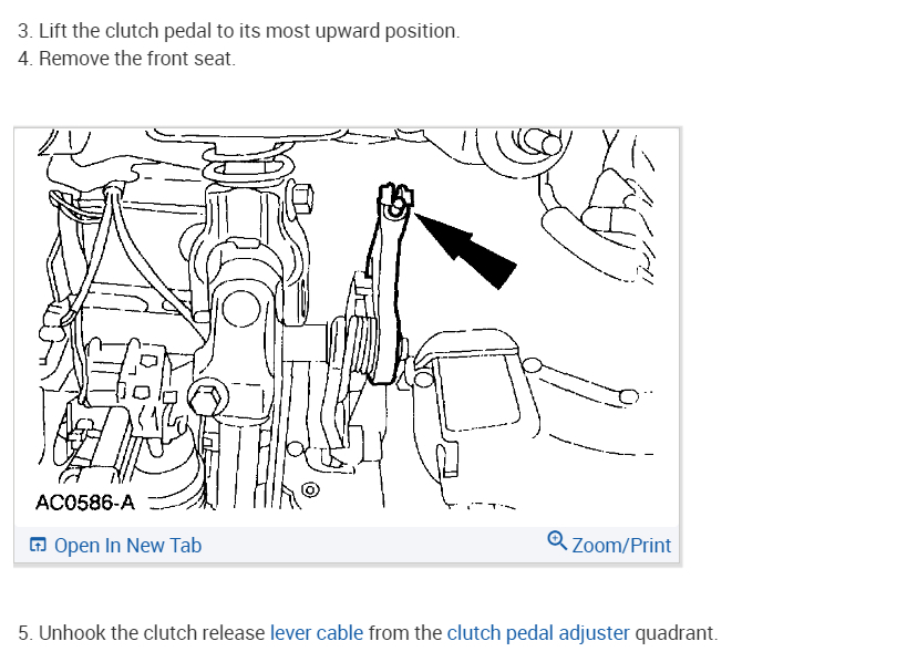

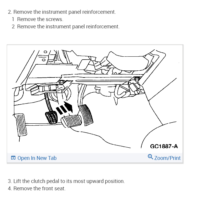

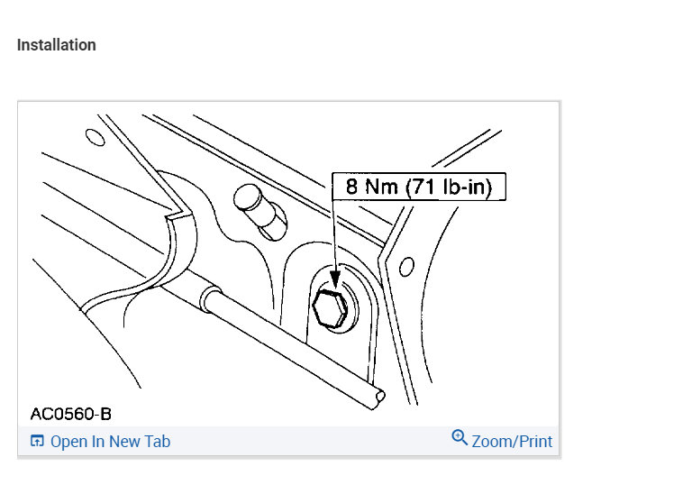

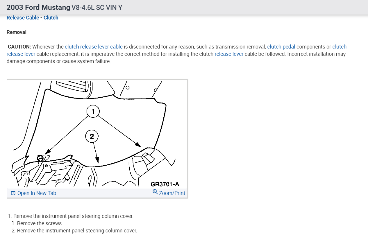

I have seen the clutch secondary cylinder fail and make noise and not return the clutch pedal, also the clutch cable can be bad that's why we need to know where the noise is coming from. Here is a video of the clutch being replaced including the secondary cylinder:
https://youtu.be/JpzefqEeVGE
Here is how to change the clutch cable out i the images below:
This can help as well.
https://www.2carpros.com/articles/clutch-doesnt-work-sometimes-or-not-at-all
Check out the instructions for the clutch cable below. Let us know what happens and please upload pictures or videos of the problem.
