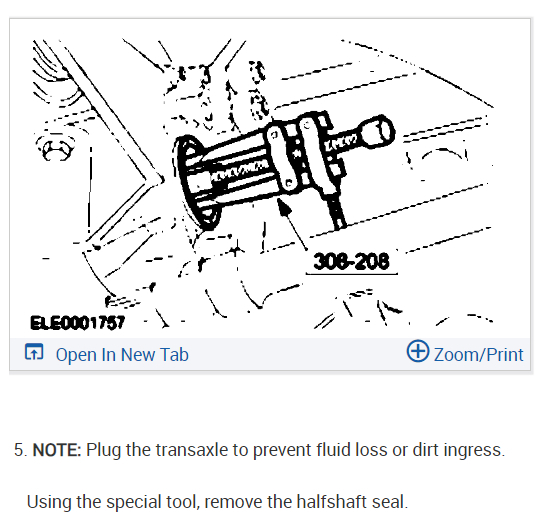

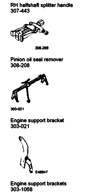

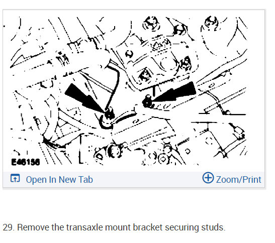

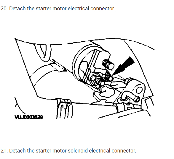

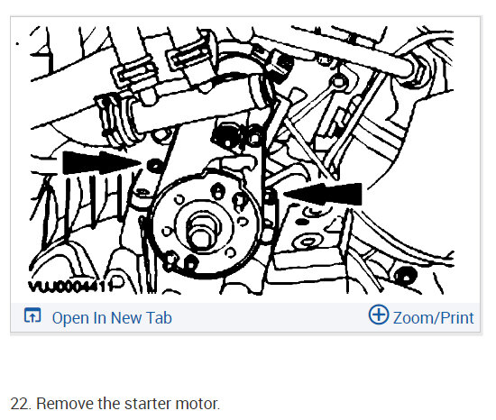

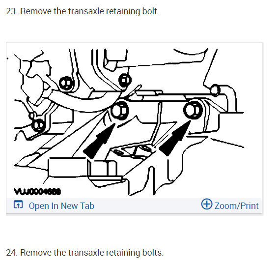

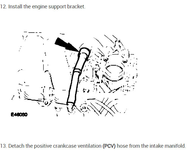

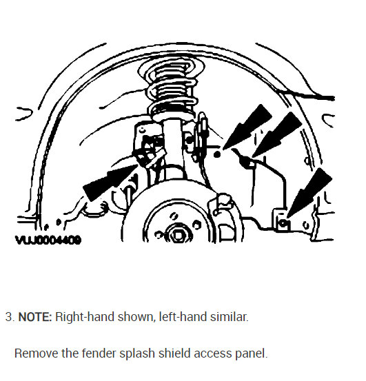

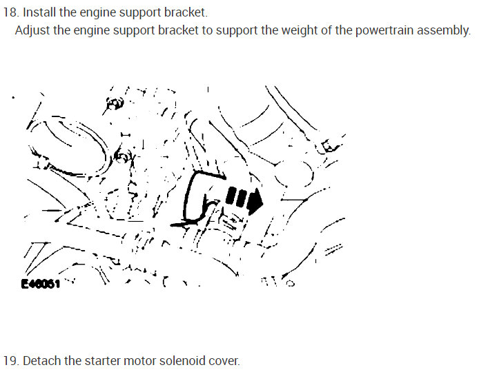

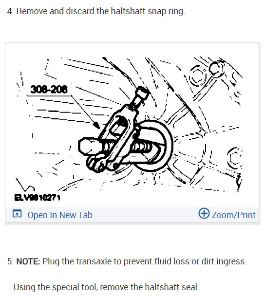

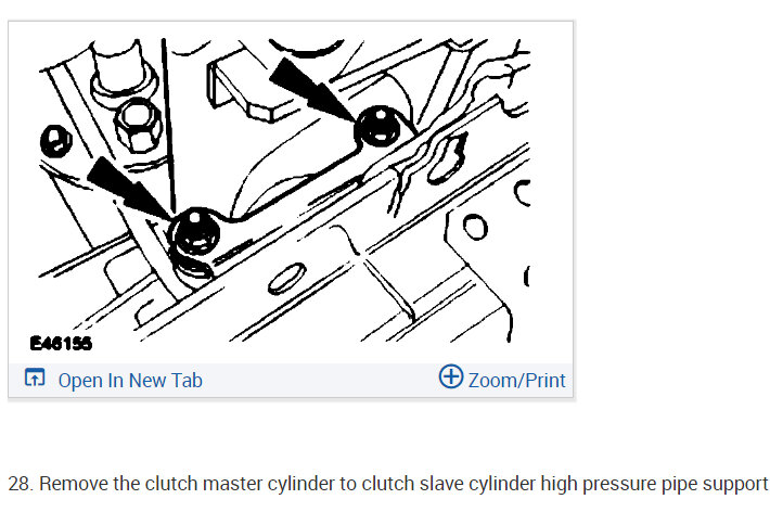

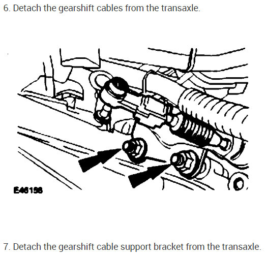

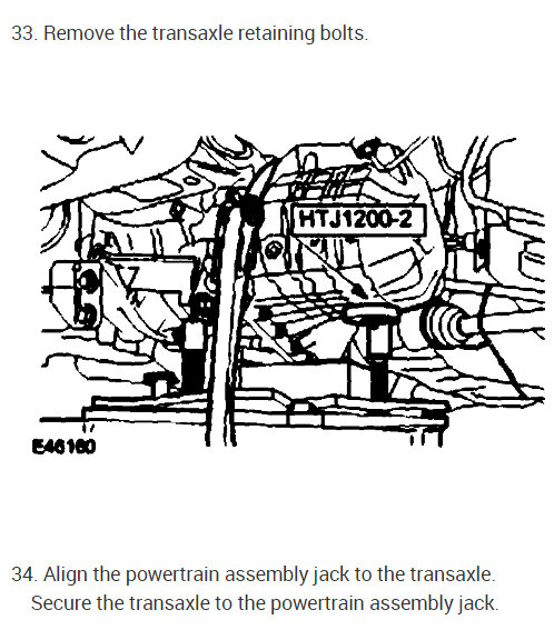

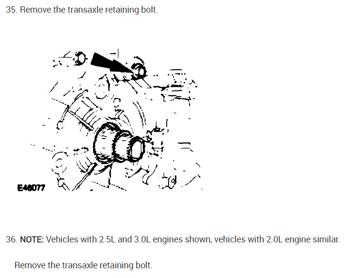

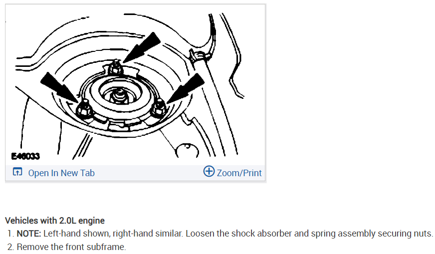

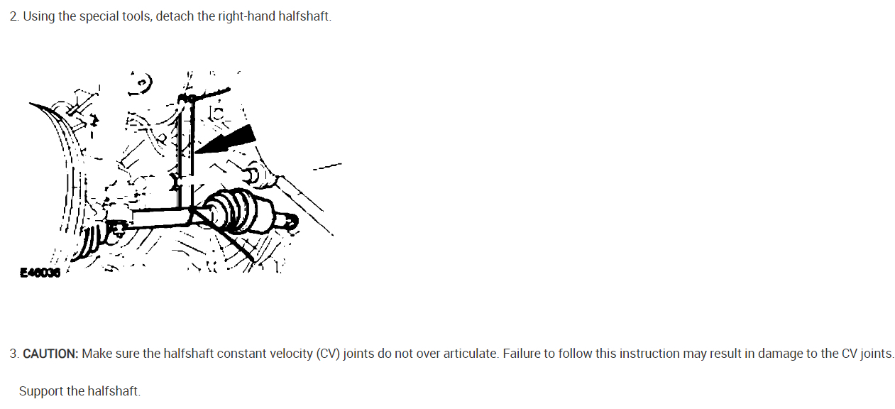

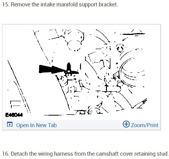

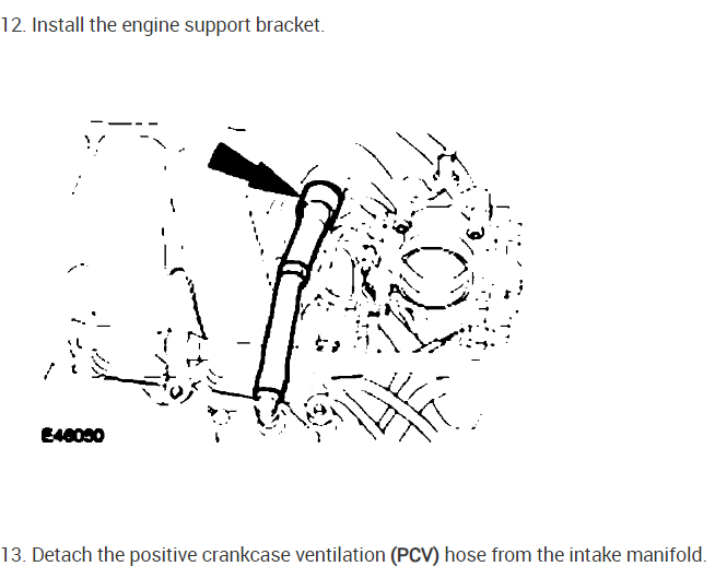

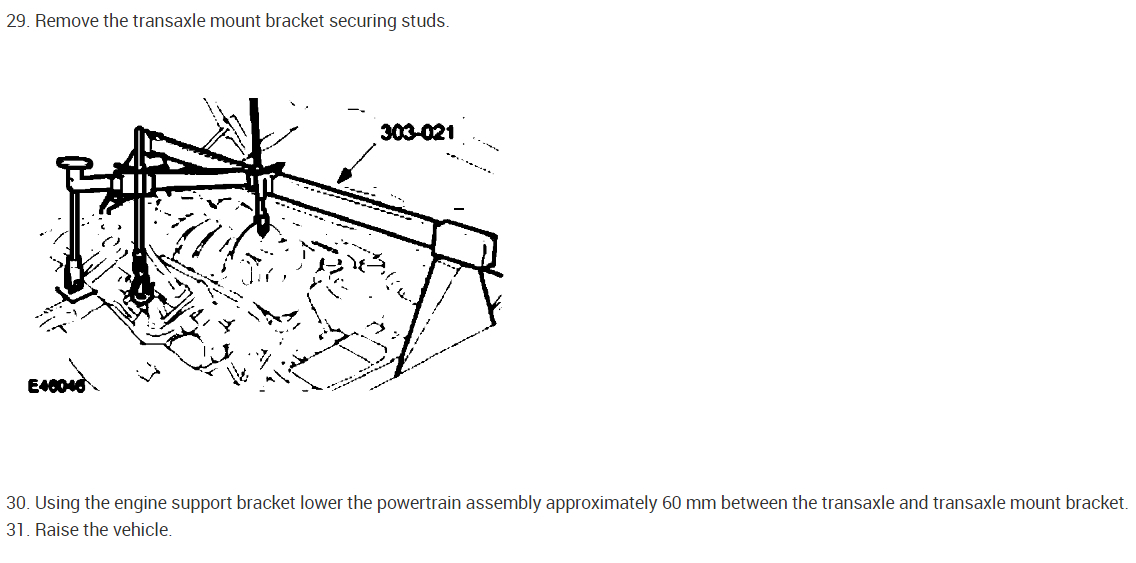

the car is driving but there is a noise hitting in the engine
Jan 29, 2015 at 7:19 AM
HMAC300
  • 48,601 POSTS
Can you please shoot a quick video with your phone so I can hear the noise? that way I can tell for sure what's going on. You can upload it here with your response.
Jan 29, 2015 at 8:13 AM
  • 54,837 POSTS

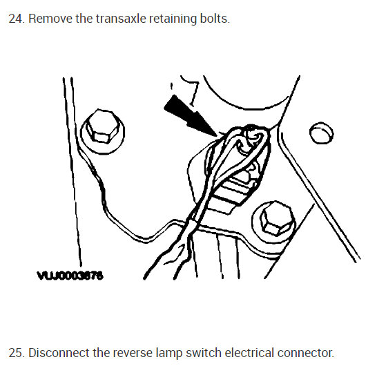

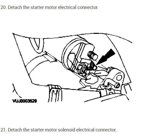

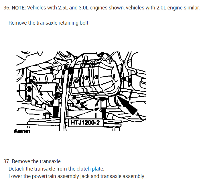

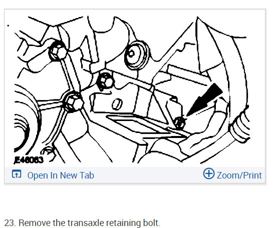

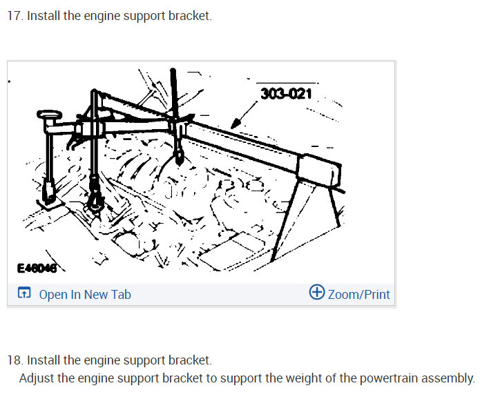

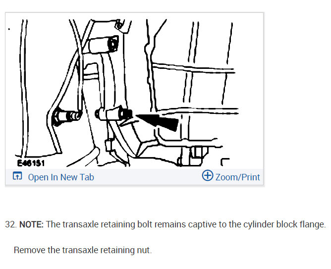

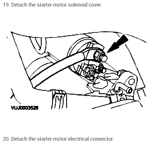

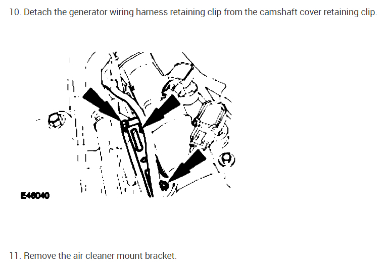

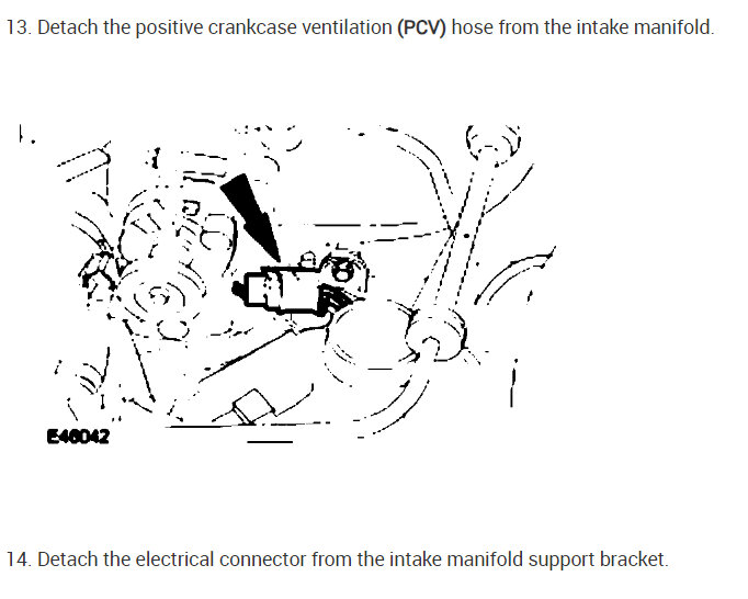

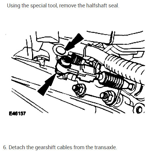

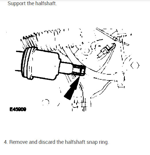

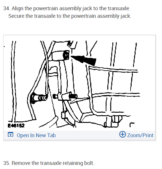

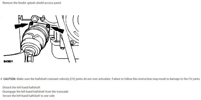

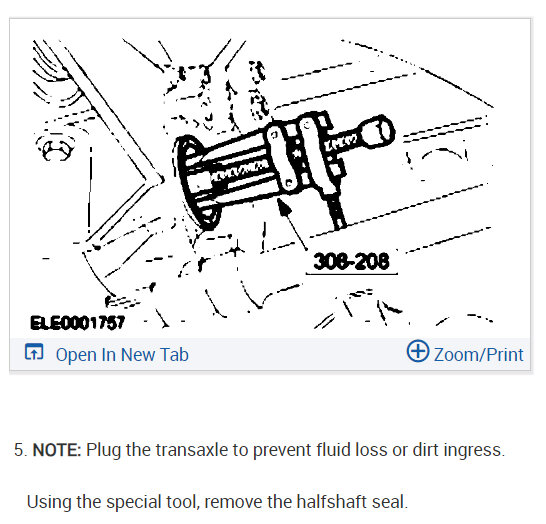

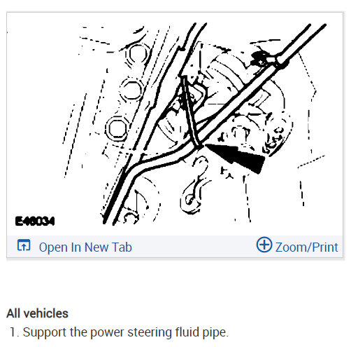

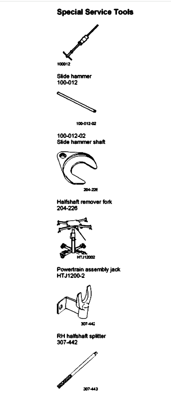

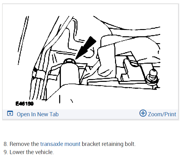

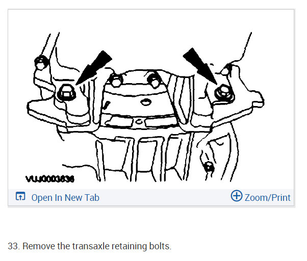

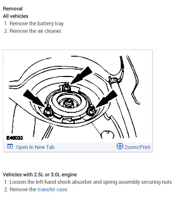

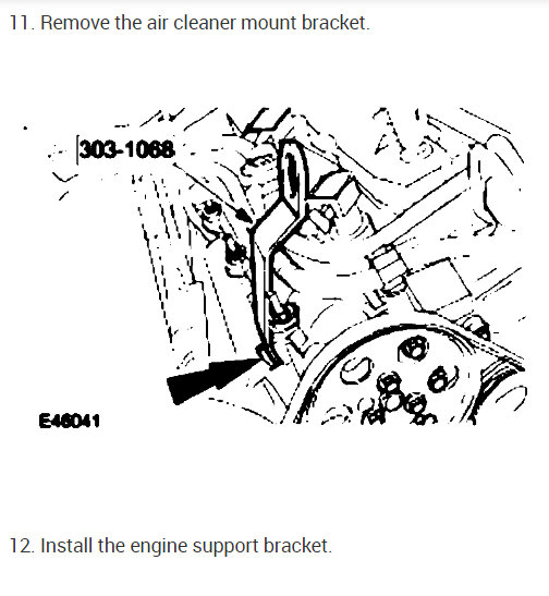

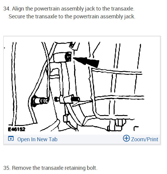

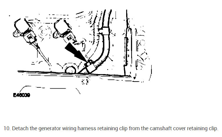

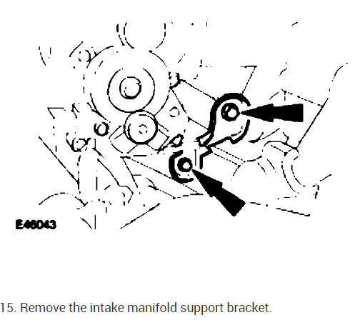

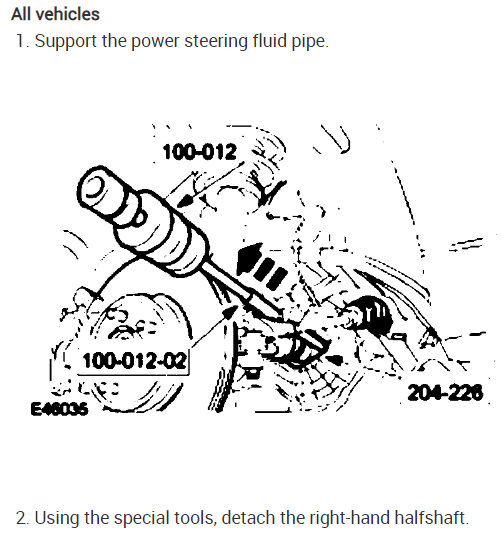

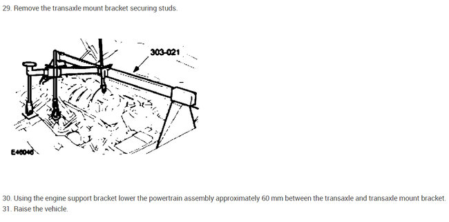

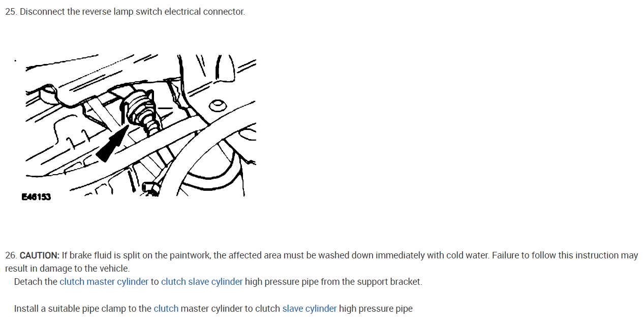

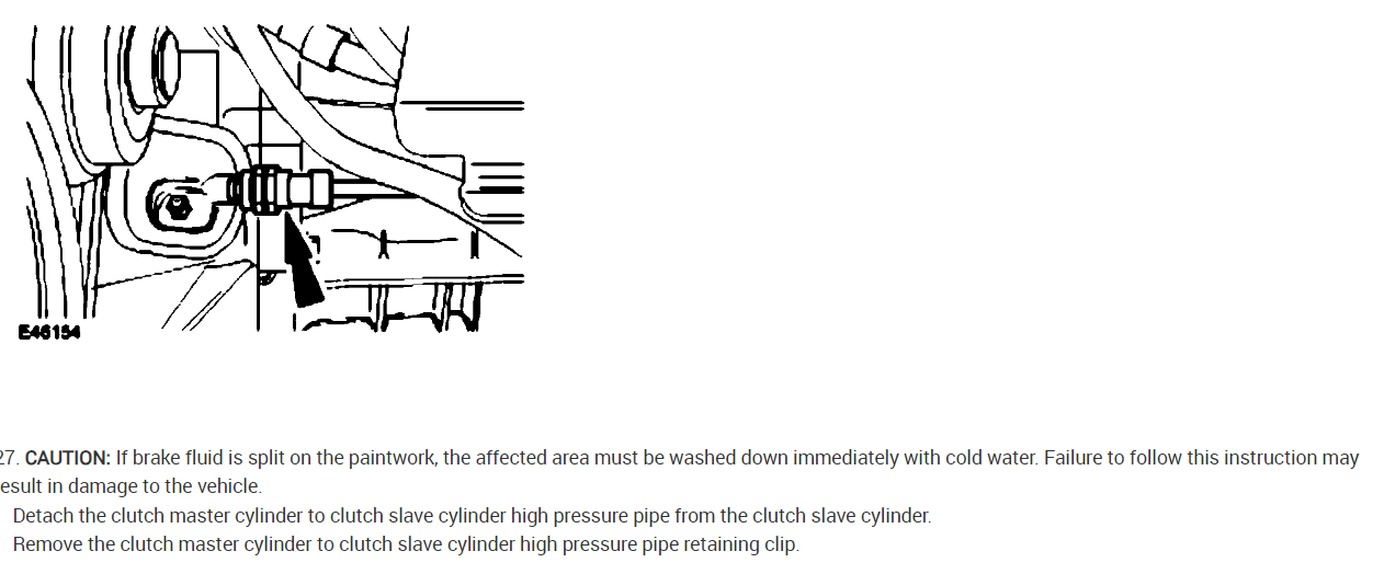

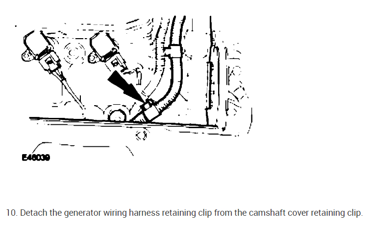

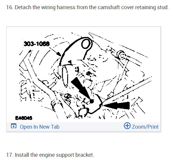

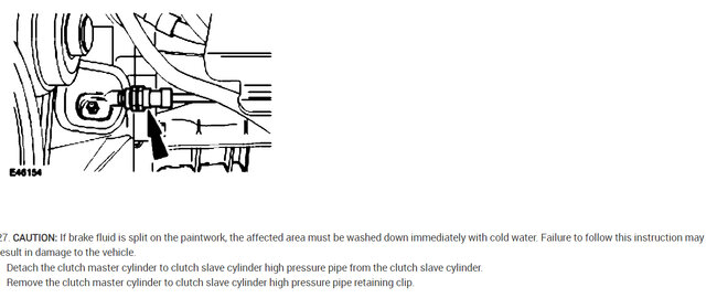

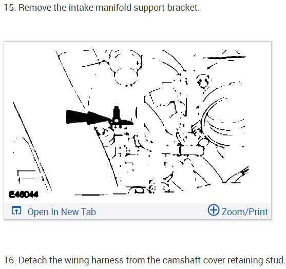

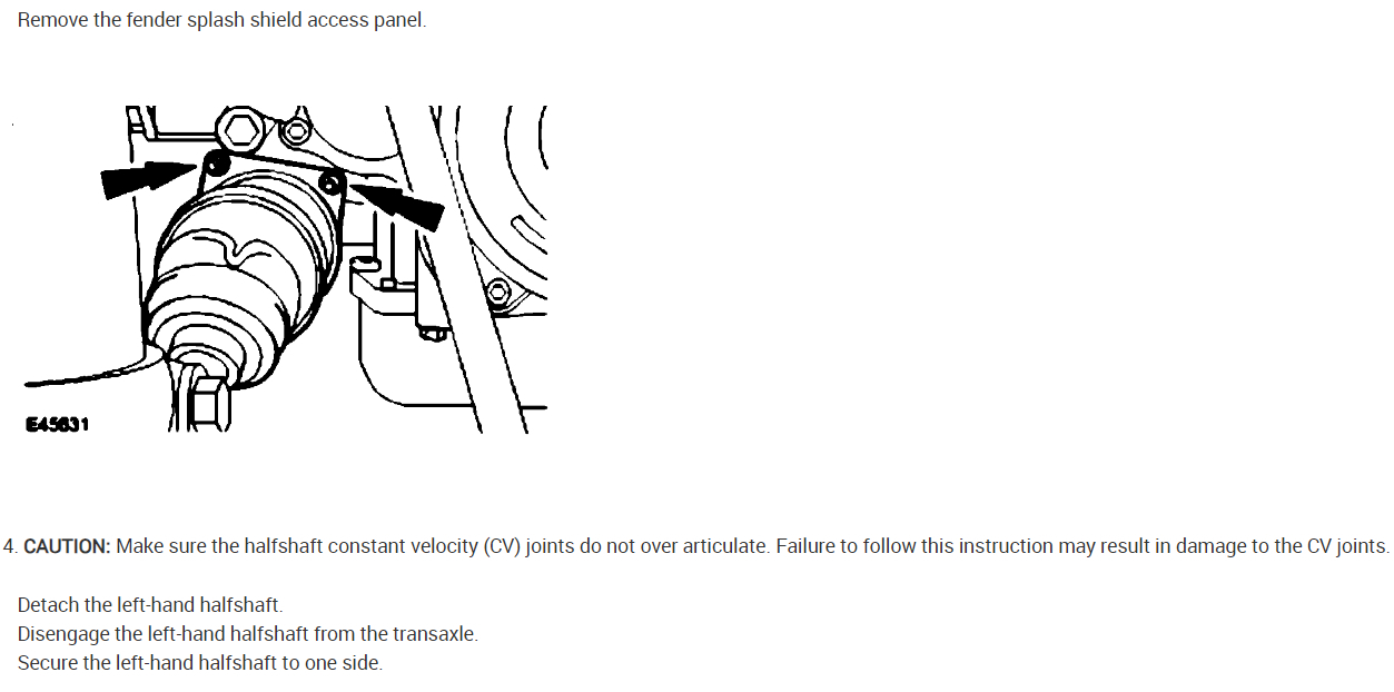

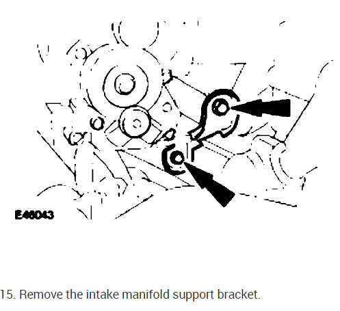

It sounds like the clutch has broken apart and pieces are rattling around the bellhousing. I would not drive the car anymore. Here is what need to be done to fix it. Check out the images (below). Please let us know what happens.
