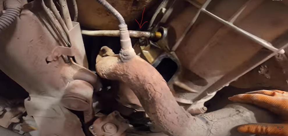

Also, take a look at the photo I have included. In it you will see the hydraulic line going to the slave cylinder. Do you line have this heat shield wrap on it?
If so, how far up does the wrap go?

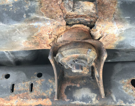

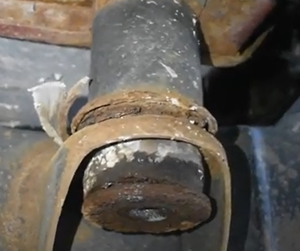

Also, how are the cab mounts? If some are worn on that side it could cause the body to pinch the line on the frame as you drive it down the road, slowly causing damage until it breaks. I added some images of examples of a bad body mount. Since the vehicle is 20 years old, if they have never been replaced, they are probably worn enough so that when you sit in it and from the bouncing from going down the road, may be damaging the line.
You might want to have someone around your body weight sit in the truck and see if it sinks down, maybe have them bounce up and down while you are watching the space between the body and the frame.
