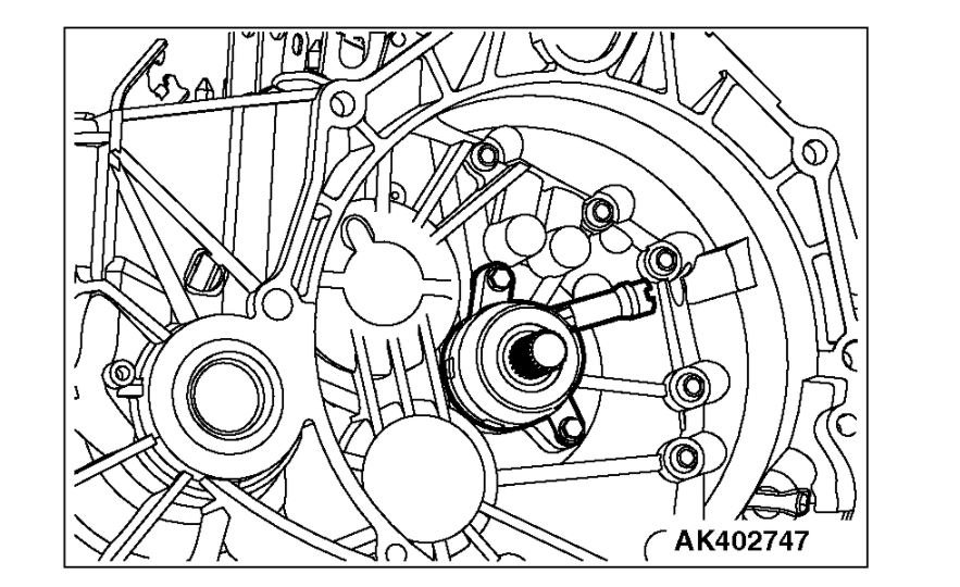

I was driving home and pulling off the highway when I tried to downshift, and realized my foot when all the way to the floor with no resistance (and there was a smell). I pulled off at a parking lot, and noticed what seems to be a puddle under my vehicle. Would I be correct in assuming it was a clutch cylinder, or do I have bigger problems?
Sep 22, 2021 at 3:26 AM
Good afternoon,

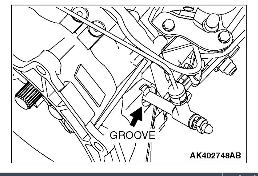

The most common failure is the slave cylinder in the transmission. The transmission must be removed to access the slave.
https://www.2carpros.com/articles/throw-out-bearing-replacement
I attached a YouTube video of the procedure for removing the transmission.
Let us know if there are any other questions.
https://www.youtube.com/watch?v=4zxyJHwxz7M
