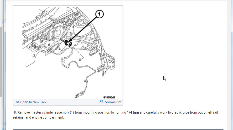

Clutch pedal easy to push can't get it in gear. possible oil leak.

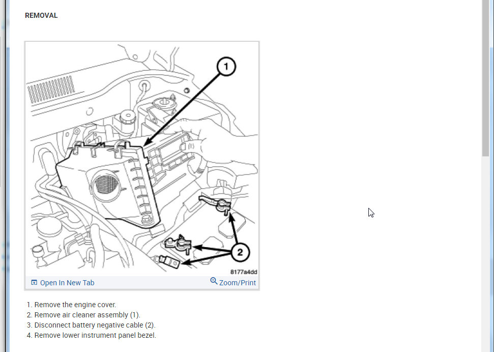

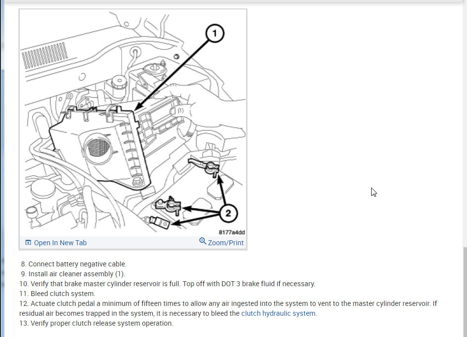

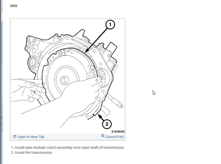

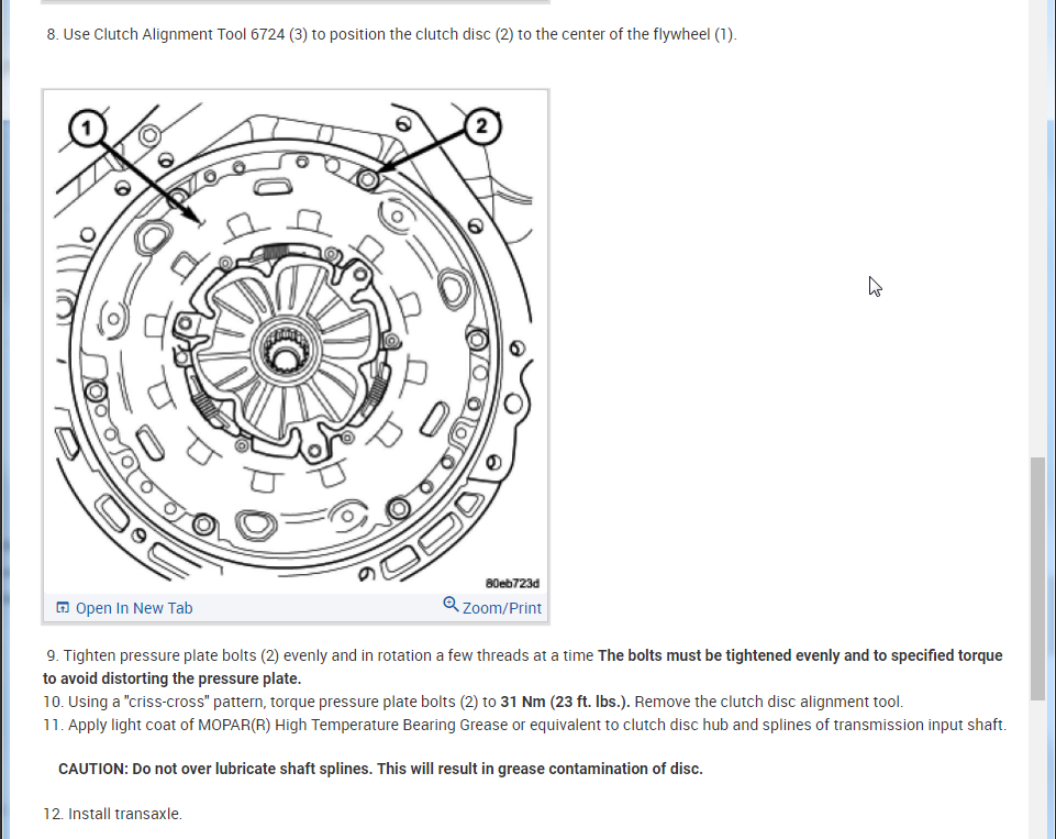

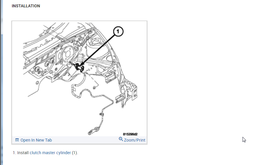

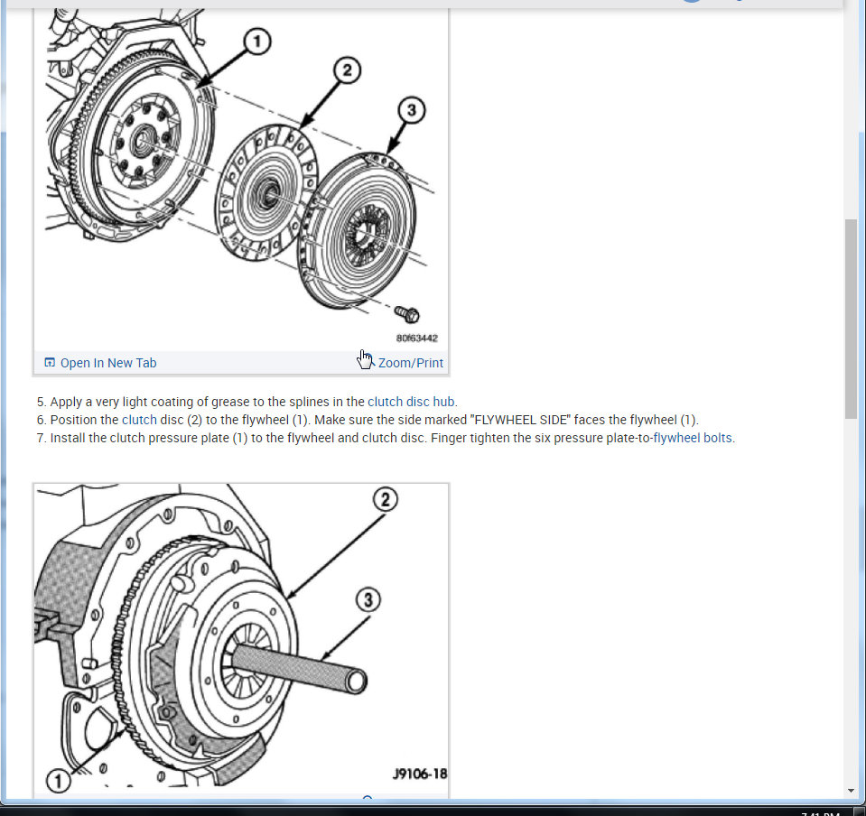

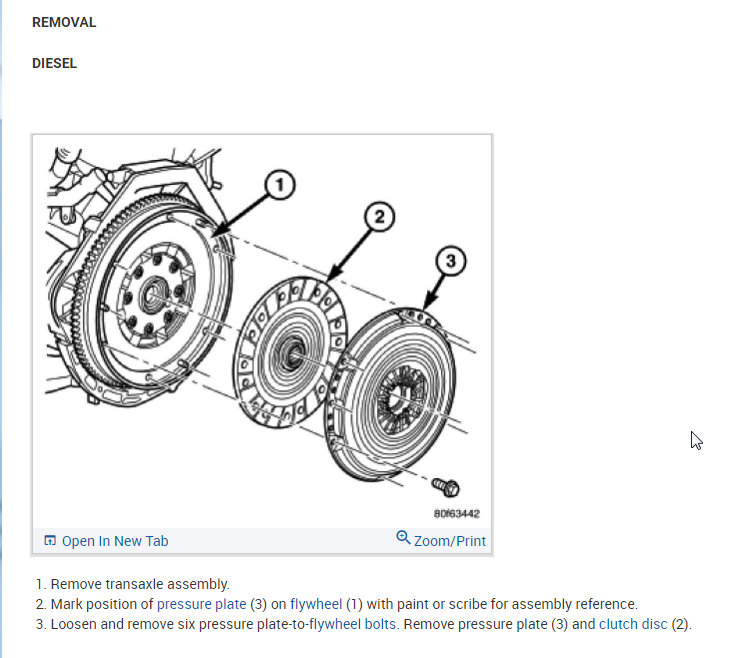

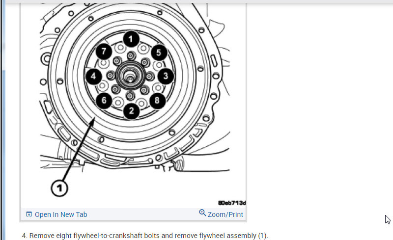

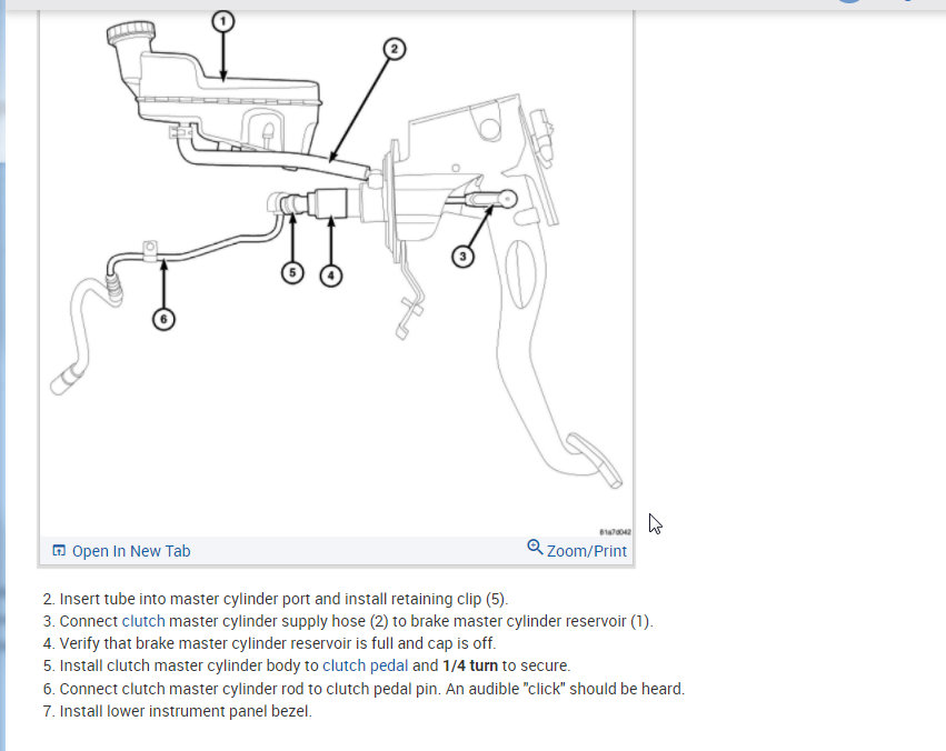

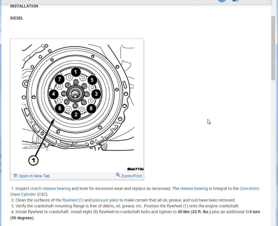

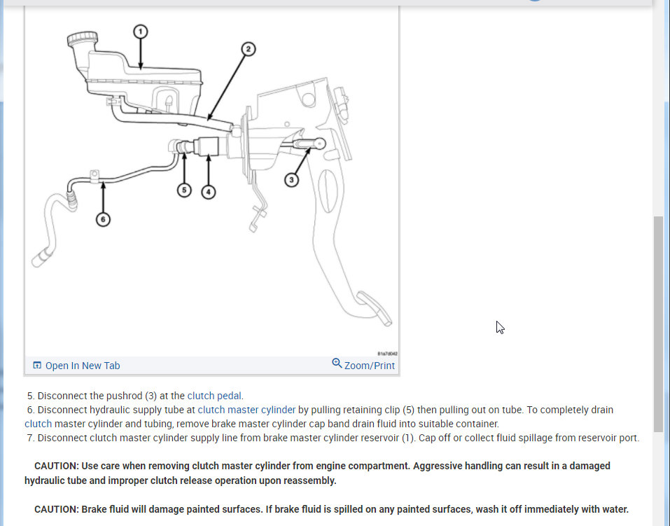

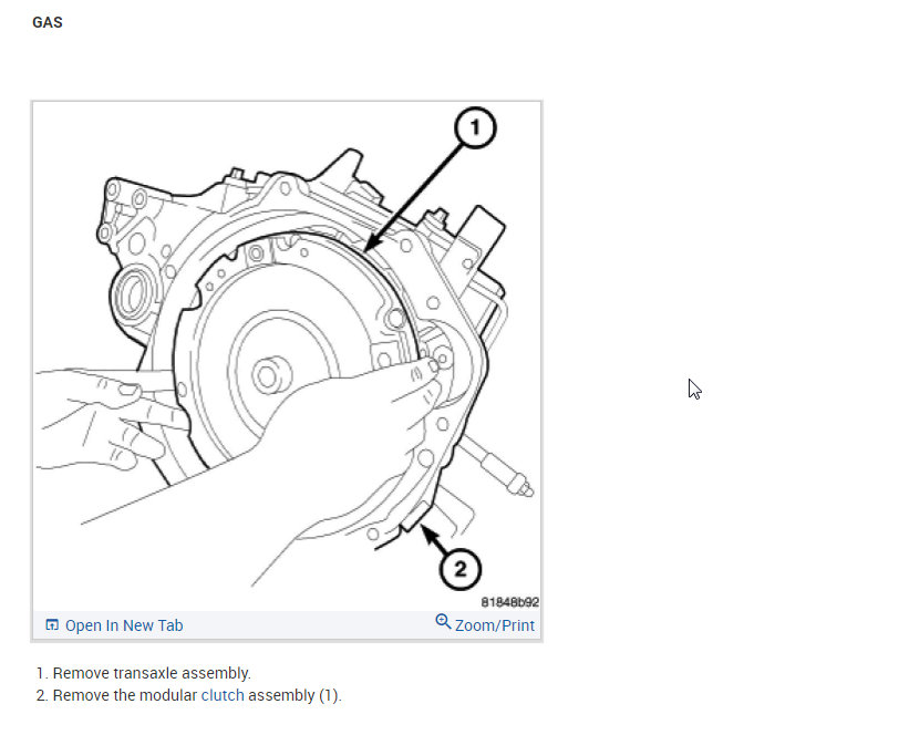

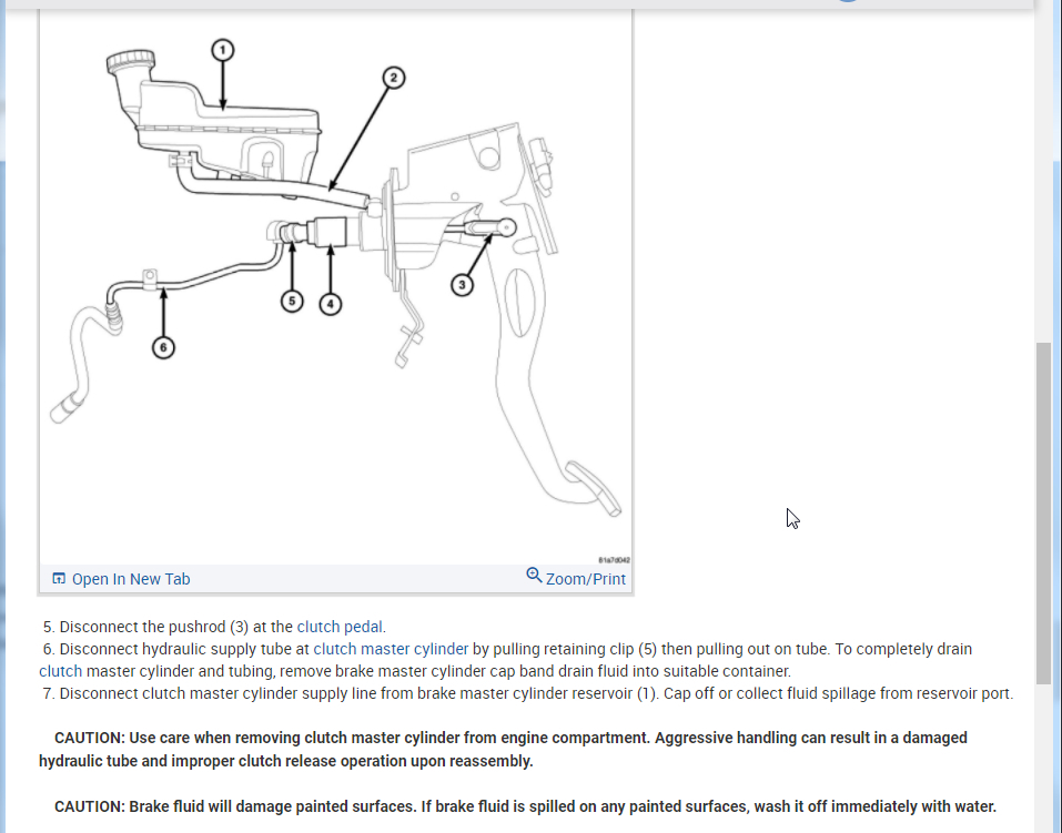

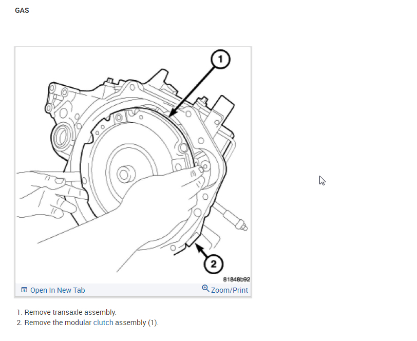

This is most likely a slave or master cylinder issue but basically the clutch is worn out and needs to be replaced. You may get away with replacing the slave cylinder but if this is in need of replacement then the clutch is going to need to be replaced as well and it is better to replace them all at the same time.
Here are some guides that will help with this:
https://www.2carpros.com/articles/clutch-symptoms
https://www.2carpros.com/articles/clutch-doesnt-work-sometimes-or-not-at-all
https://www.2carpros.com/articles/how-to-replace-a-clutch
Below is the process from the manual that will help as well.
Let me know if you have questions with this.
