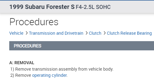

Trying to replace the clutch key.
Sep 9, 2023 at 2:46 PM
  • 110,240 POSTS

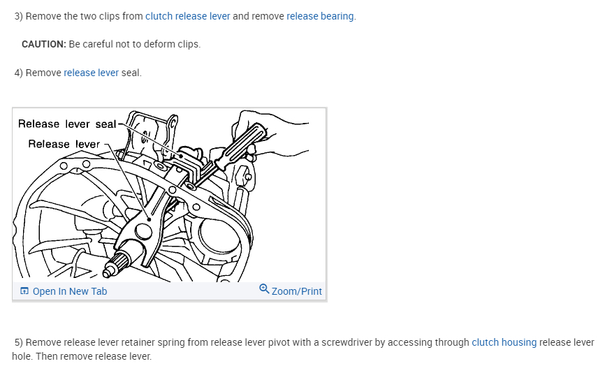

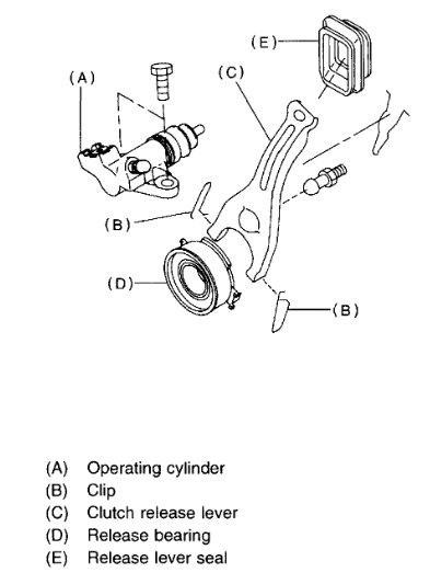

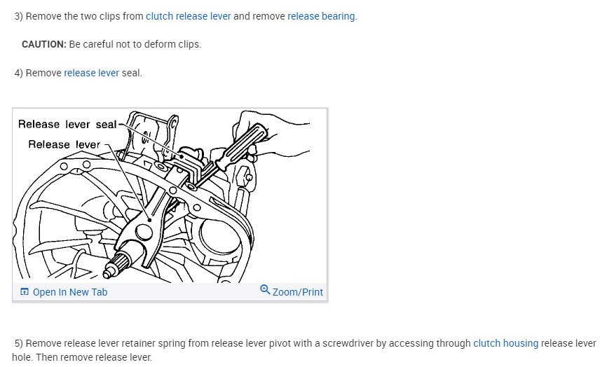

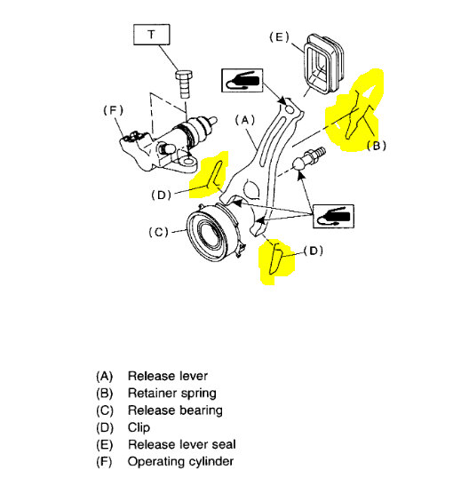

There are a few clips that hold it in place. If you look below, I attached the directions for removal. Note that the directions are for replacing the release bearing. However, they explain how the release lever is removed as well.
Take a look through them and let me know if they help.
