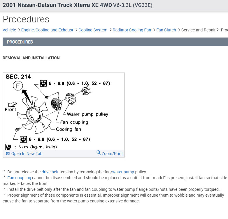

I need to know whether the bolt holding the pulley on there is regular thread or do I need to crank it the opposite way in order to remove the pulley.
Sep 19, 2022 at 2:49 AM
SQM
  • 6,383 POSTS
This should be a reverse thread. One way to tell is by looking at the direction the fan turns. To loosen the nut you want to go the direction the fan spins.
Here is a helpful guide:
https://www.2carpros.com/articles/fan-clutch-removal
See attached diagram for torque specifications.
Let me know of any questions.
