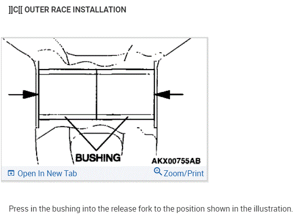

Just put in a new clutch fork along with master cylinder and slave cylinder. With the car not running you can put it in any gear with no problem. But when you start the car that goes way, and you cannot put it in gear. If you force the shifter into first the car starts to move even though the clutch is pushed in.

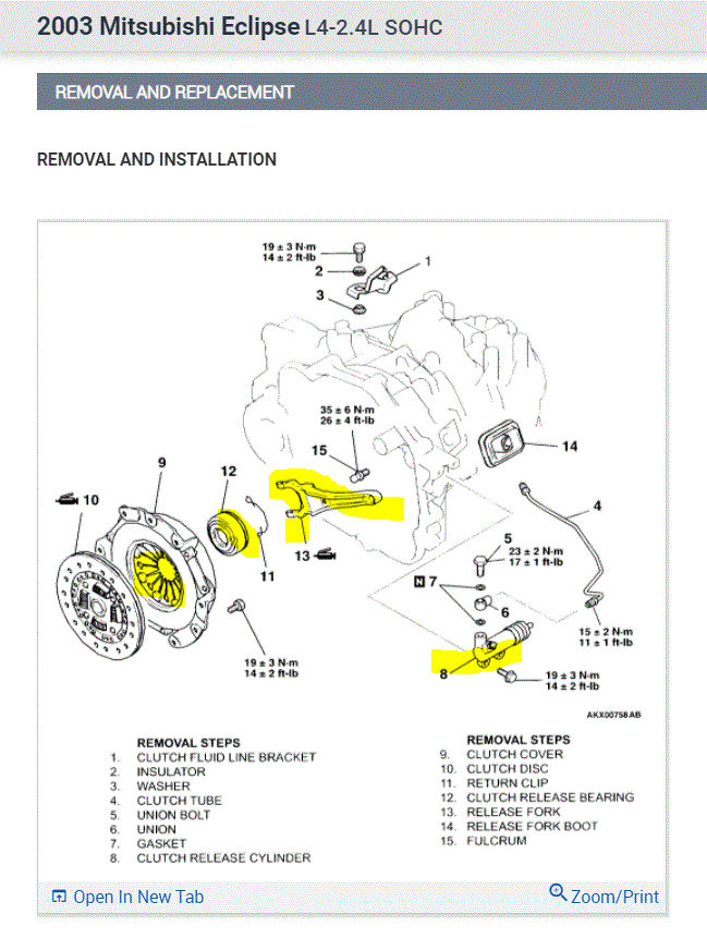

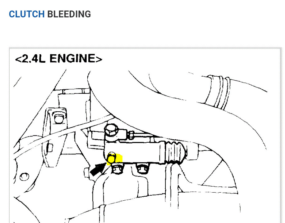

The clutch isn't releasing the transmission and engine. When you installed the new hydraulics, did you properly bleed the system?
The bleeder is on the slave cylinder. See pic 1. Have a helper pump the clutch about 5 times. Then, while you hold the pedal at the floor, open the bleeder until no air comes out.

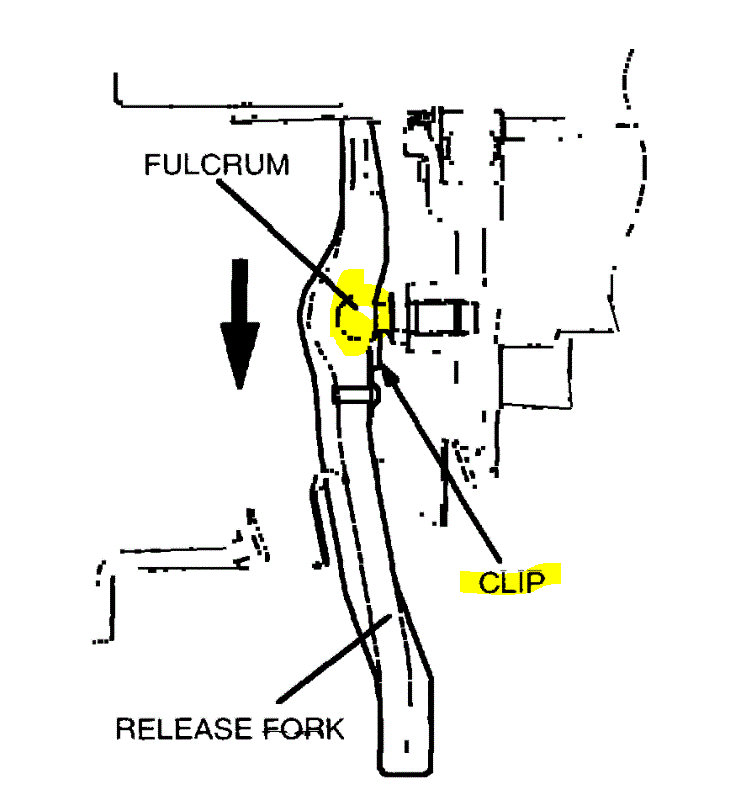

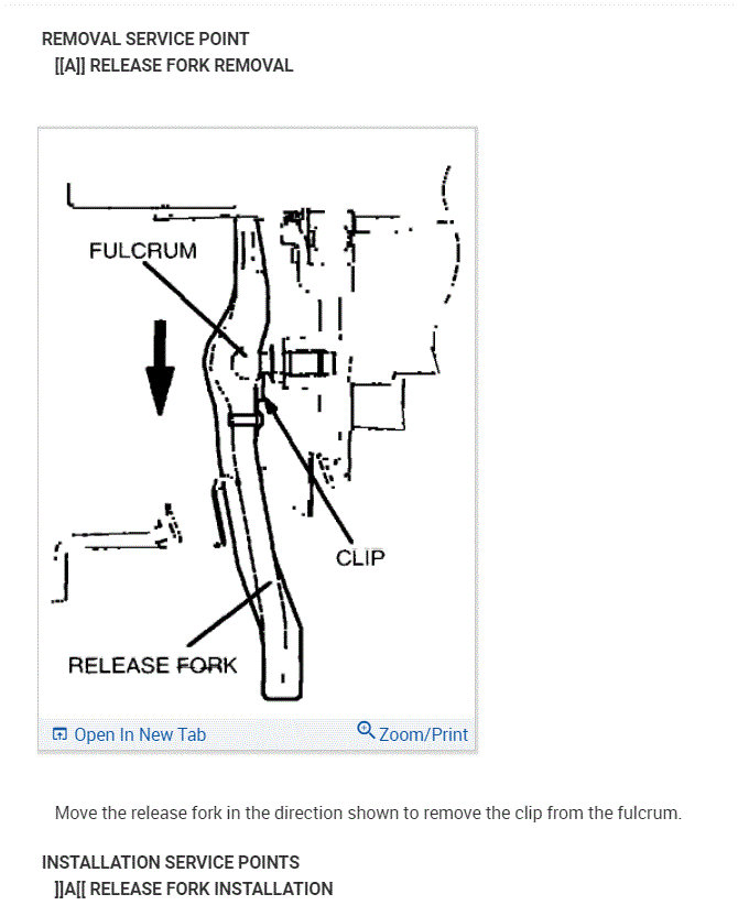

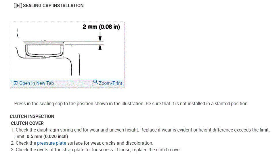

Also, check for leaks and make sure the new fork is properly attached at the fulcrum. See pic 2.
Let me know what you find.

When the engine is off, there is nothing preventing it from shifting. Once it's started, then the clutch separating the transmission from a moving flywheel is needed. That is why it won't shift.

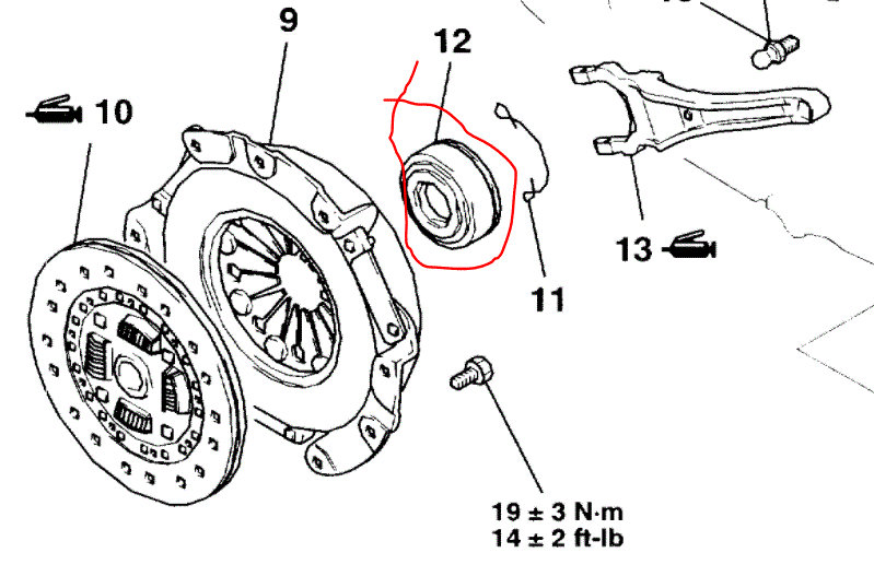

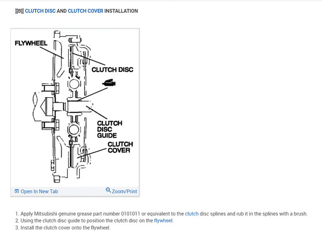

When you had the transmission out, did you replace the pressure plate, clutch disc, and release bearing? See pic 1 below. Also, did you use a clutch alignment tool to align the clutch disc, flywheel, and pressure plate cover before tightening the pressure plate?

Okay, do me a favor. Have a helper depress the clutch while you watch where the slave places pressure on the release fork you replaced. See if you notice movement. There is a chance you have a bad (new) master cylinder or slave cylinder.

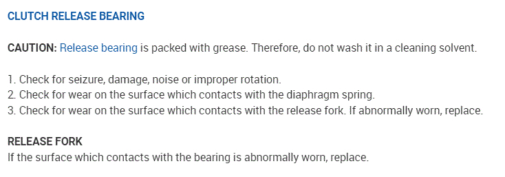

If everything was in good condition, then either something was reinstalled incorrectly (release bearing), the pressure plate release was damaged, or we are missing something really simple. If the slave is moving the clutch fork, it should be pressing the release bearing against the pressure plate and taking pressure off the clutch disc via the pressure plate. That disengages the engine and transmission allowing you to shift. Something is preventing a simple process from happening.

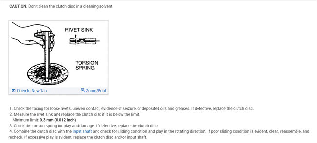

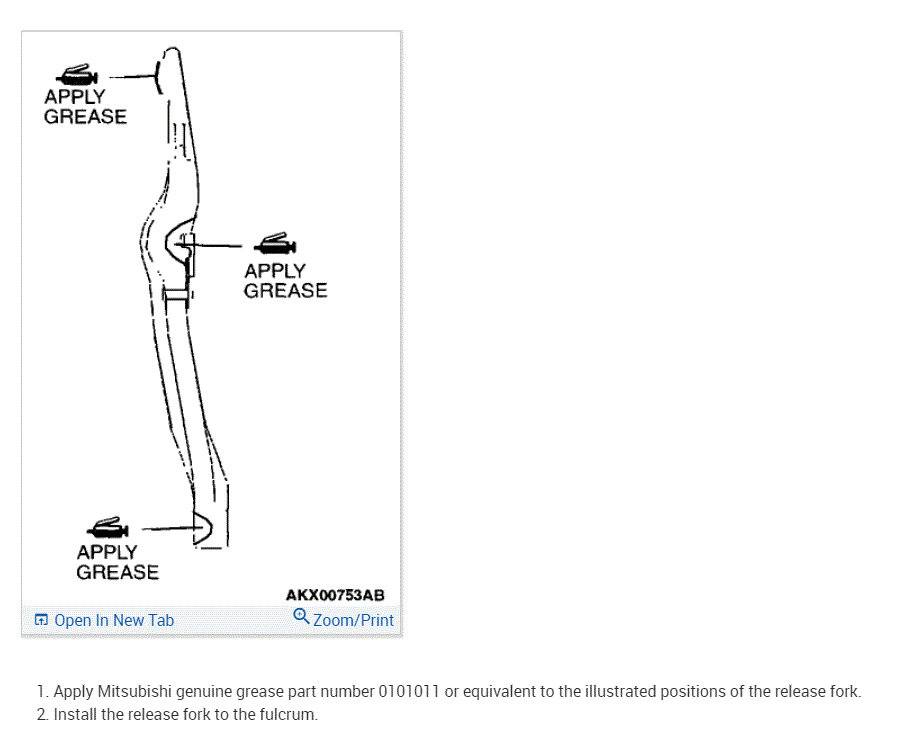

I attached the directions below for the replacement of the clutch disc. Read through them and see if there is anything you may have missed.
