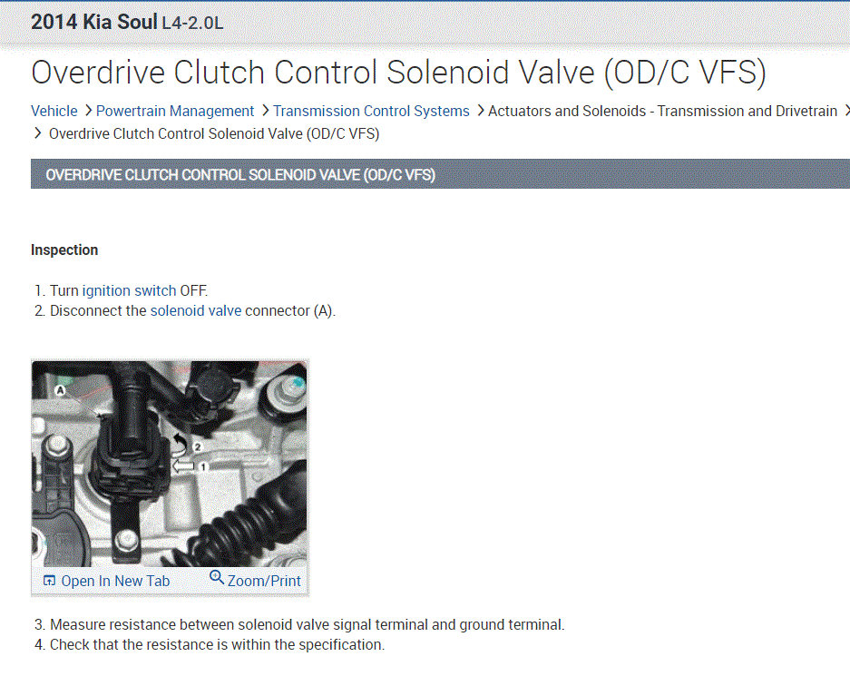

I would be happy to help. I am going to provide the directions for replacing it. This is for the overdrive clutch control solenoid. If you have a diagnostic trouble code, let me know what it is so I can confirm we have the right part.
If you look below, I attached the directions. Let me know if this helps.
Take care and let me know if you have questions or need help.

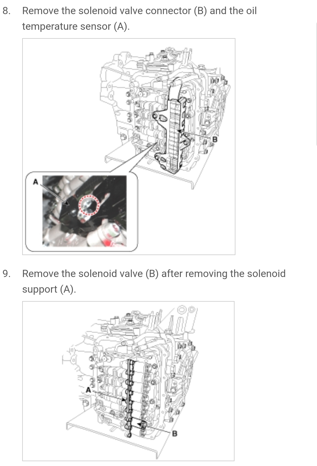

I am actually still having trouble getting the solenoid valve connector off, or maybe I am just reading the schematic incorrectly. Could I impose further?
Aug 30, 2021 at 12:30 PM
  • 110,244 POSTS
You can impose anytime. LOL The connector can be a bit difficult. If you look at the pic above, follow the arrows. Push to the left and then turn the lock.
Let me know if you get it. Also, please never feel you impose. I'm glad to help (if I can). LOL

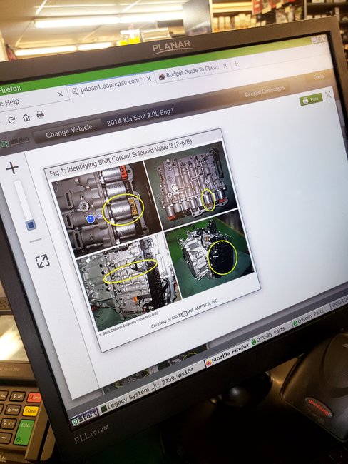

I am referring to the image below at left that is referred to by the same name, enlarged at right.
Thanks again!

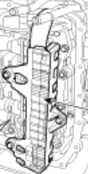

  • 110,244 POSTS
Marcus,

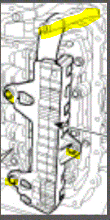

I'm struggling to identify what I'm looking at in the pics. When I enlarge them, they become blurry for me. Looking at pic 2, it looks like that is bolted. Am I correct?
I copied the pic you attached. I highlighted the bolts and what appears to be the dipstick tube. Explain what is happening.
Aug 31, 2021 at 10:15 AM
MARCUS CARTER
  • 12 POSTS
I can see your difficulty, however I have been able to get the object in question off and the solenoid valve off and replaced. My last job will be to reassemble all of these pieces, refill with new fluid and see how she runs. (Any other precautions that you may have about that process may come in handy, just saying, lol) I can refill it with gasoline, right?

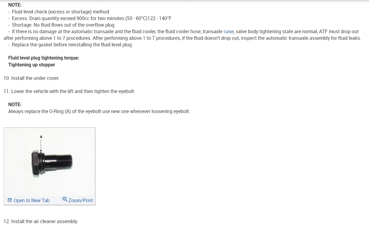

When I look up diagnostics, here is the sequence it gives me for diagnostics:
1) Check transmission fluid and level.
2) Wire harness inspection for damaged pins at connections.
3) Measure the oil pressure of each solenoid oil line by using an oil pressure gauge.
4) Inspect shift solenoid C.
You have done so much already. Where would you feel most comfortable starting? Were the wiring harnesses checked and wiring?
Sep 8, 2021 at 1:36 PM

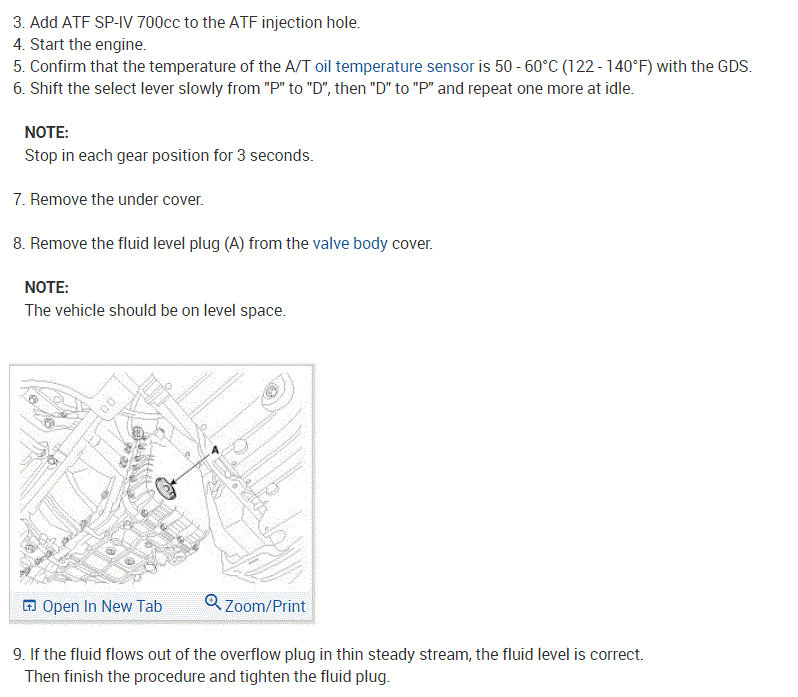

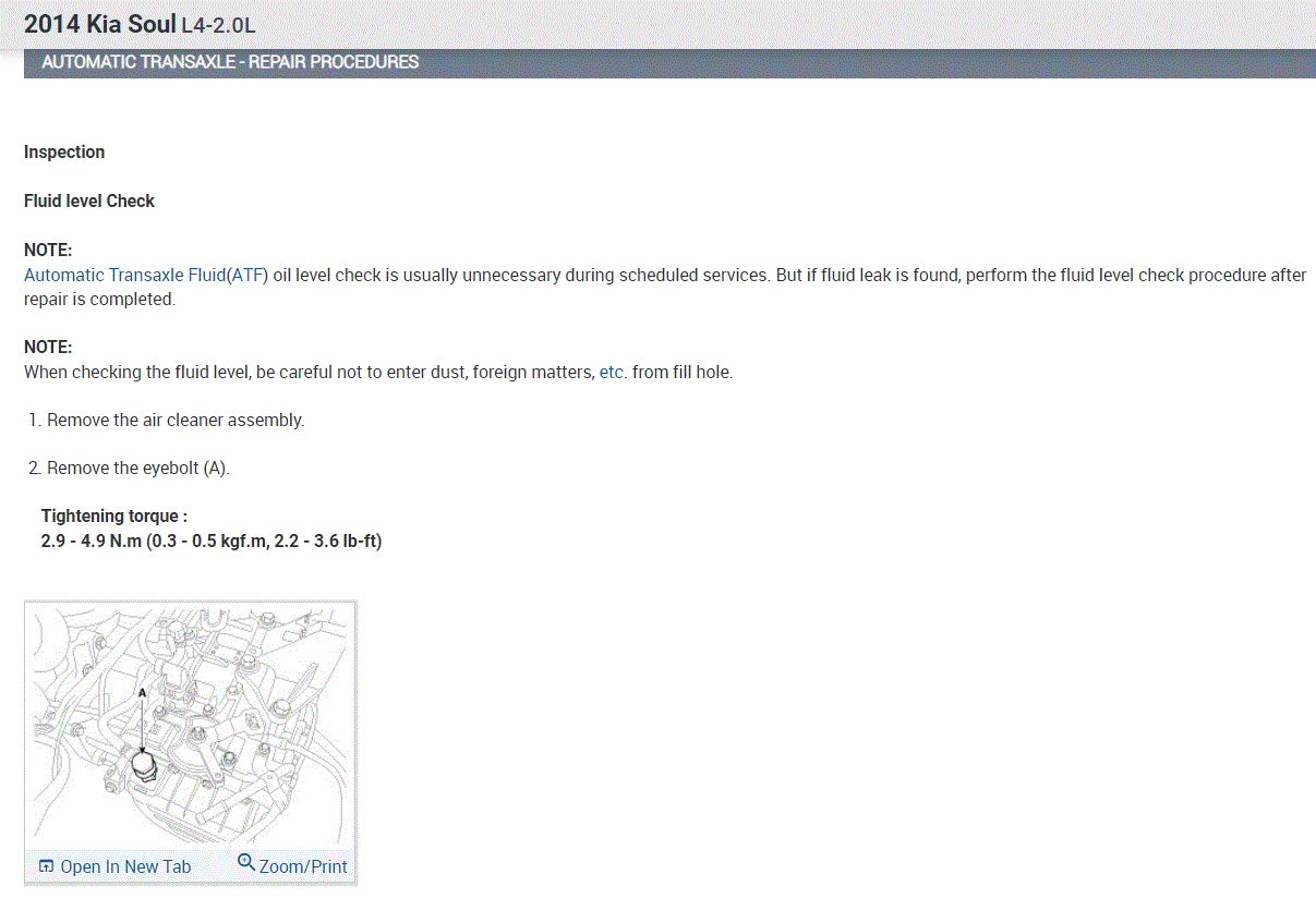

  • 110,244 POSTS

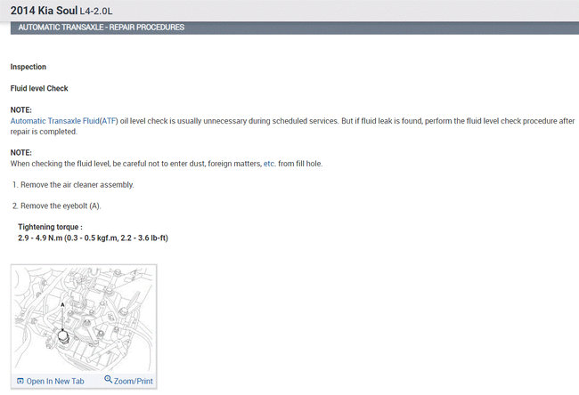

The transmission fluid is checked with the engine running and at operating temp. There is a plug on the side of the transmission that is removed. Once removed, there will be a small steady stream of ATF coming out if it is full. If it's low, then nothing will leak and it needs to be filled until there is some coming out. I attached the directions below.
Next, the pressures are in the future if needed. I can help with that. Try what you suggested with the part. Hopefully, that will take care of the problem.

MARCUS CARTER
  • 12 POSTS
I put in a whole gallon of fresh fluid, and never a drop came out.
Sep 9, 2021 at 8:35 AM
  • 110,244 POSTS
Did you check the fluid level on the side of the trans? Was the engine running and at operating temperature?
If you added fluid and nothing came out, it's still low.
