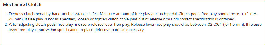

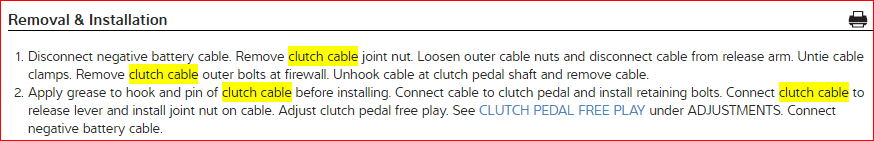

I replaced my cars clutch, so I dropped the transmission and reinstalled that.
The only item I have left is reinstalling the clutch cable which I cannot seem to figure out. No matter what I try the pedal still drops to the floor.

Hello, I am Danny,
I have attached two pictures showing how to change the cable and how to adjust the pedal free play. Hope this helps and feel free to ask any questions. Thanks for using 2CarPros.
