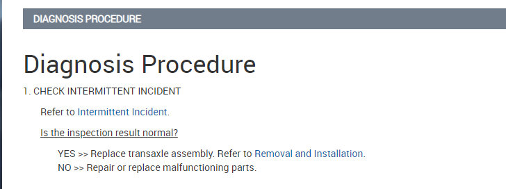

I am assuming this is a code that you have but can you provide the actual code that you have as they list them by the number and not the description.
Let us know and we can get you the specific info you need to figure this out. Thanks
Feb 20, 2021 at 7:10 AM
JESSICA3
P285A.
Feb 20, 2021 at 7:39 AM

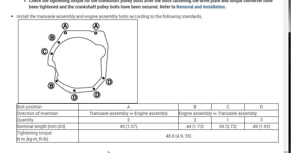

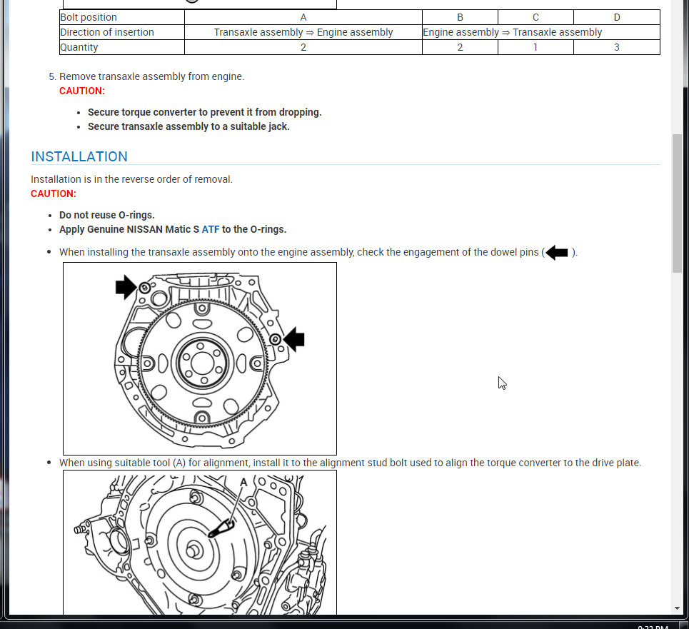

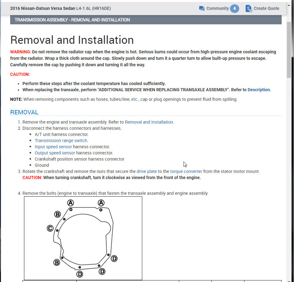

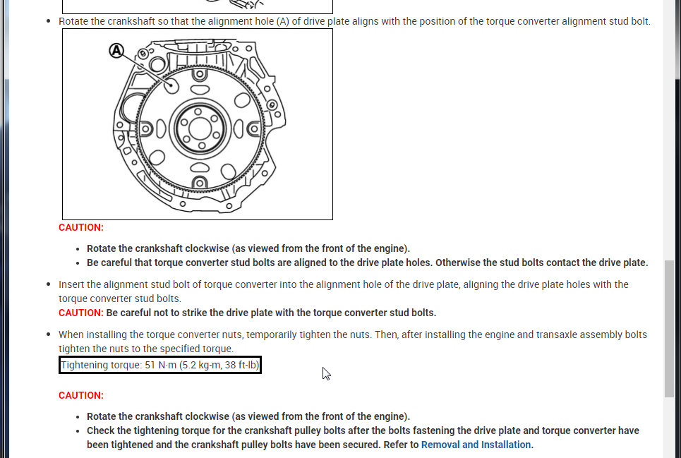

That is unfortunate because Nissan does not give any testing or repairs for this code. They literally tell you to replace the transmission. So I attached the process from the manual below.
Here is a guide that will help with this as well:
