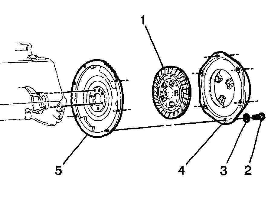

5. Mark the flywheel (5) and a clutch pressure plate lug for the installation alignment.
6. Remove the bolts (2) and the washers (3). Secure the clutch pressure plate (4) and the clutch driven plate (1) to the flywheel (5).

pic 2
1. Install the bolts (2) and the washers (3) that secure the clutch pressure plate (4) and the clutch driven plate (1) to the flywheel (5).

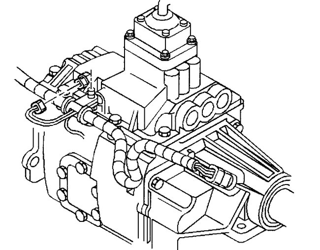

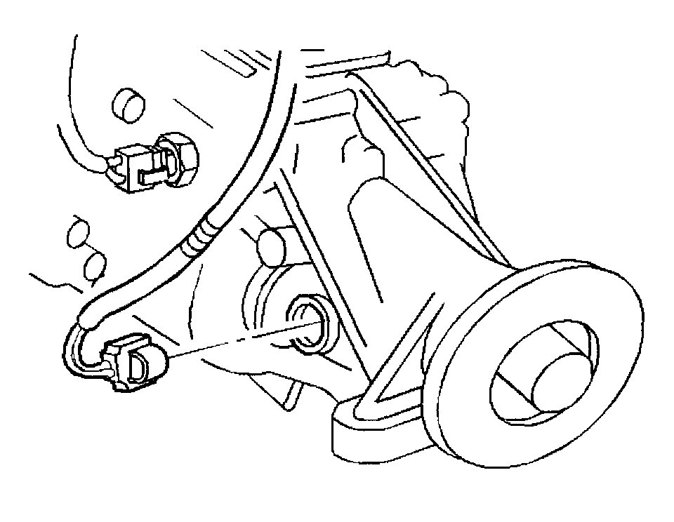

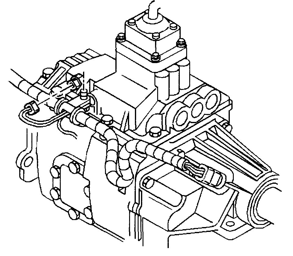

pic 3

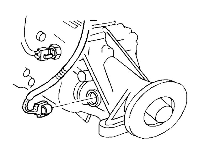

7. Disconnect the wiring harness connector from the vehicle speed sensor.

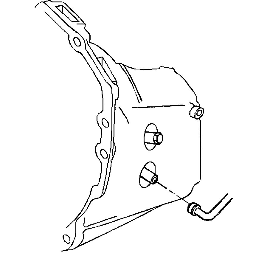

pic 4
8. Disconnect the wiring harness connector from the backup lamp switch.
9. Disconnect the wiring harness retainers from the transmission.

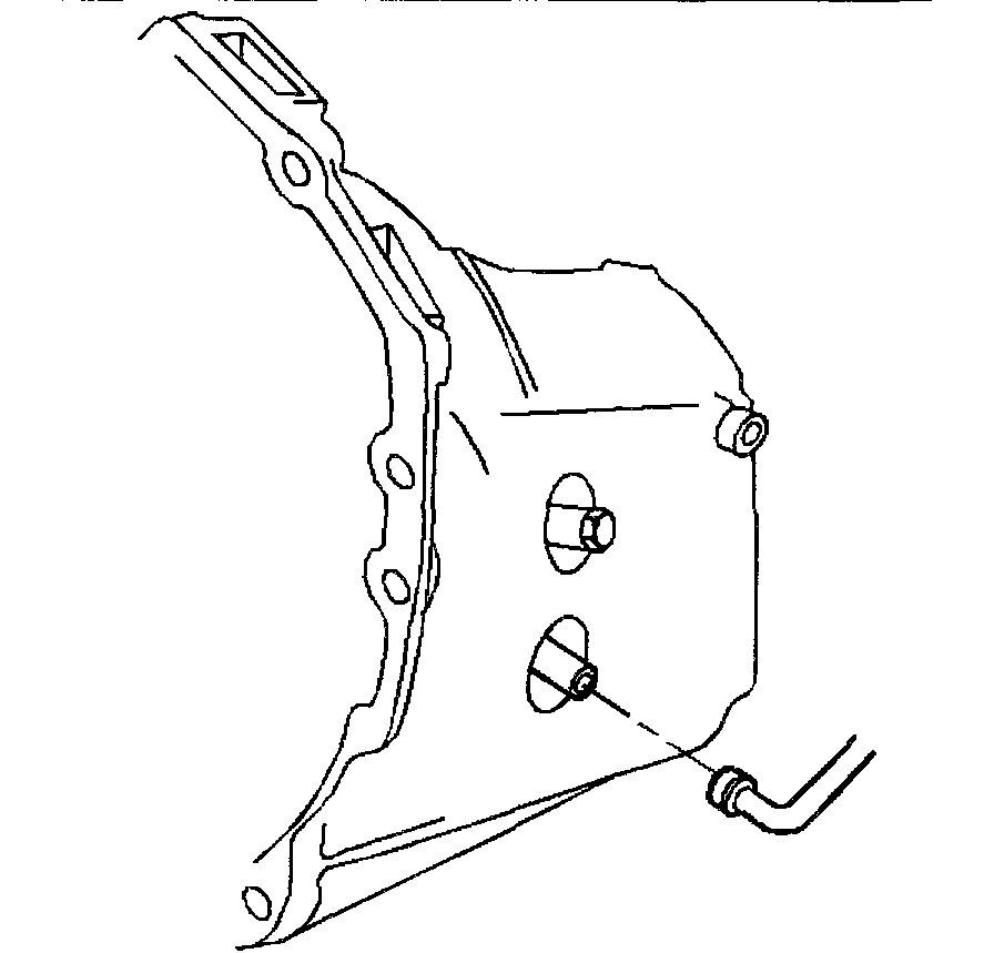

10. Use the J36221. Depress the white plastic sleeve on the quick connect in order to separate the hydraulic clutch line from the concentric slave cylinder quick connect.

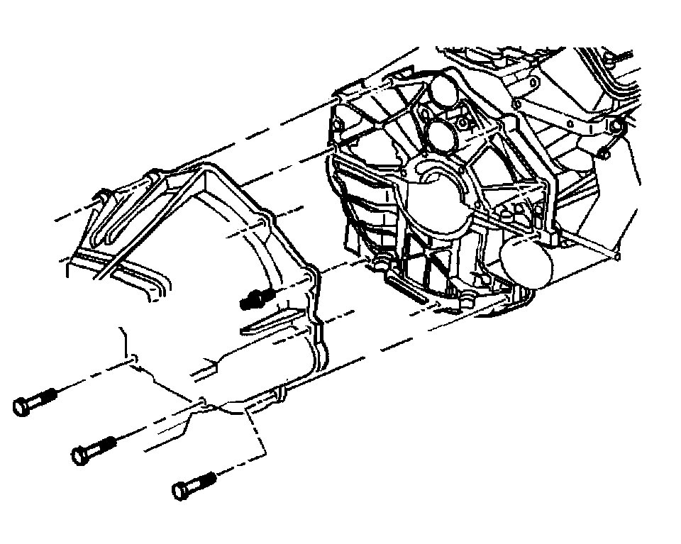

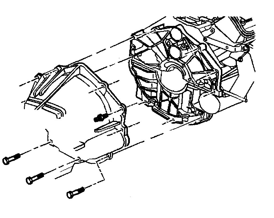

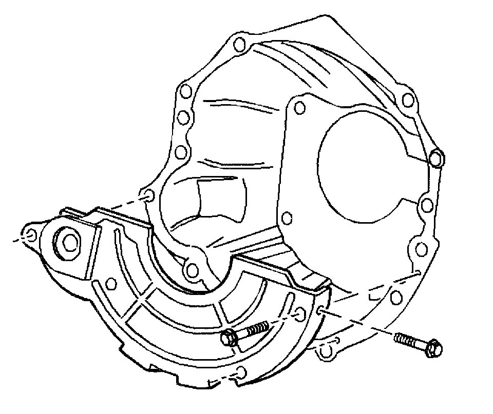

11. Remove the clutch housing cover.
12. Remove the transmission rear mount.
13. Support the transmission. Use a suitable safety stand.
14. Remove the frame crossmember. Refer to Rear Bumper Brace Replacement in Frame and Bumpers.
pic 7
15. Remove the transmission to the clutch housing bolts and studs.
