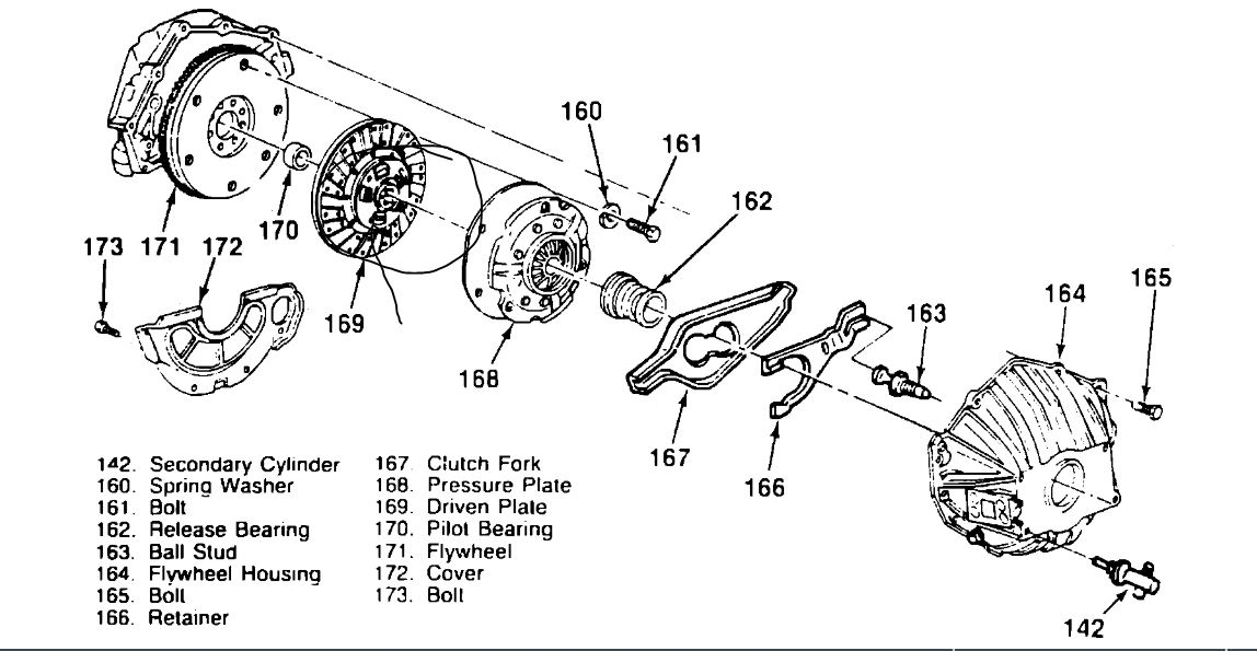

I just replaced the clutch and throw out bearing and now I got clutch pressure, but it is having a screeching sound and won’t go into gear and motor bogs down with clutch mashed.

Good afternoon,
When you installed the clutch disc, did you make sure you installed it correctly? If you put it in backward, it will doe this as the springs from the disc will hit the turning flywheel and make this noise.
I attached a picture for you. On the disc, there is a raised area on one side and flat on the other. The flat side goes against the flywheel.
