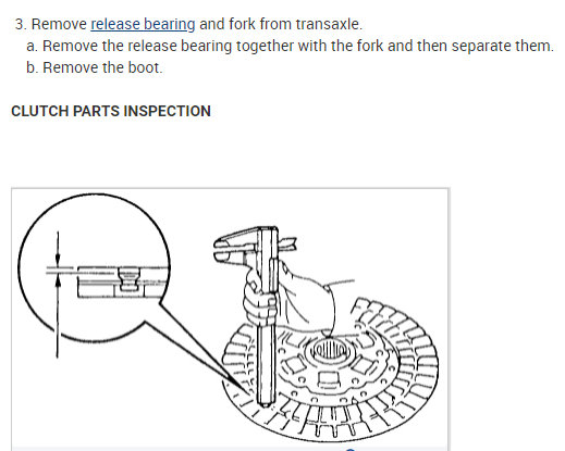

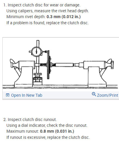

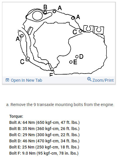

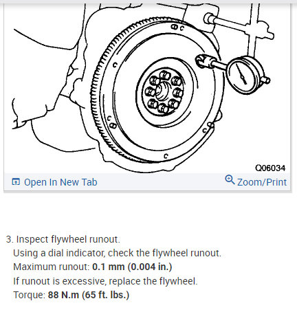

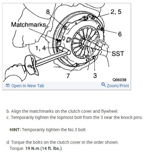

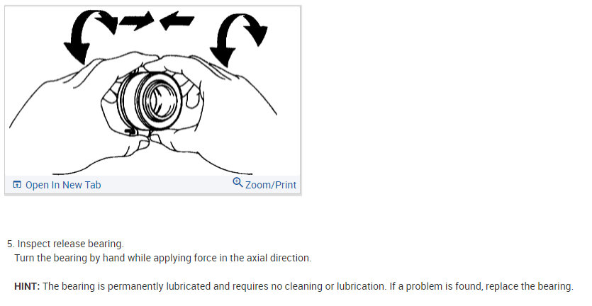

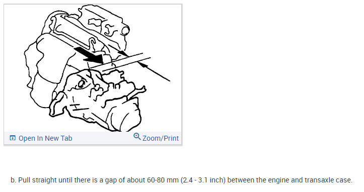

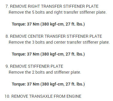

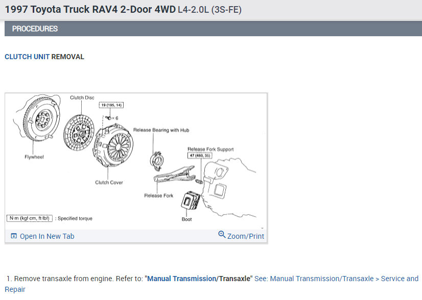

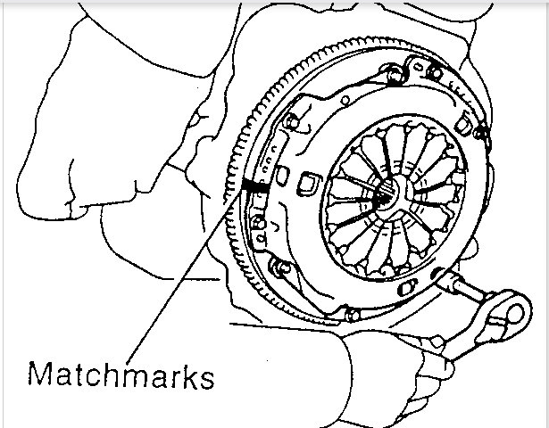

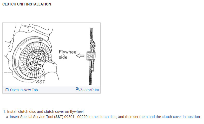

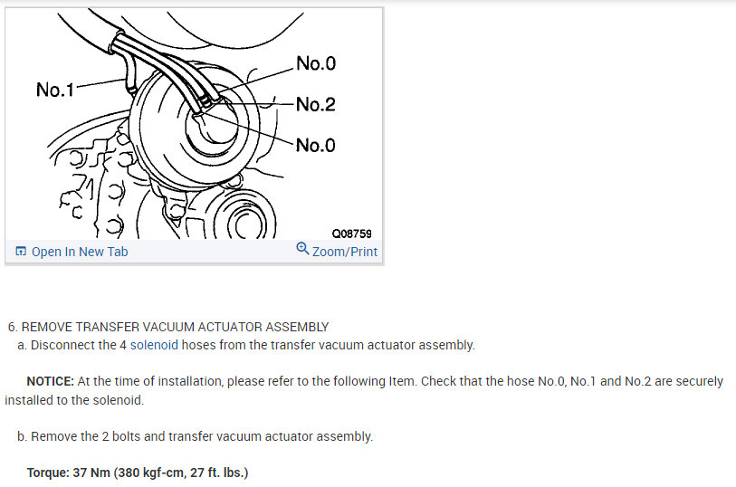

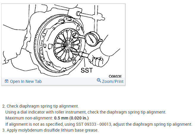

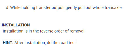

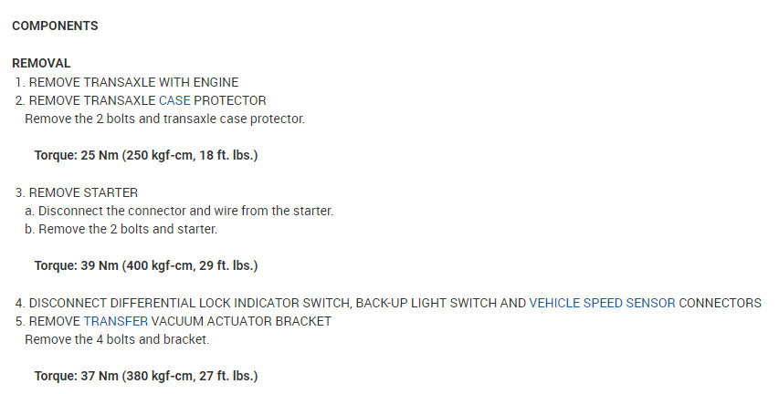

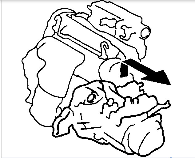

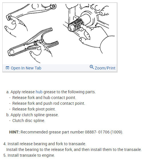

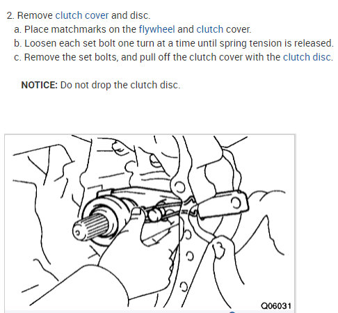

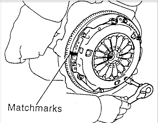

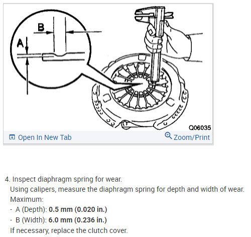

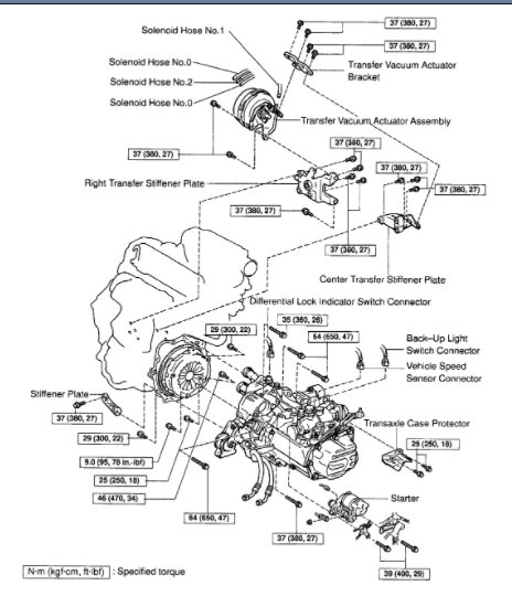

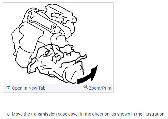

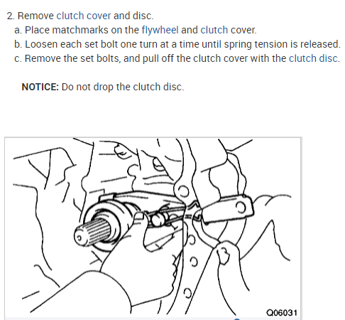

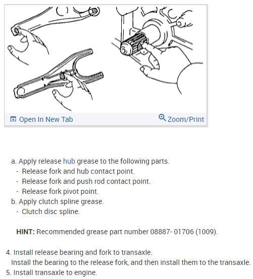

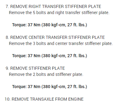

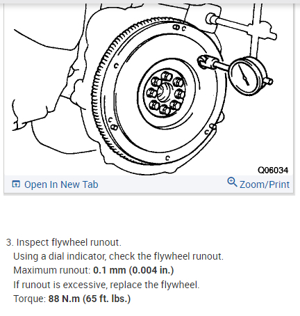

I've attached picture steps below showing how to remove and install the transmission and clutch on your vehicle. Hope this helps and thanks for using 2CarPros.
