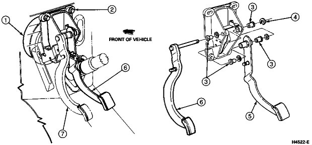

The clutch sticks to floor at times, or after depressing clutch it slowly returns to the up position when taking foot off pedal. Other times it works fine. Brake pedal sometimes has the same problem returning to top position after foot is removed. Any solutions?

Hi and thanks for using 2CarPros.com. Based on the mileage and since it happens to both pedals, I suspect the pedal bushings are worm. They are located where the pedals attach under the dash. Here are the directions for replacing them specific to your vehicle. NOTE: the item numbers correlate with the picture I have attached. I feel if you inspect item 3, you will find it to be worn and causing drag.
Item Part Number Description
1. Brake Booster
2. 353574-S36M Washer
3. 2461 Brake and Clutch Pedal Bushing
4. 97414-S Retaining Ring
5. 2455 Brake Pedal
6. 519 Clutch Pedal
