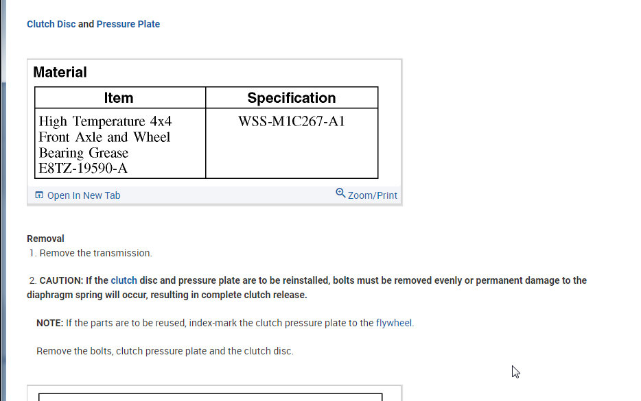

I have a hard time shifting into 1st and 2nd gear
2008 FORD RANGER
147,000 MILES • 4.0L • 6 CYL • 4WD • MANUAL
CAMDRISKILL
When I drive over 40 miles I have a hard time shifting into 1st and 2nd gear. You can hear a loud bang when it goes into gear. It doesn't do it on short trips below 40 miles.
Apr 19, 2021 at 11:06 AM
Sounds like you need a clutch. What happens is when the clutch and fluid heat up they stop operating properly and the clutch doesn't completely disengage which makes it had to shift.
Here are a lot of guides on this:
https://www.2carpros.com/articles/clutch-symptoms
https://www.2carpros.com/articles/clutch-doesnt-work-sometimes-or-not-at-all
https://www.2carpros.com/articles/how-to-replace-a-clutch
https://www.2carpros.com/articles/throw-out-bearing-replacement
https://www.2carpros.com/articles/pilot-bearing-replacement

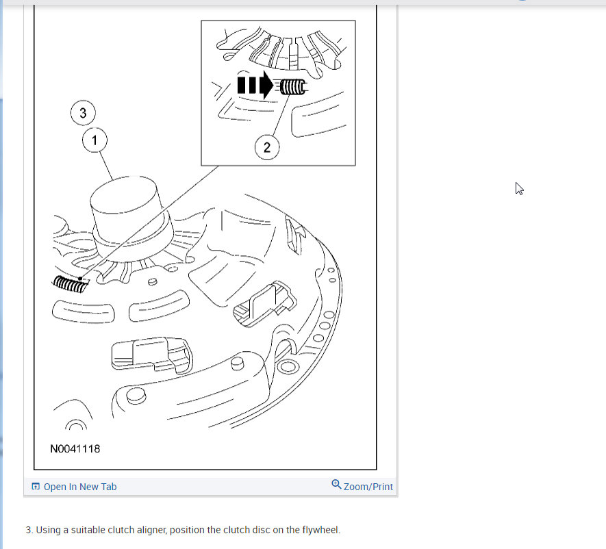

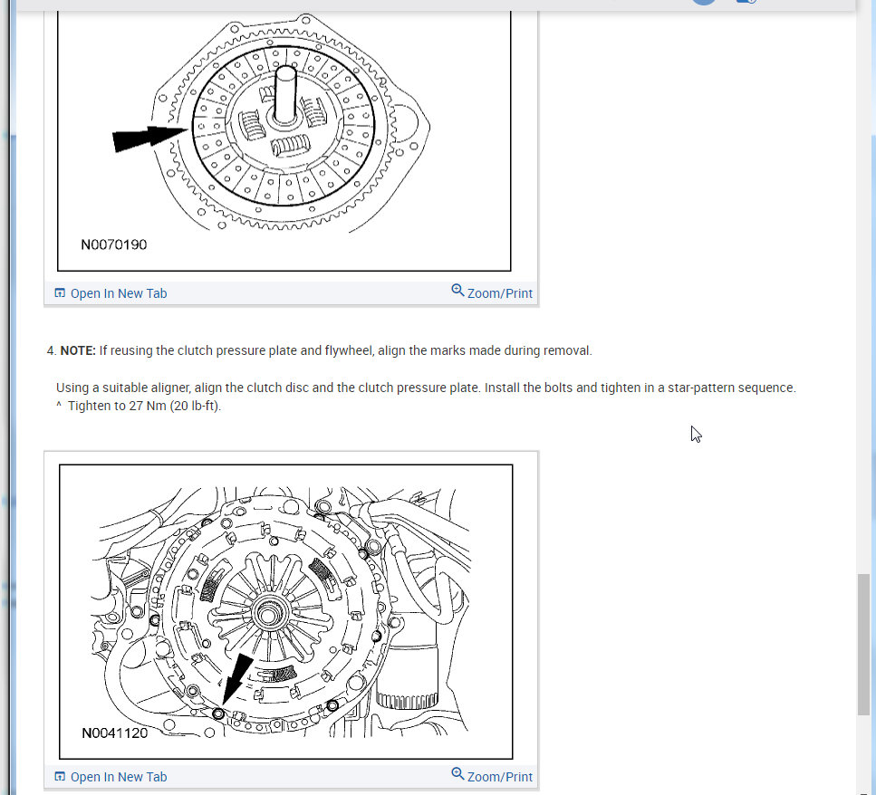

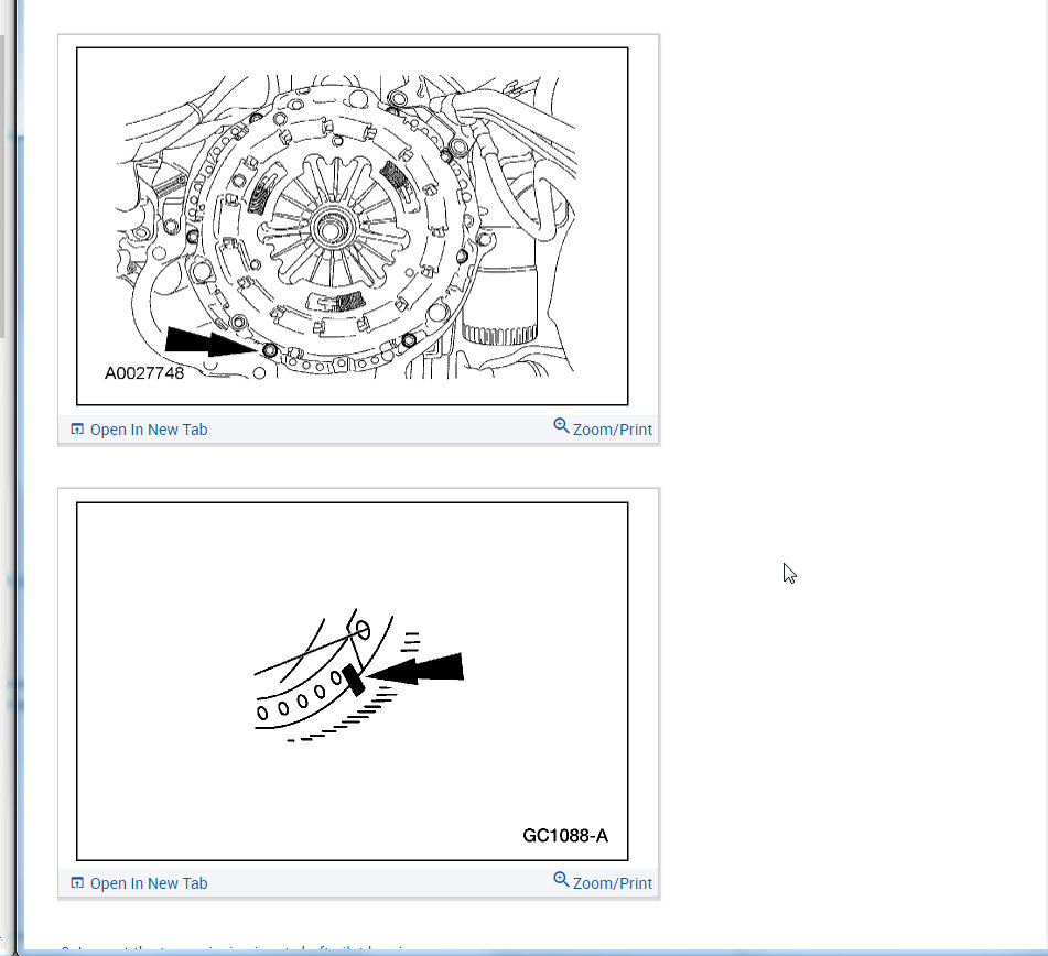

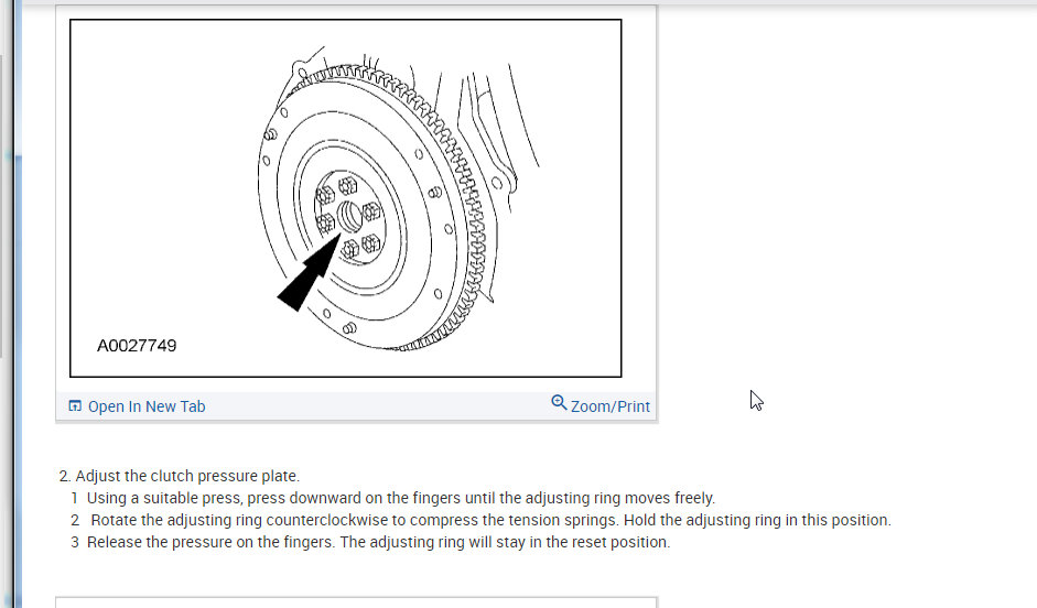

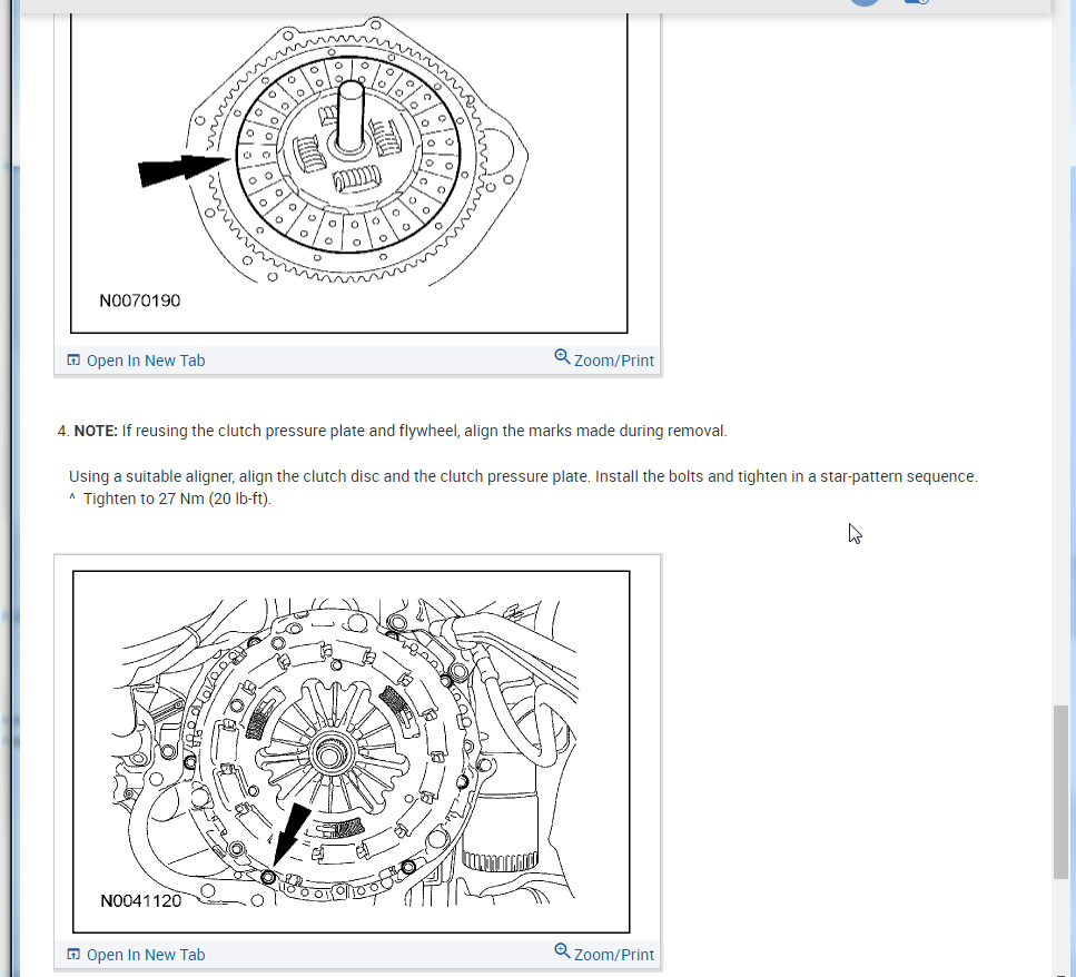

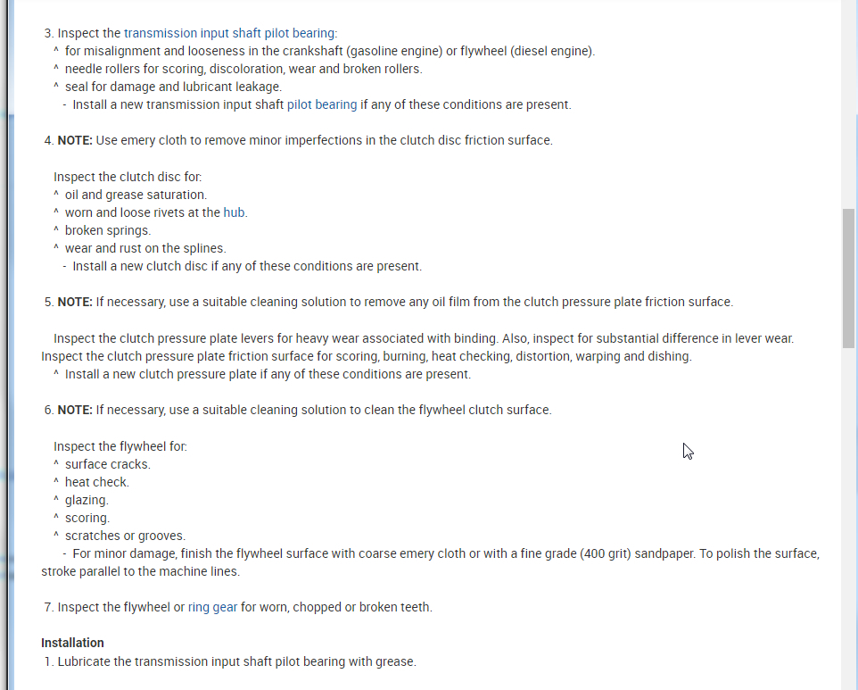

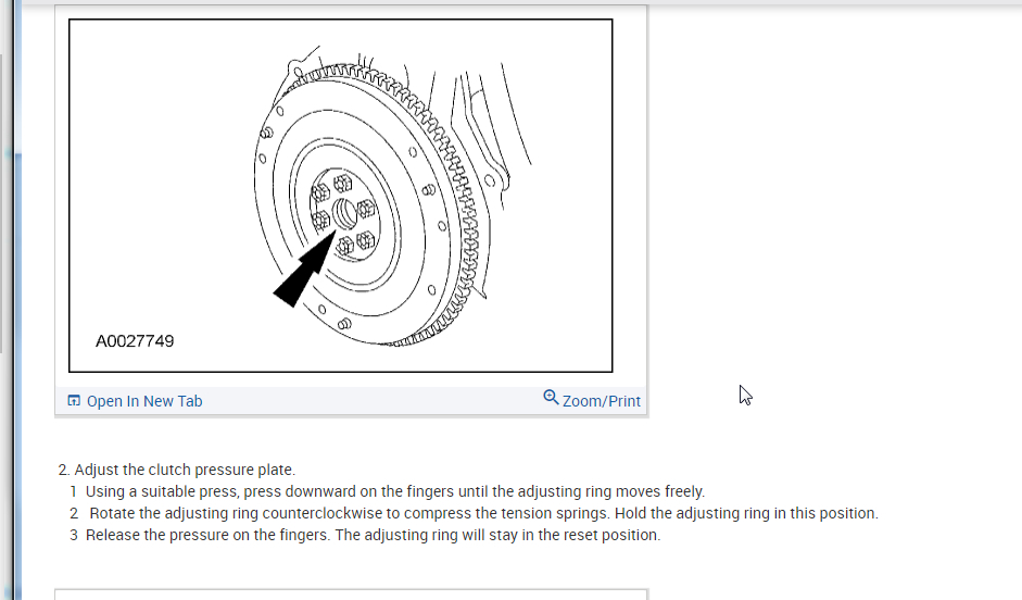

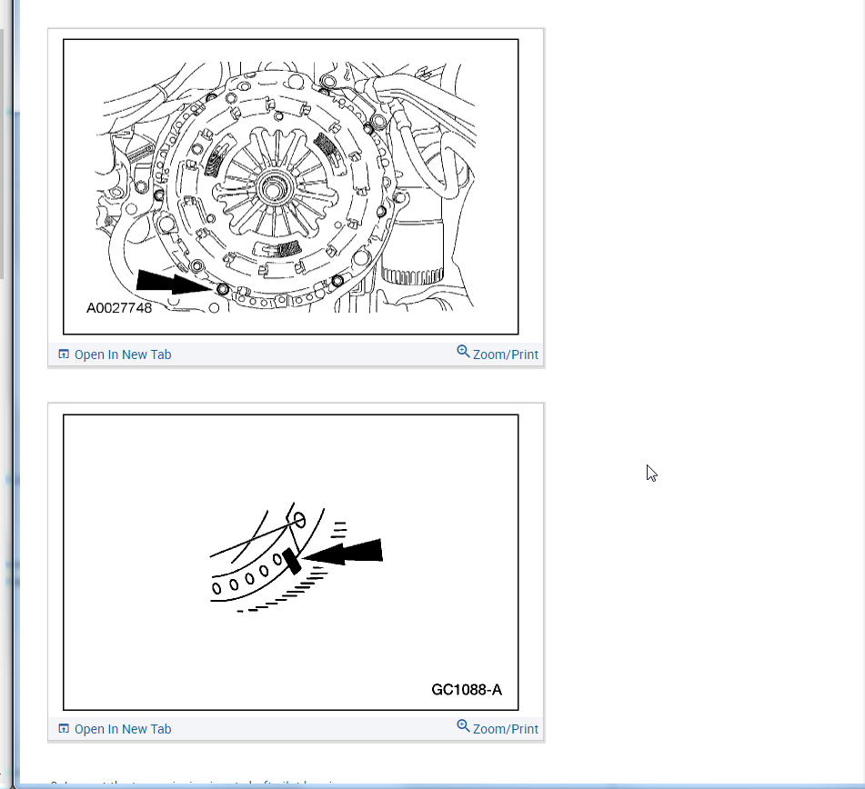

Plus below is the process on how to replace the disc from the manual.
I would replace the entire system including the slave cylinder, pressure plate, and disc.
Please let us know if you have other questions about this and we can go from there.
