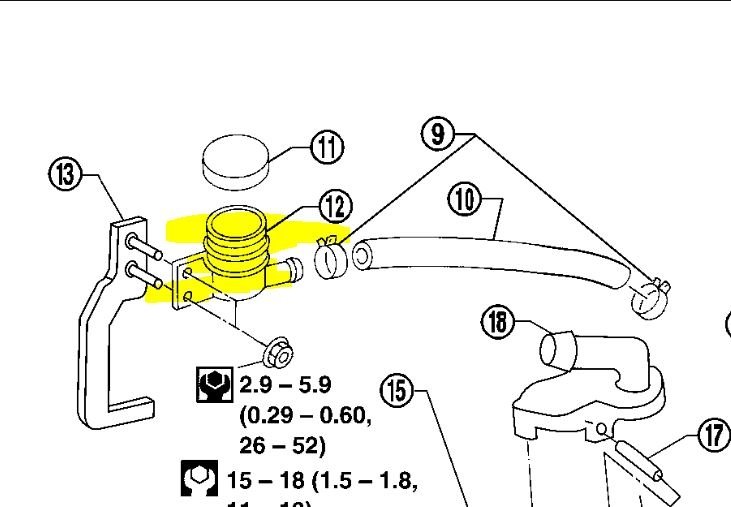

I woke up one morning and got in the car and the clutch pedal was going all the way to the floor almost with very little resistance. I drove it home from the place I was at and by the time I got there the pedal was sticking to the floor and the car wouldn’t go into gear. What could it be ?

The clutch on this vehicle is hydraulically operated. So, chances are either the clutch master cylinder or slave cylinder has failed. This guide can help
https://www.2carpros.com/articles/clutch-doesnt-work-sometimes-or-not-at-all
The first thing I need you to do is open the hood and on the driver's side of the firewall will be a clutch fluid reservoir. I need you to check if it is full. I attached a picture of what it looks like. If it is low or empty, refill it with dot 3 brake fluid and see if that changes anything. Also, check for anything that appears to be wet from brake fluid. That could tell us if there is a leak.
Do this and let me know what you find.
