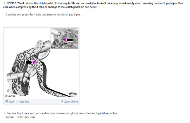

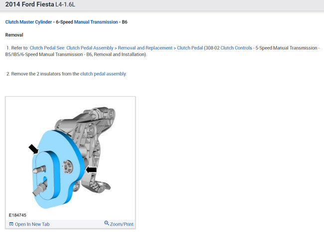

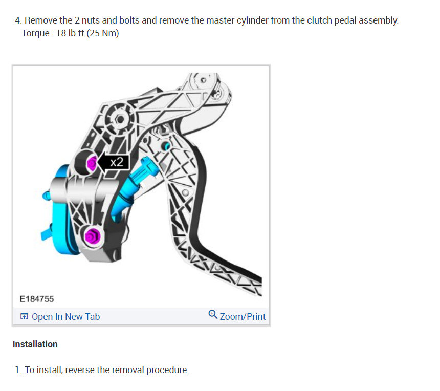

Clutch goes spongy and won’t shift to any gear after five minutes driving it. In the morning when I come to stop and stationed. After five minutes of not going into gear and clutch spongy and engine switched off or will go into gear and then fine.
Mar 30, 2021 at 4:30 PM
  • 55,694 POSTS
This sounds like you have a clutch disc that is falling apart or the clutch master is bad. To be sure this video will help us see what's going on. I have also included how to change out the clutch master.
https://youtu.be/EpBMj5ZY_bo
and
https://www.2carpros.com/articles/clutch-doesnt-work-sometimes-or-not-at-all
