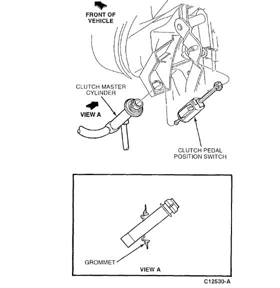

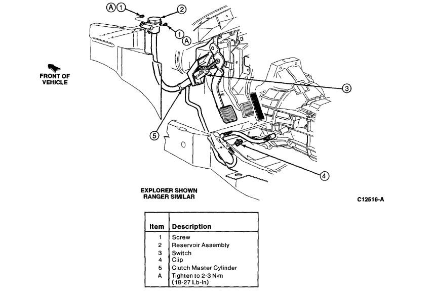

Clutch pedal will not go down even when I open bleeder valve.
237,000 MILES • 2.3L • 4 CYL • 2WD • MANUAL
DIANA SIMMERING
Dec 25, 2018 at 2:22 AM
Good morning,
It sounds like the clutch master cylinder is locked up.
Procedure
Removal
1. Disconnect the clutch master cylinder push rod from the clutch pedal (7519) by prying the retainer bushing and push rod off the clutch pedal pin.
Clutch Pedal Position Switch
2. Remove the clutch pedal position switch (CPP)(11A152) from the clutch master cylinder (7A543). Refer to Starting System - Clutch Switch.
3. Remove clutch master cylinder reservoir screw from the inner fender panel.
4. Uncouple the line from the clutch slave cylinder. See: Clutch Slave Cylinder > Procedures > Clutch Slave Cylinder to Clutch Master Cylinder Tube
5. Disconnect line from the mounting clips.
6. Twist the clutch master cylinder 1/8 turn counterclockwise as viewed from the driver's position, while pushing inward toward the driver's position. The rubber dash boot is removed with the master cylinder.
