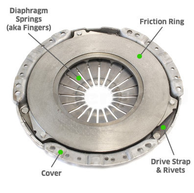

Light spongy clutch
2008 VAUXHALL ZAFIRA
124,000 MILES • 1.6L • MANUAL
DB5
Had new clutch and gearbox fitted 4 months ago. No leaks. What can it be?
May 12, 2021 at 4:48 AM
BORIS K
  • 836 POSTS
It sounds like you may have a problem with the pressure plate of the clutch assembly.
Do you feel any difference in the clutch bite point? Perhaps the clutch is taking further down on the clutch pedal travel?
Possible that the fingers(springs) or diaphragm on the clutch pressure plate have become soft and have sagged. See picture attached
