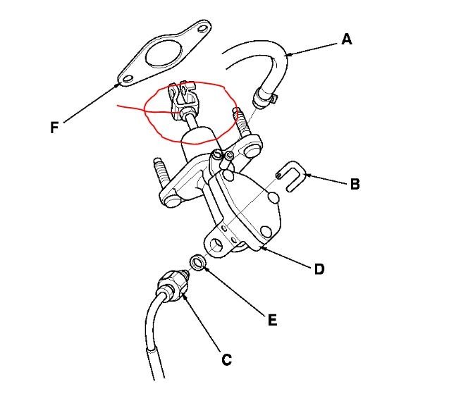

I attached a picture of the rod for the clutch master. There is a nut on the rod to the adapter for the pedal. You can loosen the nut and turn the rod to change the release and engagement time of the clutch.

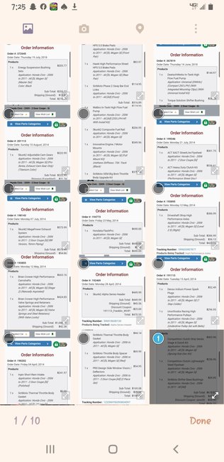

The clutch is only a month old and it would catch when you barely got it off the floor. Now it lets out all the way and when i start it i have to put force pushing it all the way to the floor to get it to start. I have replaced the throw out bearing twice with in a week. I do not know anything about cars. I bought it as is and everything under the hood is after market and it is tuned with the Hondata. When i let my friend set the timing is when it started to do it. Here is a picture of some of the stuff that is aftermarket.
May 20, 2020 at 6:47 PM
SHERRYD300
Here it is:

I would have someone try the adjustment I suggested to see if it makes a difference.
