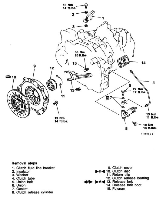

Here are the directions from Alldata for replacement. All attached pictures correlate with these directions.
______________________
REMOVAL AND INSTALLATION
REMOVAL SERVICE POINT

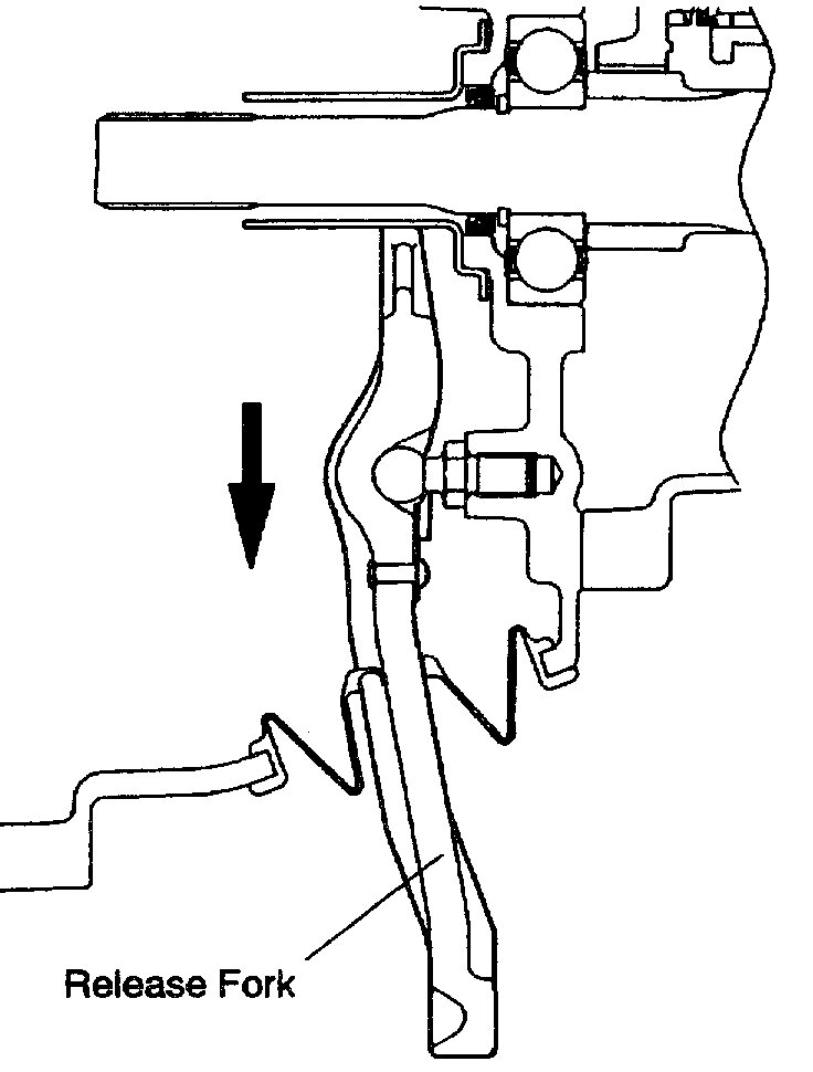

[A] RELEASE FORK REMOVAL
1. Move the release fork in the direction shown to remove the clip from the fulcrum.

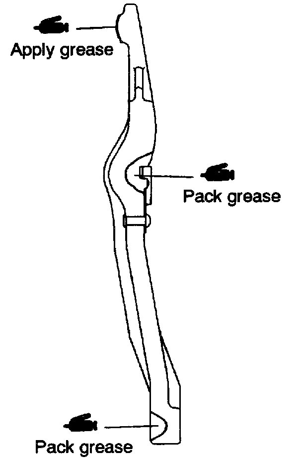

]A[ GREASE APPLICATION TO RELEASE FORK
Specified grease: MITSUBISHI genuine grease part No. 0101011 or equivalent

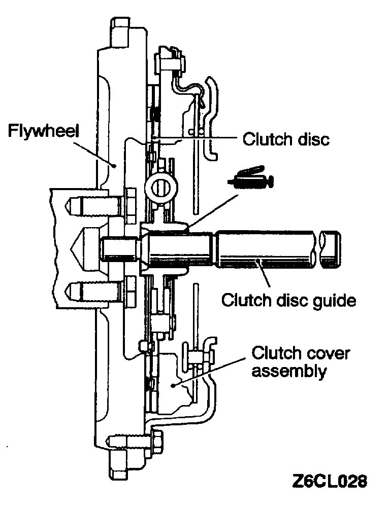

]B[ CLUTCH DISC INSTALLATION
1. Apply the specified grease to the clutch disc splines and rub it in the splines with a brush.
2. Using the clutch disc guide to position the clutch disc on the flywheel.

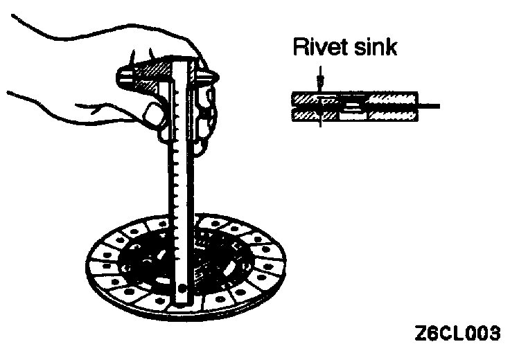

2. Measure the rivet sink and replace the clutch disc if it is out of specification.
Limit: 0.3 mm (0.012 inch)
