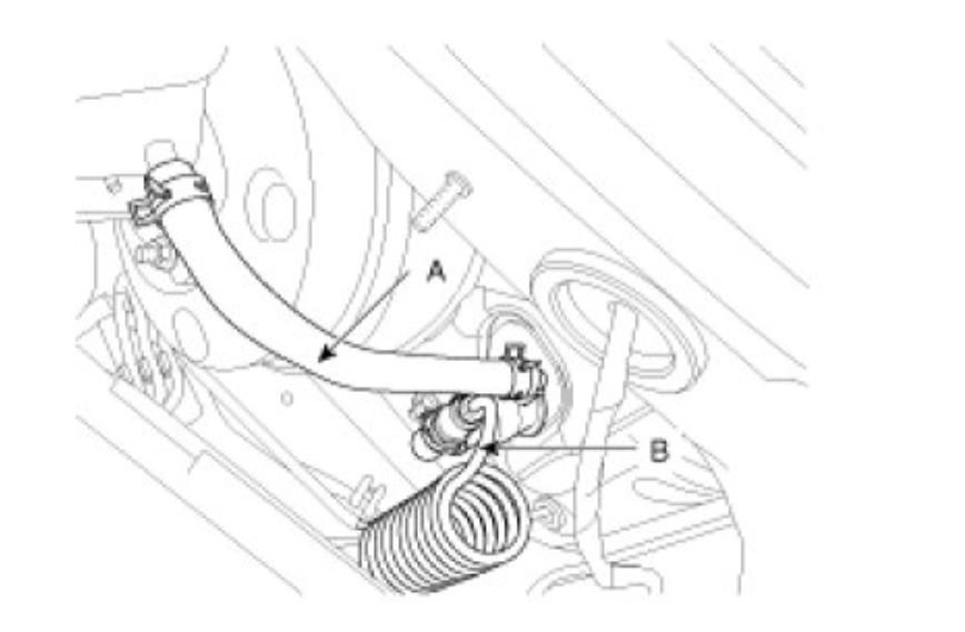

1. Remove the flexible hose (A) from the brake reserve tank.
imageZoom/Print
2. After pulling out a clip, disconnect the clutch tube (B) from the master cylinder.

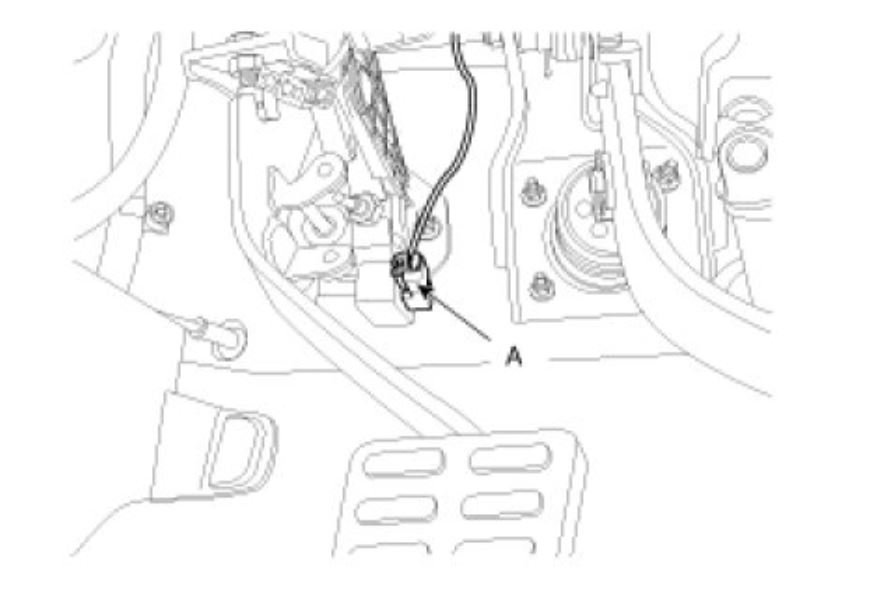

3. Disconnect the ignition lock switch connector (A).

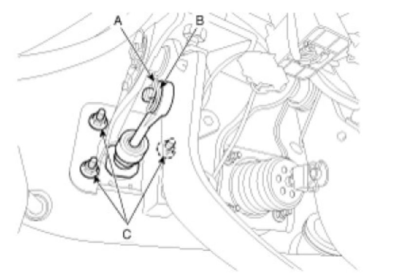

4. Remove the push rod from the clutch pedal by removing the snap pin (A) and washer (B).
imageZoom/Print
5. Remove the clutch pedal mounting nut (C-3ea).

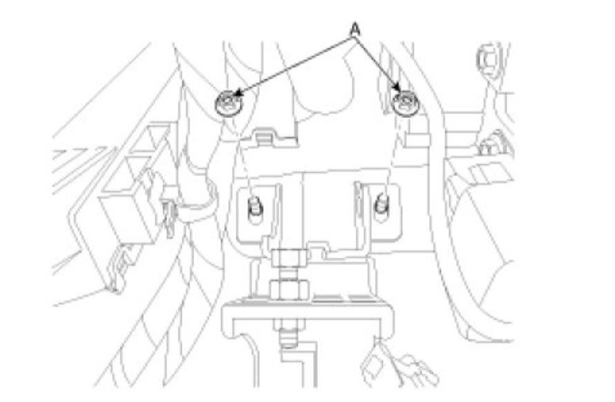

6. Remove the clutch pedal bracket mounting nut (A-2ea).

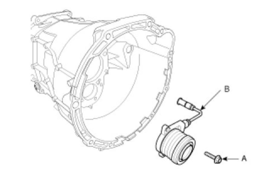

slave.
to replace the slave cylinder, the transmission must be removed.
Removal
1. Remove the transaxle assembly.
2. Remove the C.S.C assembly (B) from the transaxle case by removing bolts (A-3ea).
