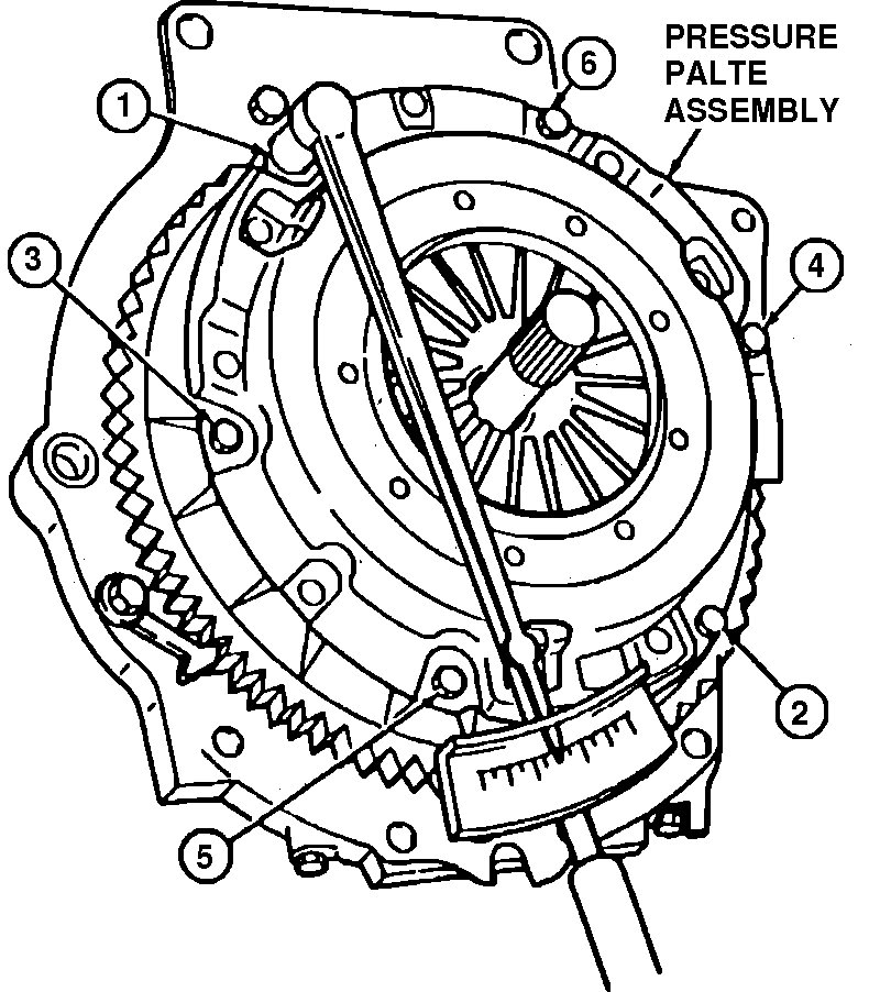

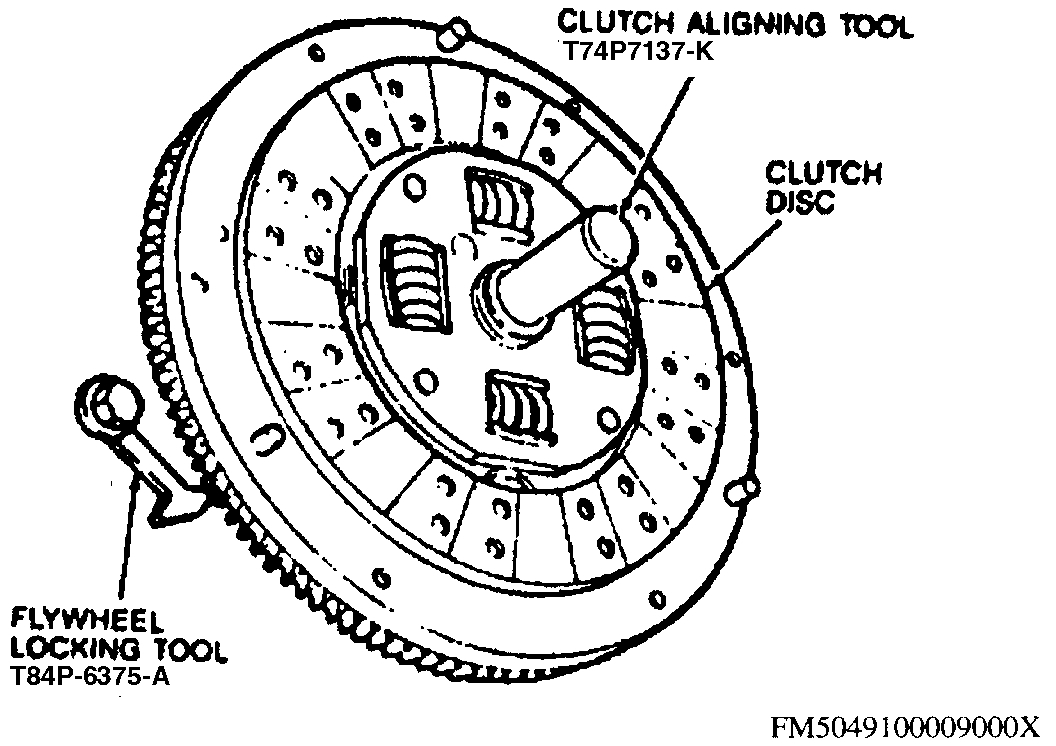

Here are the directions for removing and replacing the clutch. Take a look through them to confirm everything went together correctly.
REMOVAL AND INSTALLATION
REMOVAL
1. Remove transaxle.
2. Install Flywheel Locking tool No. T84P-6375-A or equivalent in a transaxle mounting hole on engine block, then engage tooth of locking tool into flywheel ring gear.
3. Loosen pressure plate cover attaching bolts evenly to avoid distorting cover. If same pressure plate and cover are to be installed, mark cover and flywheel so pressure plate can be installed in original position.
4. Remove pressure plate and clutch disc from flywheel.
INSTALLATION
1. Reverse procedure to install, noting the following:
a. Clean splines on clutch disc and transaxle input shaft, then apply a small amount of Clutch Grease part No. C1AZ-19590-B or equivalent to clutch disc and input shaft splines. Avoid getting grease on clutch face.
b. Position clutch disc plate onto flywheel
c. Ensure three dowel pins on flywheel are aligned with dowel pins on pressure plate.
d. Finger tighten cover attaching bolts, then align clutch disc using tool No. T74P-7137-K or equivalent.
e. Evenly torque bolts to 13-20 ft lbs in sequence shown.
f. Remove alignment tool, then install transaxle and perform clutch bleed procedure.
________________________________________________
The first 2 pictures correlate with the removal and replacement directions.

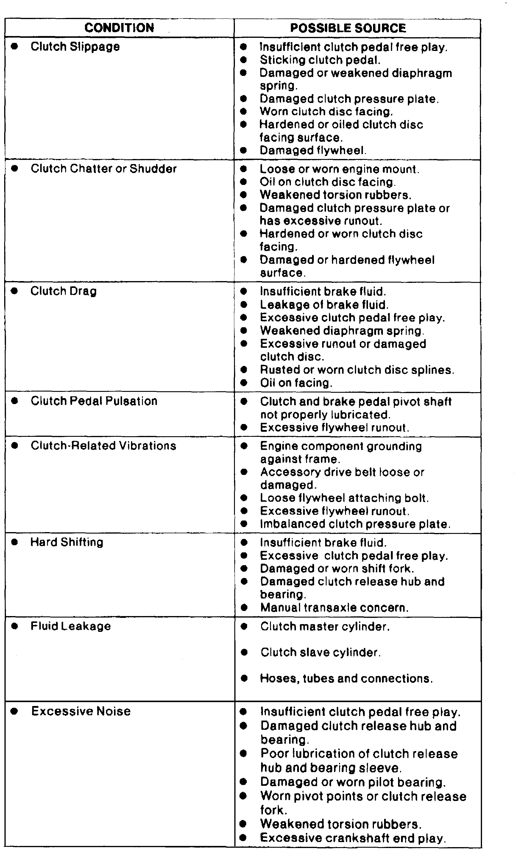

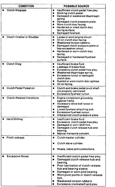

Picture 3 is a list of possible issues. When looking through it, focus on the hard shift issues. However, if that was not an issue prior, I do not think it is relevant.
Let me know what you find when looking through the directions or if you have other questions.
