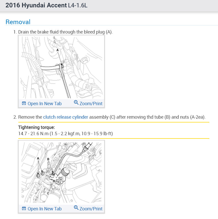

The clutch has become hard to press in and it takes 3 to 4 seconds to come back out.
Jul 7, 2023 at 1:07 AM
  • 55,399 POSTS

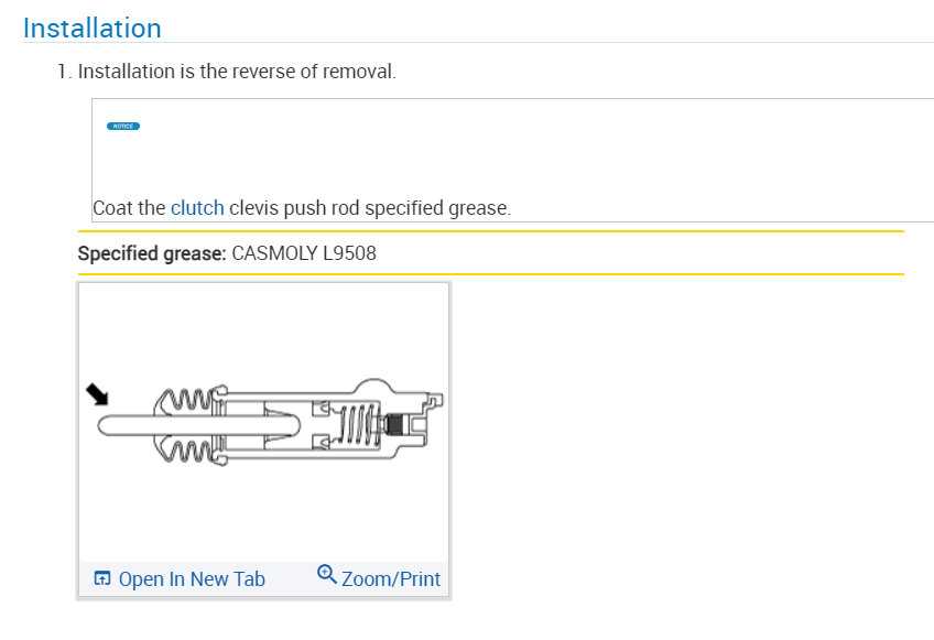

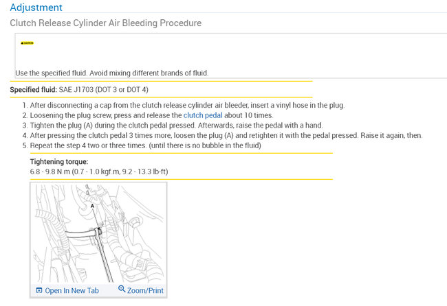

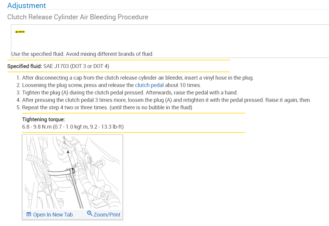

It sounds like the secondary cylinder is bad. Here is how the job is done on your car. Check out the images (below). Let us know what happens and please upload pictures or videos of the problem so we can see what's going on.
