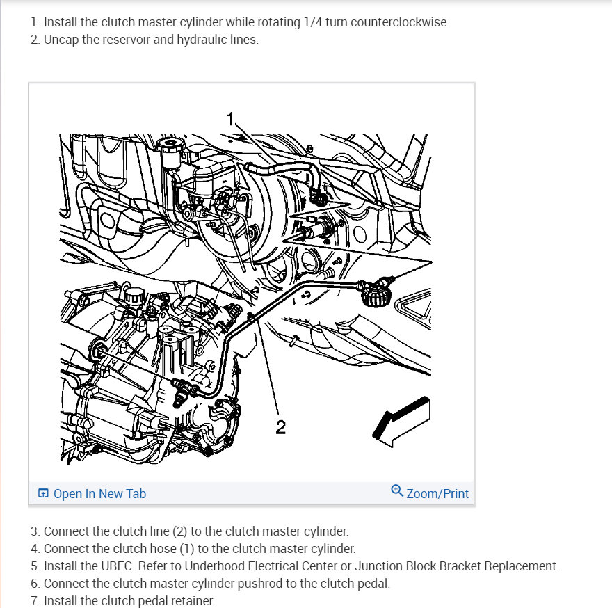

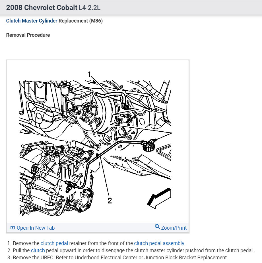

I didn't have any issues till I took off this morning and the clutch was to the floor. I had to repeatedly pump the clutch in order for it to build pressure to place it into gear. I am halfway home. I stopped to check the line. I had it replaced a year ago because it was leaking from the elbow where I can also bleed it. I don't see any leaks or wet spots. I checked the brake fluid. Maybe it may be clogged and need to bleed it? If not that, then replace the clutch elbow piece that comes from the brake fluid to the transmission.
Jul 1, 2022 at 11:07 PM
  • 55,647 POSTS

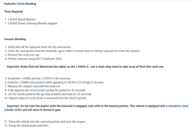

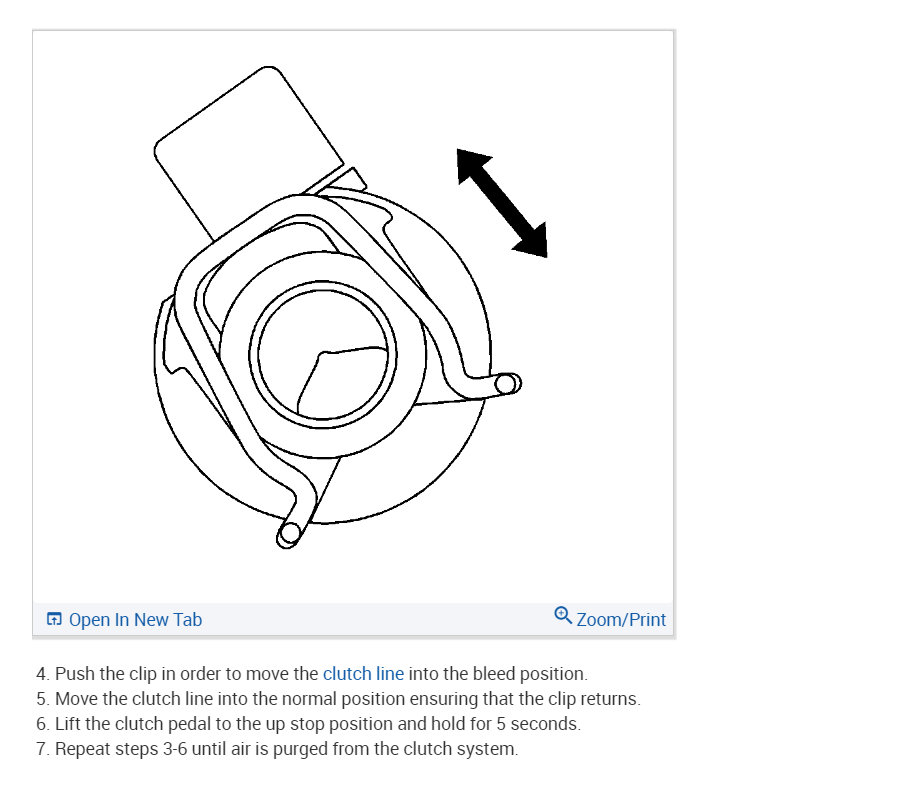

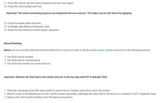

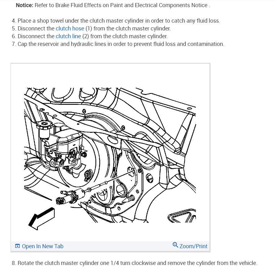

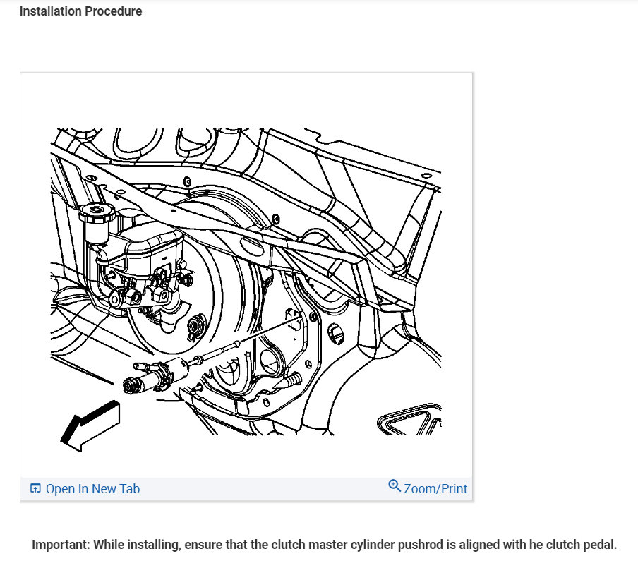

It sounds like the clutch master has gone bad. Here is how to change it out in the diagrams below. Check out the diagrams (below). Let us know what happens and please upload pictures or videos of the problem.
Jul 2, 2022 at 10:46 AM
