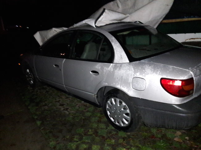

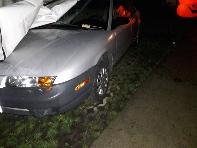

Here are a few. It is only four lug. Not five as the wheel caps indicate.

Looks like a SL1 if the. Front seat does not have a separate head rest that comes off the seat on two metal posts? So does the clutch pedal have pressure going all the way down? Or does it drop some then have pressure?
