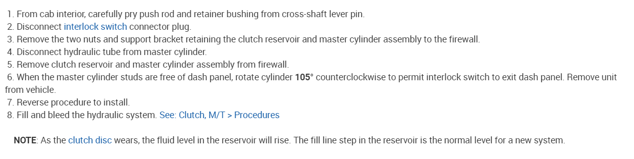

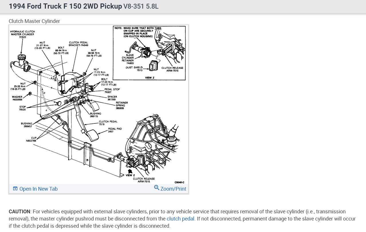

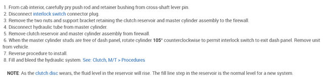

Okay, that sounds more like the clutch master cylinder is going out. here are diagrams and instructions on how to change it out. Check out the diagrams (below). Please let us know what happens.

That's what it sounds like to me as well. The seals are probably worn allowing the fluid the sneak past the piston. This is why the pumping of the clutch seems to work.
