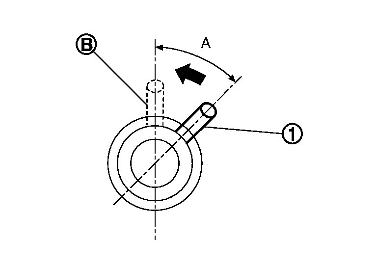

Clutch has no resistance and goes to bottom of floor when pressed.
Feb 7, 2019 at 12:34 PM
  • 110,194 POSTS

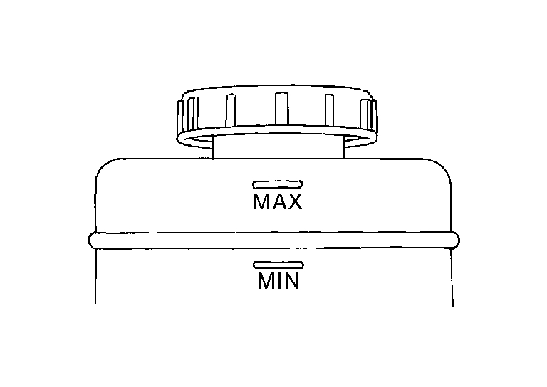

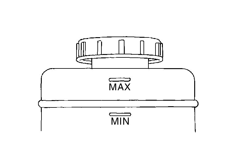

The clutch on this vehicle is hydraulic. First, confirm the clutch fluid under the hood in the reservoir is full. See picture 1
Also, take a look through this link":
https://www.2carpros.com/articles/clutch-doesnt-work-sometimes-or-not-at-all
Next, if it is low or empty, check for leaks between the clutch master cylinder (the clutch pedal attaches to this) and what is called the slave cylinder which is mounted at the transmission.
If you see no leaks and the fluid is full, either the clutch master cylinder is bad or the slave cylinder.
The easiest way to check which one is by opening the bleeder on the slave and depressing the clutch pedal. A strong flow of fluid should shoot out. If it is weak or does nothing but drain, replace the clutch master cylinder. Here are directions for that, The attached pictures correlate with these directions.

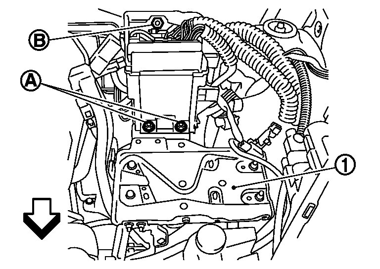

2.Remove IPDM E/R bracket bolts (A) and nut (B).
White arrow indicates : Front
3.Remove IPDM E/R bracket (1).

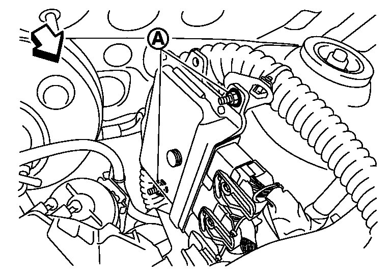

4.Remove ECM bracket nuts (A).

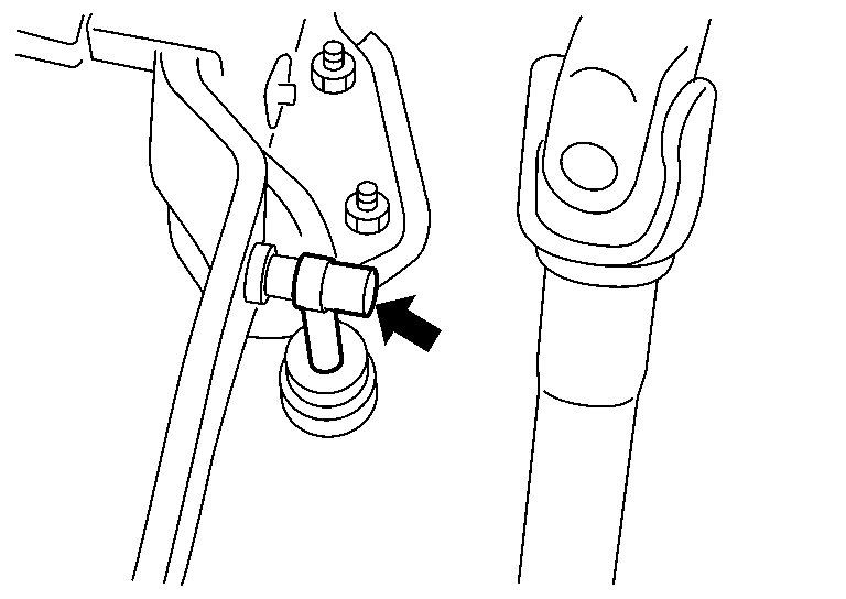

Picture 4
5.Remove master cylinder rod end (Black arrow) from clutch pedal.
6.Use one of the following methods to remove hose from master cylinder.
- Drain clutch fluid from reservoir tank and remove hose. Refer to "Draining" See: Clutch Fluid > Procedures > Draining.
- Remove hose from master cylinder.
Picture 5

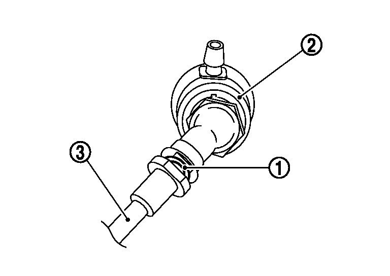

7.Pull up the lock pin (1) from connector of master cylinder (2) and separate clutch tube (3).
8.Rotate master cylinder clockwise by 45 degrees and then remove master cylinder from the vehicle.

Picture 6
1.With the nipple (1) rotated clockwise by 45 degrees, insert clutch master cylinder into the mounting hole. Rotate the clutch master cylinder counterclockwise by 45 degrees (A) as shown to secure it. At this time, nipple is in the upward (B).

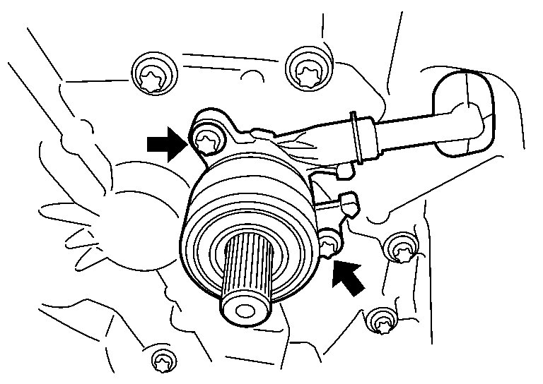

Picture 7
2.Remove CSC bolts and the CSC from clutch housing.
