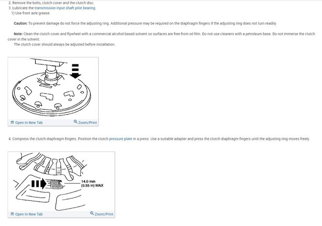

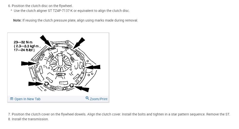

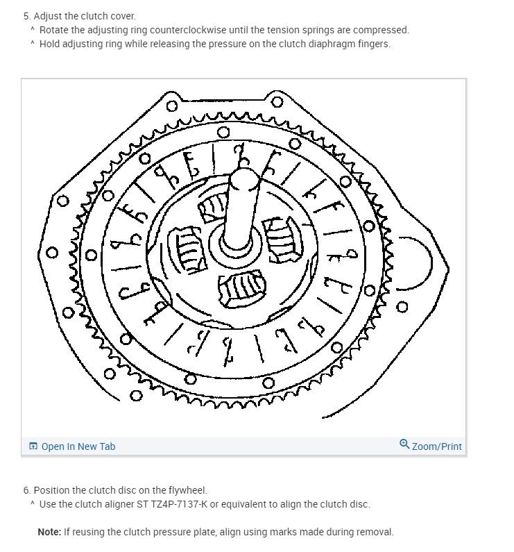

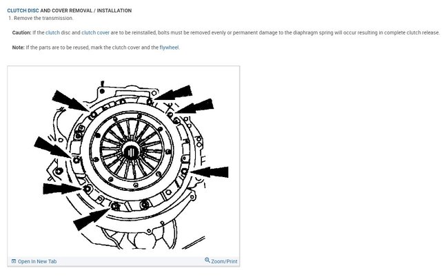

Good morning,
When you have it in gear and let the clutch out, does the engine rev up normally?
https://www.2carpros.com/articles/how-to-replace-a-clutch
https://www.2carpros.com/articles/clutch-symptoms
If it does, it is the clutch that is slipping.
