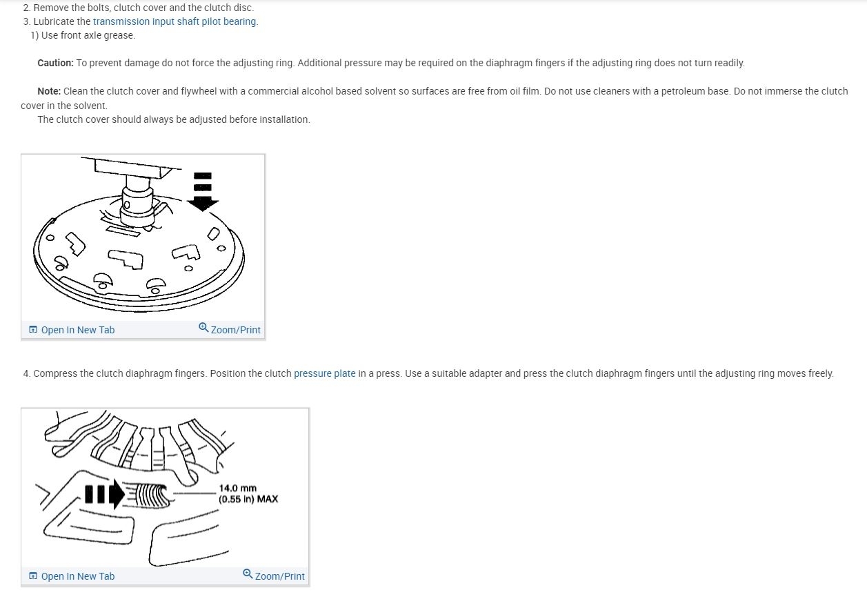

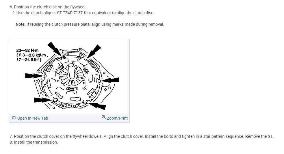

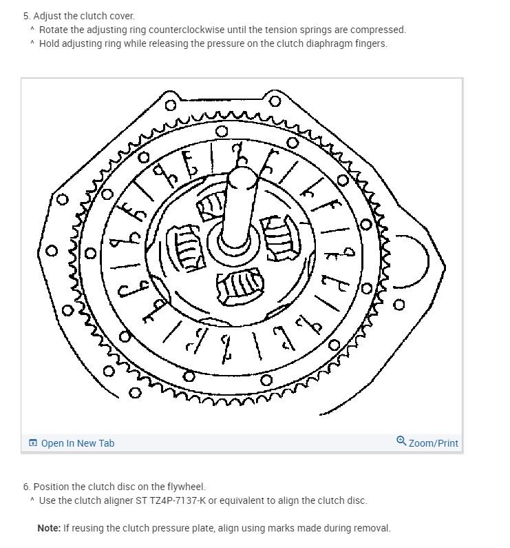

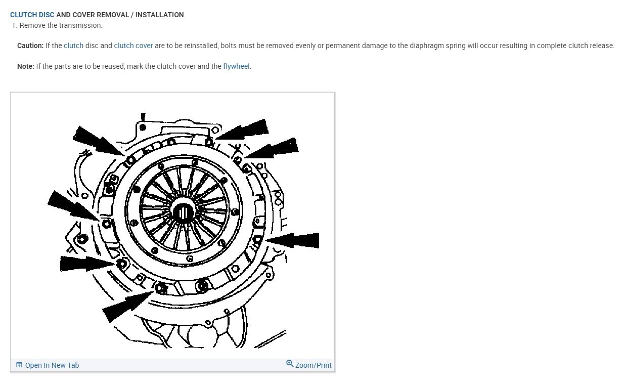

My boyfriend was driving the truck and it just stopped accelerating and had to pull over and it was towed home. it will start right up, and it will shift into a gear, and it does not move or rev up at all not even reverse. Help please, any advice welcome.
Feb 21, 2022 at 1:21 AM
Good morning,
When you have it in gear and let the clutch out, does the engine rev up normally?
https://www.2carpros.com/articles/how-to-replace-a-clutch
https://www.2carpros.com/articles/clutch-symptoms
If it does, it is the clutch that is slipping.
