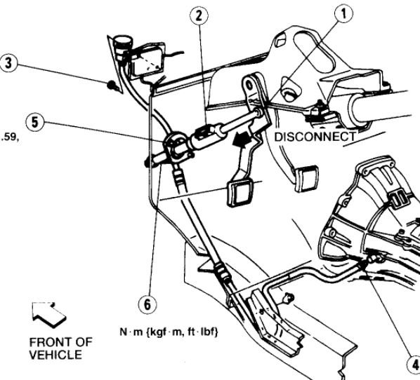

When I push "disengage" clutch moves through gears easily, as I let it out it slips and will only accelerate slowly or slip more. Is there any things to try before I have to remove transmission? Clutch, line and master cylinder was replaced a year ago, before I bought the truck. Soon after l replaced the fluid line that had worn a hole in it by being routed improperly. I don't know about pressure plate, slave, or flywheel. Pedal feels okay, not spongy but not trying to roll until almost all the way up. bled line from master to slave bleed port. Nothing changed, but didn't separate line or bench bleed line? what do you think?

It sounds like you most likely have a worn clutch, the hydraulic system needing bled would not directly cause the clutch to slip, it would have to be some sort of mechanical issue not allowing the throw-out bearing to completely disengage and therefore wearing the clutch disk prematurely. One thing to check is if you have any play at the top of the clutch pedal travel, if you don't that would lead me to believe that something has happened not allowing the slave cylinder to fully release the throw-out bearing.
Unfortunately the only thing I can think of that could possibly cause your clutch to slip that wouldn't involve removing the transmission would be the clutch pedal itself not allowing the throw-out bearing to fully disengage from the pressure plate. if you have some play when the clutch pedal it at the top of it's travel then you are left with the only option being to remove the transmission to repair the problem since you have to remove it to even to replace the slave cylinder. I have attached a diagram on the clutch pedal system, if your pedal is holding the slave cylinder from releasing when you when you remove the linkage from your pedal (1) it will not line back up without pushing it in.
If you have to remove it I would highly recommend replacing everything including the slave cylinder and having the flywheel surfaced at a machine shop. I have been finding a lot of my parts at surprisingly good prices and quality on Amazon so I would look there for good deals on what you need.
