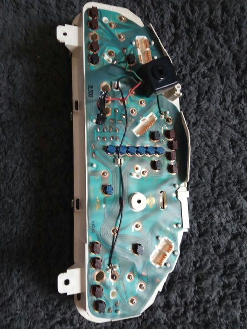

Suddenly the gauges for the tachometer, odometer, temperature, gas, stopped working. then it started acting very weird like when ever there is a bump they start jumping then going back to zero. that happens also if i hit the cluster at the dashboard area i mean gently by hand. i found out that this happens when the temperature is really hot outside and even the small screen showing the mileage. i have the car for more than a year and half and this is the first time i see this happening to me.

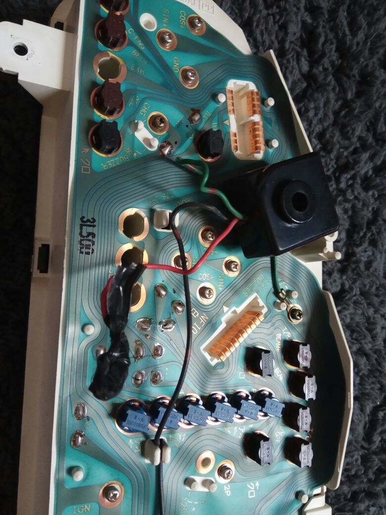

i took the cluster out and i found something strange which i believe the previous owner has made and you can see the red wire in the attached photo is not connected he has somehow disabled that, but i do not know what does this mean.
Please help me with suggestions and if the red wire should be connected where should it be connected to.

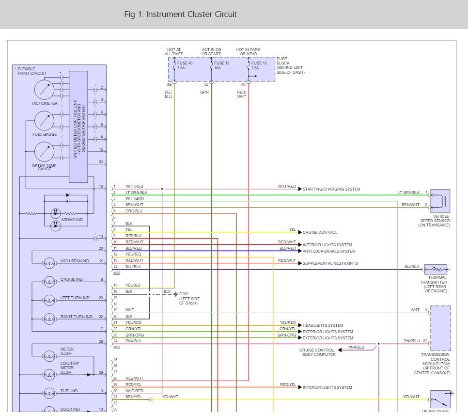

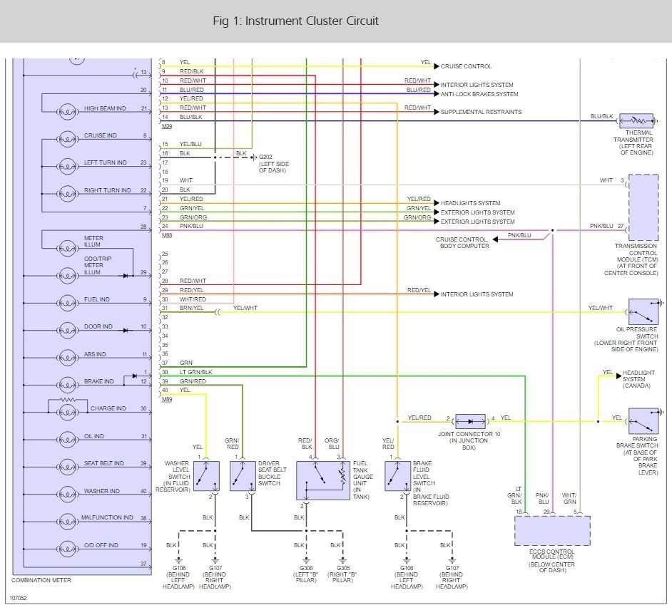

It sounds like you have a bad connection which shorts out when warm which is what they do. Test for power and the harness connectors and check the ground as well. I do not know what that box is but it looks factory so make sure the connections are good. Here is a wiring diagram and a guide to help you with the testing.
Please run some tests and get back to us so we can continue helping you.

Symptom indicates a bad ground circuit to be a more likely cause of the problem. Have the ground circuits checked. It could also be a loose connector and I would suggest removing the meter cluster to check them.
