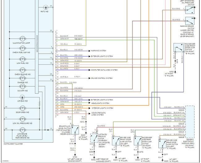

Can I get the cluster wiring diagrams?
2006 FORD BANTAM
200,609 MILES • 1.3L • 4 CYL • 2WD • AUTOMATIC
SKHUMBUZO KONDOWE
Good day,
I want to change my cluster to the new Ford bantam Facelift 2011 model but the wiring on the Hannes seems to be different on the pin or plug or is it the cluster itself...Can you please help with the diagram?
Dec 19, 2023 at 1:23 AM
  • 55,423 POSTS

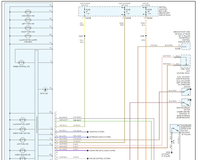

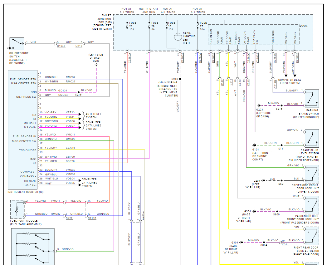

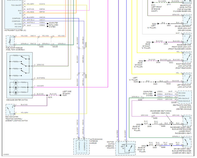

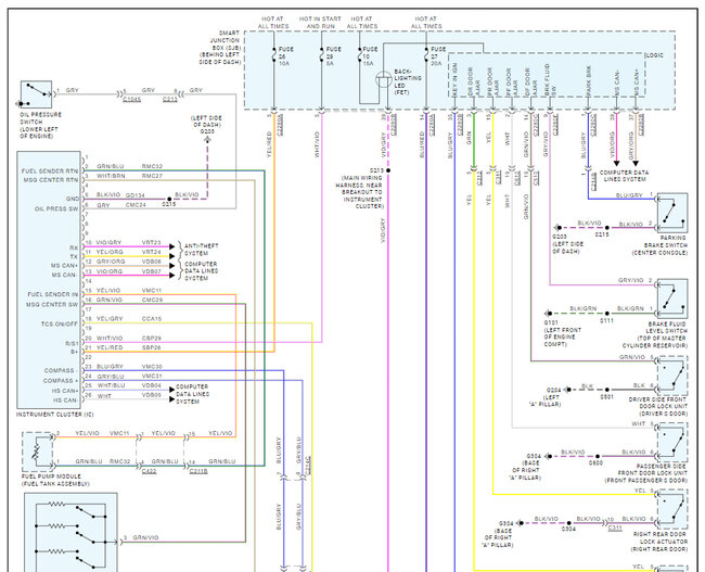

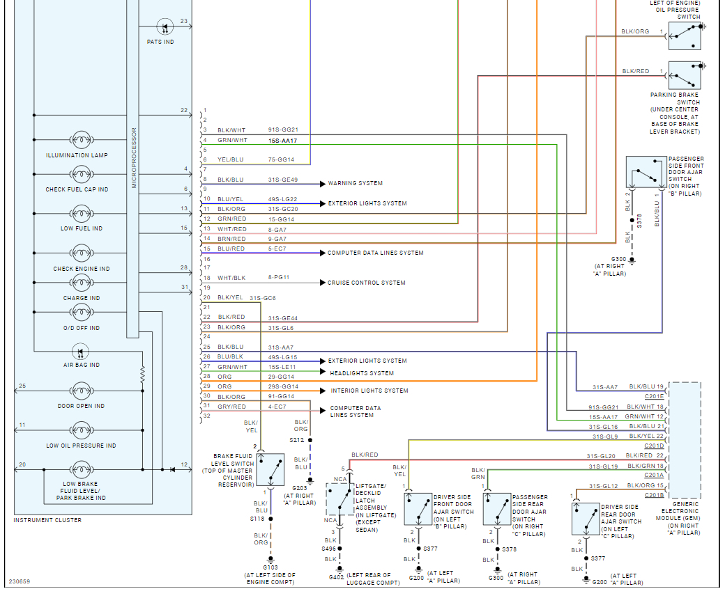

Here are both cluster wiring diagrams so you can install the newer instrument cluster. This guide may help you be able to test the connection which the wiring is completed.
Check out the images (below). Let us know if you need anything else.
Dec 19, 2023 at 5:38 AM
SKHUMBUZO KONDOWE
Got it Sir... but my problem is the cluster coding on the pinout I don't which wire needs do go on were on the cluster may you please send the dash pinout cording perhaps
Dec 20, 2023 at 3:28 AM (Merged)
  • 55,423 POSTS
Sorry we don't have those.
